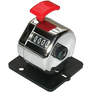

« Reply #6 on: January 13, 2013, 03:48:06 pm »
One other way is to build a cam and use one of this
