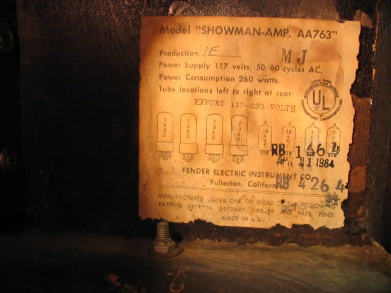

here's the tube chart in my Blonde AA763 BF Showman w/7355's:
A couple of pics showing the output tubes:
Amp has unique PT and OT-----i can get p/n's later if anybody cares----- other than the 7355's, PT, and OT it is an AA763 Fender circuit.
Every BF AB763 Showman (w/6l6GC) I've owned has sounded stronger, deeper, and richer than this 7355 amp---- i have a Blonde AA763 Bandmaster (w/6L6GC) that is close to the performance to the 7355 Showman---yes, I've tried different 7355's.
An oddball Fender amp----- probably discontinued because they didn't sound as good in real life as they would have seemed to sound by the 7355 specs------my opinion only on this..........................gldtp99

would you kindly consider to post the transformer part numbers and date codes?
the OT and PT look to be the same sizes as the 6L6 variant.
--DL

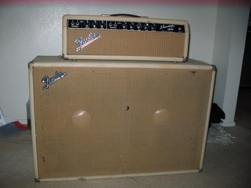

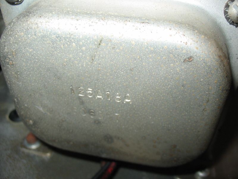

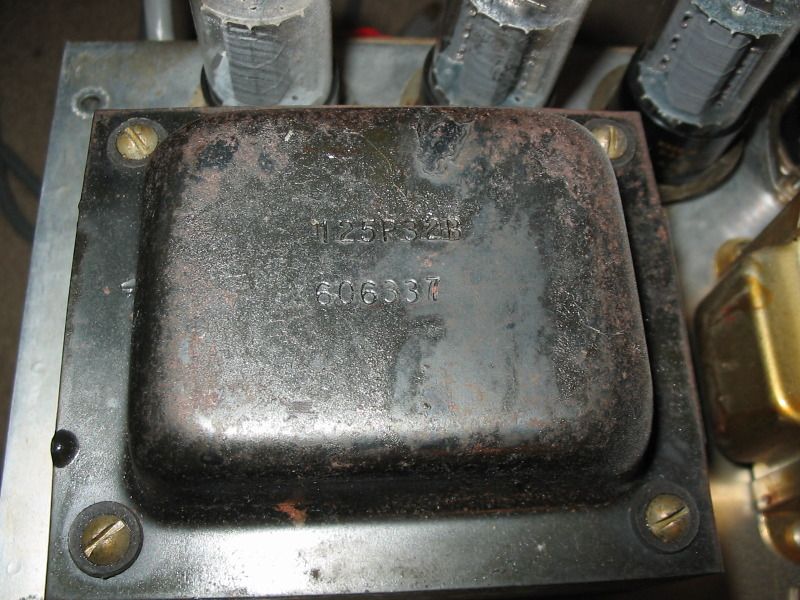

i pulled the 7355 Showman out, cracked it open, and took iron pics:
PT: 125P32B/606337
OT: 125A18A/606307
This is an Export amp with 117/200/210/220/230/240 VAC PT primary taps--so i don't know what the p/n would be for the non-Export PT.
I got the amp with the orig JBL 2x15 cab (4 ohm total load)---so the OT apparantly is designed to push a 4 ohm load.
I've seen another similar Showman head on ebay that was converted to 6L6GC x 4---- orig OT was present but PT had been changed to stock BF Showman/Twin Reverb 125P34A----- chassis hole had been enlarged to fit the physically larger 125P34A.
My 125P32B PT is 4-3/16"x 3-1/2"---- the 125P34A PT is 4-1/2" x 3-3/4" (outer stack measurements)--i knew the 7355 PT was smaller than the Showman/Twin PT the first time i reached inside to get at the chassis nut to take it apart.
Amp with matching 2x15 cab:
The choke is the standard 125C1A with a 606307 date code-- notice that there is no Mid pot on either channel, unlike later Showman amps that had a Mid pot on Vib chanel.........................gldtp99

Re: 7355/6L6 circuit
« Reply #14 on: January 09, 2013, 09:08:57 am »
great info - thank you so much!
--DL
