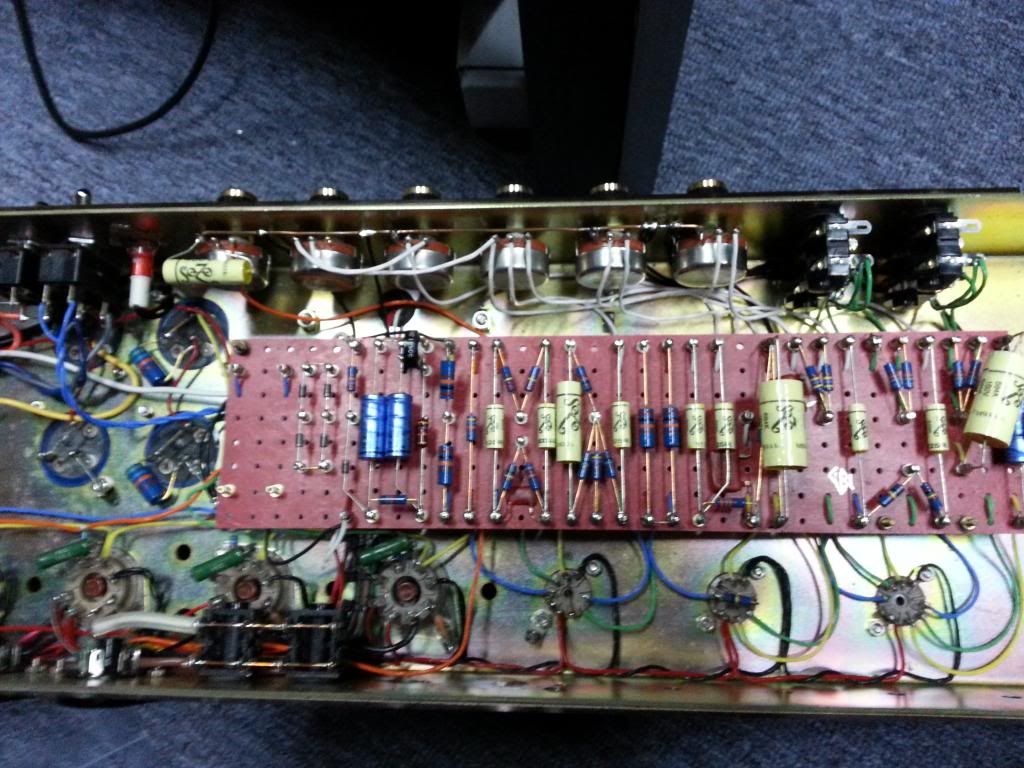

i just build my last marshall superlead amp.
i find out my amp still have sound even i turn the volume to zero. channel 2 more serious than channel 1. i sure every ground is good contact. and the pots is no problem. because i change a new pots, problem can't fix.

I think I see a black wire from the pot ground buss to the ground on the circuit board.
However, if you have sound when the volume control is on zero, you do not have a good ground for that control.
If it was wired correctly it would be working right now, whether you use expensive parts or cheap parts.

« Reply #2 on: January 29, 2013, 09:50:51 pm »
hi
i sure all the ground are connect. and this amp very very silence, no noise. just have volume even turn it to zero.
i will check the ground today again.
btw, will this amp have other problem? do  you mind to give me some idea?
because i use PEC pots, so i just connect the pots lug which need to ground to bare wire, and i use black wire to connect the bare wire to the chassis ground (which connect to filter cap ground also)

And i use cts pot before. I use bare wire solder to the back of the pots to be ground. But i also have this problem.
This problem is caused by the ground only ?
 if yes. I try to sand the ground to make the ground contact better today
Re: my marshall amp still have sound even i turn volume to zero
« Reply #6 on: January 30, 2013, 06:52:42 am »
Take a jumper wire with alligator clips on it. Clip one end to the chassis and the other end to the volume pots left terminal facing the rear of the amp. Tell us what happens

i find out more today. my friend superbass (vintage marshall 1969, but repair by me) also have this problem.
and i try to use jumper wire with alligator clips to connect the bare wire to the ground which connect transformer ground and power cord ground . but the problem still here. and i try to connect to the middle lug of the pots. still no good news. i will try to connect to the left of the pots later. your mean left lug, which is not connect the ground already, right? which connect to the 0.0022uf cap, right?

I have a pre PI master in a JCM style amp and at zero there was no sound. Till recently that is, when i put a 120k resistor between the wiper and the PI input cap. (that mod to make the master's throw more linear tonally and volume wise) Now it also has some sound when turned 100% CCW.  I don't get why since the signal should still be grounded, and i know the ground for it is good.  Weird.
Maybe that tiny bit or resistance most pots have between the wiper and the lug isn't enough to allow an audible sound thru except under certain circumstances?

i try to short the left side of the pots lug to the ground. But my amp still have volume  Short the signal to ground should be no sound. But why????
Can anyone help?
Offline Geezer
  • Posts: 3680
« Reply #10 on: February 05, 2013, 04:10:20 pm »
If you short the signal to ground and still have volume, then there is something wired wrong earlier in the circuit that is bleeding signal to something after the volume pot....double check all the circuit, point by point until you find the culprit.
