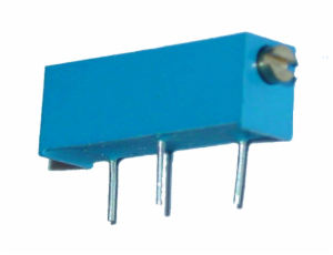

Sheepish admission: because originally this is a non-adjustable bias amp (fixed 22k resistor, or in the case of later models, 27k?), I didn't go beyond checking that the bias voltage was close to spec. With the tubes we ended up selecting, it was -32v when the schem said -34, so I left well enough alone beyond that, given that our goal was to return to spec. My guess is that once he lives with it for a little while, he's going to ask me to switch it to adjustable bias.
Next time he brings it in, I'll measure all of that with the JJs, too, and compare.
Is switching these to adjustable bias common practice? Will it lower the value?
  • Posts: 13187
Re: original '67 Princeton Reverb - repairs advice and bright switch
« Reply #14 on: April 30, 2013, 04:04:23 pm »
... because originally this is a non-adjustable bias amp (fixed 22k resistor, or in the case of later models, 27k?), I didn't go beyond checking that the bias voltage was close to spec. ...
Yeah, unfortunately, you'll probably have to use the OT Shunt method of plate current measurement to see where idle current is for this amp.
If you have a mutual conductance tube tester, you could measure each tube for its Gm to help figure out what's happening. But you can guess similar information by seeing idle current draw at the same bias voltage. Lower current for same bias probably equals lower Gm.
Sometimes it's done. It won't lower the value if you do it properly.
By that I mean you could replace the 22kΩ on the bias board with a small pot and a resistor to ground. There are small multi-turn pots that will fit in  the space on that board. The amp will look completely stock, but just requires you to pull the chassis to adjust idle current.
If you drilled a hole to add a pot that can be accessed without pulling the chassis, yes, you'll reduce the amp's value. The chassis would still have to be pulled unless you added some means of measuring tube current externally, so modding to add a bias adjust that doesn't require the chassis to be pulled seems like a bad idea given this is a collectible amp.

  • Posts: 13187
« Reply #16 on: April 30, 2013, 06:18:41 pm »
I bought 1 from Doug, he still sells them, works fine.
Yes, but there's not a convenient way to mount those.
I was thinking of the Bourns trimpot below. I've put those in an amp by standing it on the end that is opposite the screw, and holding it on the fiber board with a dot of glue. You want to mount your resistor and wire on the pot before placing it, as it will make wiring easier to deal with.

« Reply #17 on: April 30, 2013, 09:14:44 pm »
Great idea. That looks like maybe one of the Bourns 3006 series - 3/4W multi-turn trimmer? I looked at Doug's http://www.el34world.com/charts/fenderservice5.htm page under "Rewiring the Bias System", and it seems pretty doable.
Thanks again to all for your help!
  • Posts: 10610
« Reply #18 on: April 30, 2013, 11:01:46 pm »
I just put 1 leg in the PR's bias board, works fine. It's so small that there's no leverage to twist them.
The possible problem with the Bourns pot's is rotation life time.
                 Brad      :icon_biggrin:
  • Posts: 13187
« Reply #19 on: May 01, 2013, 08:21:40 am »
Yeah, I was just looking at that. Never saw their specs before yesterday.
I wouldn't expect Doug's trimpot to be any better, because after all they're trimpots... they're meant to be set and left alone (hence the poor ratings for rotational life compared to panel-mounted pots).
I guess if life is an issue, you lash-up a small panel mount pot in the chassis for bias control. The real issue is always that you don't want to add any holes in the chassis, so it can always be returned to stock upon resale.
