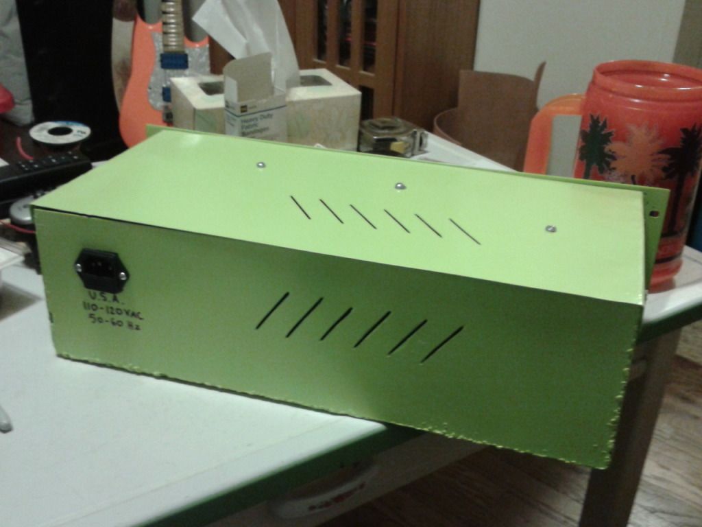

Chassis
Front plate 18 ga. steel.
"U" shaped chassis 22 ga.
back panel 22 ga.
top removable plate 22 ga.
Color= Rust O Leum Key Lime Green
This thing came out looking like a "ZVex" product, IMO. But they probably weld a lot better than me.

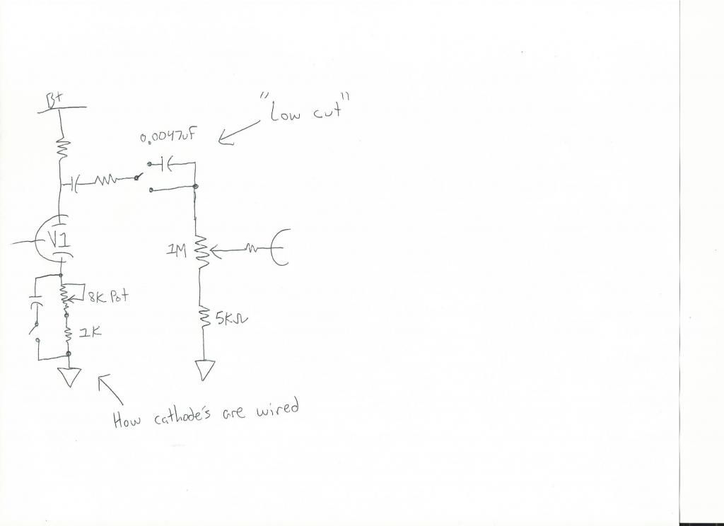

I'm going to upload my first initial schematic to this thread, but the circuit is a bit different than the scan.
I've added "low cut 1, 2, and 3" which are 0.0047uF caps in series in each interstage coupling.( spdt switch in/out.)
Also, 1K Ohm in series with each Cathode "bias" pot (parallel to the switchable cap) and not the 100 Ohm in series as the drawing shows.
I'm VERY amazed at how high gain I can get with all of that wiring! and when I hit a spot where it squeals, I can change one of the cathode bias pots a bit to get the squeal out.
It's pretty cool to change from a JCM800 style (first cathode with cap, 2nd cathode no cap high R) to a Soldano SLO type
(1st and 2nd cathode with cap, 3rd cathode no cap high R) with just a few knob turns and switches.
Also, It seems to me, I get a good VHT pitbull sound with Soldano "biasing" and using the U.S.A. EQ. (fender EQ) instead of the U.K. (Marshall) EQ.
The "pregain EQ" which is between triode 1 and 2 (if selected) is Really awesome for clean sounds.
That EQ, combined with the output USA EQ with each of the 3 gain knobs at about 9 O'clock is a great clean sound.
Very pick-responsive.
HOWEVER,
The "pregain EQ" drops the signal down quite a bit, so it is practically useless for HI GAIN sounds.
I was wondering, and I'm sure someone here will know, if I can "raise it up" by putting some OHMS underneath the mid control (to ground) of the pregain EQ, without changing the EQ curve?
Here's the pics, feel free to respond with questions, answers, criticisms, whatever you got....
Here is 04.52AM and my brain is a bit suffering, can you explain better or better post a little pencil schematic ?
the 1K resistors are in parallel or in series with the bypass capacitors ?
What about V3b, unused ?
Why don't use it as a CF as to have a better impedance in exit from the preamp ?

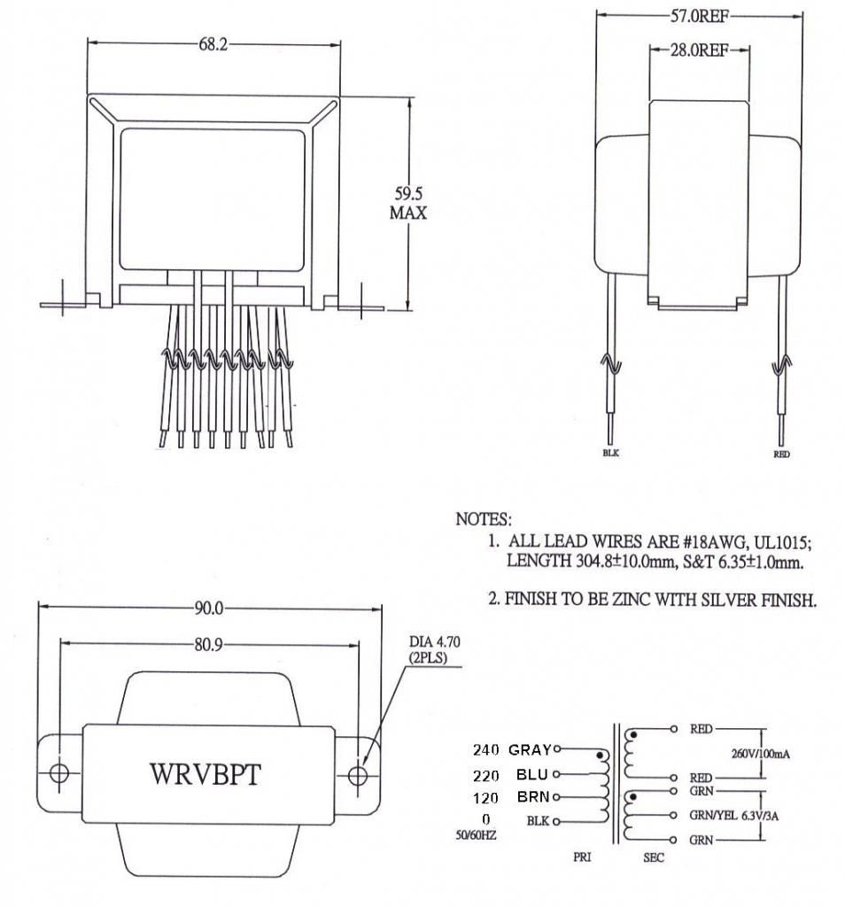

PT is tedweber.com WRVBPTEU for standalone fender reverb replacement. (pic below)
What I'm calling "low cut" is a cap with a slightly higher R for the low freq's, it REALLY helps tighten up the HI GAIN settings, for fast palm muting on the low strings.  but I have them off for good clean tones.

You can't really reduce the amount of insertion loss to the tone circuit without using something like a cathode follower or MOSFET source follower.
The Raw control itself will reduce the amount of mid-scoop and give the impression of boost but it does change the EQ shape to accomplish the effect. Try it yourself, but wire in a temporary pot to see for yourself what it does and whether you'll like it.
