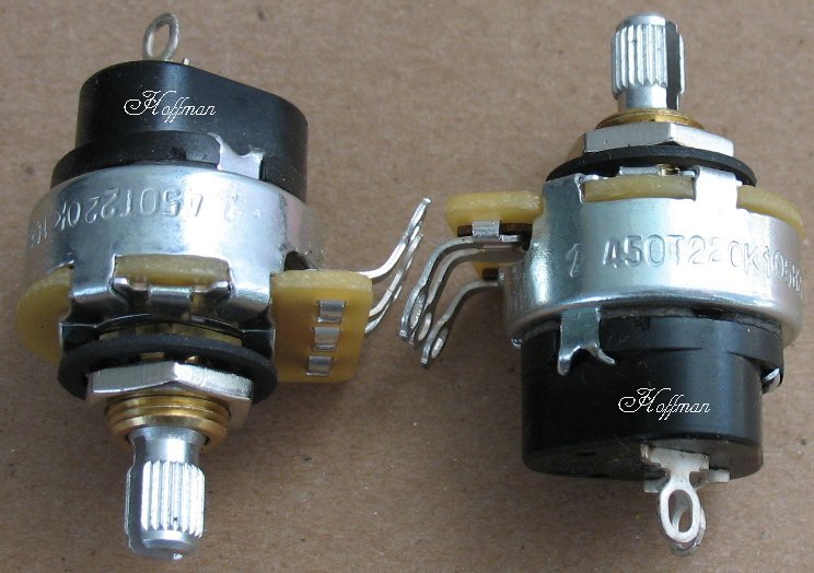

I am very new to amp building and am starting a Bassman 6g6B scratch build.  On the bass channel, I was thinking about putting a switch on it for different bypass cap values.  I was going to use (25uf (stock) and .68uf (mod).  I am not good at all with the schematic and was hoping someone could draw it out in layout form the best way to implement it.  I was reading about this and was also concerned about switchable popping. I just would like the input from those more experienced.  I believe it requires a spdt, as well.
I like 6G6's idea. I'd do it like this...

Thanks so much for the image and input.  If I wanted to use a push pull pot for the volume (instead of a switch) how could I wire that?  Someone stated about using a pot and I like that idea (than finding and drilling a hole for the spst).
  • Posts: 5280
Re: Switchable cathode bypass capacitor for Bassman 6g6B
« Reply #6 on: May 30, 2013, 09:05:55 am »
Wire it exactly the same. The only difference is the switch is on the pot rather than beside the pot.

Does it matter if schematic/layout calls for 250k L volume pot and I would be most likely using 1M Audio spst (like pictured)?
  • Posts: 13199
« Reply #8 on: May 30, 2013, 10:21:57 pm »
If you want your build's controls to respond like the original 6G6B's, then yes it will matter.

Can't seem to find a 250K Linear SPST pot.
Someone mentioned wiring another 1.2 or 1.5k resistor (for more Marshally sound)
How would that look?
I know this is a lame question but is that spot directly under the pot a grounding point?
After this, I am done pushing this, I appreciate everyone's help.  Sorry if I annoyed anyone.
Here's one... http://www.tubesandmore.com/products/R-VPP-250KL
yes

I'm not sure about which pot of the amp you want to have with the switch with the purpose of insert and exclude one of the two capacitors (0.68 - 25uF)
but I think you need a PushPull Pot, not a Common Pot with switch
with a Common Pot, you can't turn the pot without act the switch at the start of the rotation
with a PushPull Pot you can turn it independently by the activation of the switch
