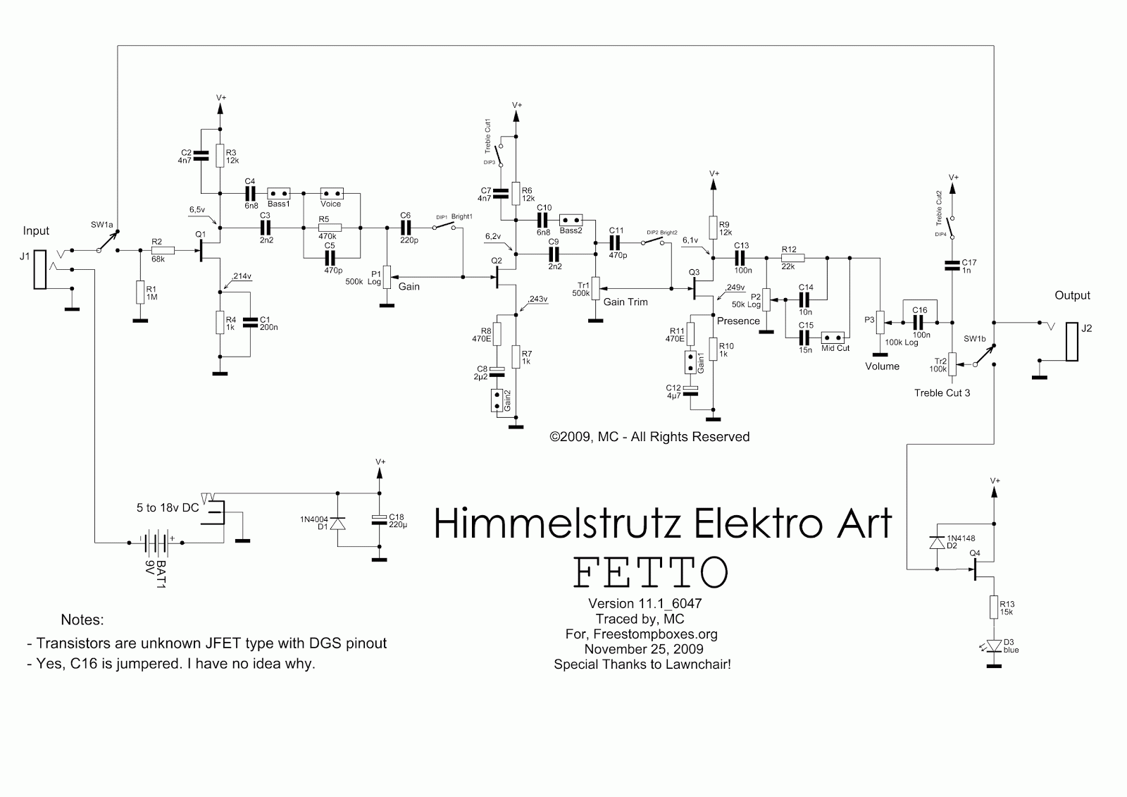

Bill, I think you're talking about wiring an FET AS a diode, such as the Zendrive does(?)
That is just a slightly different tone, but still diode clipping to my ears.
I was referring to running the FET(s) like a triode gain stage in an amp, only in a low voltage pedal.
My favorite so far is the Himmelstrutz Fetto.....here's a link to the schematic >
http://2.bp.blogspot.com/-HDMx7AB7MDs/Txgad6S3yiI/AAAAAAAAAog/fn93dntUIkw/s1600/HimmelstrutzFetto.GIF
It sounds so close to the OD channel(s) on my amps that I can hardly distinguish between them. And when you run the pedal WITH the OD channel, WOW!
It uses 3x 2SK170 FET's
G

Thanks Geezer I might have to build that.
Bill
