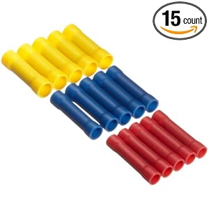

OK, the Red Box speaker emulator arrived .................
AND ........... the dummy load resistor arrived.
To my great surprise the O-ring contacts on the dummy load resistor will NOT take solder.  I even tried sanding them to etch them but it did not work.
Do you guys think this would be OK to use a speaker jack  to wire to aluminum O-rings and then bolt them together
Do you see any issues taking that approach?   I don't want to risk damaging the OT and power tubes.
Re: tube PreAmp & FX into SS power PA
« Reply #122 on: September 30, 2013, 07:34:08 pm »
A good tight connection is a good tight connection :smiley: Those bolts will be much tighter than the plug in your speaker jack, I'd think.
« Reply #123 on: October 01, 2013, 07:05:30 pm »
It may be sensible to view the 100w resistor as a 100w heatsink. So if you're using a 40w iron to try to solder to it, well...

The suggested system will act fine
if you want a more "professional" look you can use wire to wire crimp connectors
this way is a good thing to have the wires of the resistor and of the jack of the same diameter
with this kind of connector you can use wires of different diameter
this in a "no-crimp" connector with a screw
Ciao
