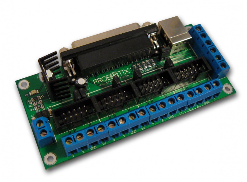

PRR,
I don't address any of the pins manually, Mach3 does all that when it controls the port
The pins that Mach3 uses are shown in my diagram
The printer cable goes to a parallel port breakout board and this is where all the pins are exposed to hookups
Here's a link and shot of that card
http://www.probotix.com/wiki/index.php/PBX-2
The 4 motor stepper drivers attach to the breakout board above via ribbon cables

  • Posts: 10672
Re: PCMIA parallel port interface
« Reply #21 on: October 11, 2013, 05:50:38 am »
Thanks guys, the circuit I showed above works great so far
If I ever need some other solution I'll refer back to this post
I am switching 12 volts Dc and the load is 3+ amps
the relay is beefy enough for this task
I have used the same relay for switching 24 vdc and 120vac
The 40 watt cartridge heater is being turned off after a print job finishes
The M9 Gcode command in Mach3 controls the parallel port output pin I am using
Here is the relay board I built
