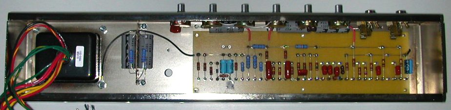

A)  Here is the chassis so far.  I plan to use a ground bus wire and was wondering if this is decent placement around the input jacks (I will have to drill).  A good man suggested using RG 174 which I have.  I used heat shrink with one 68k resistor to connect on preamp tubes which nullifies the pair at input jacks.  RG 174 will connect and be grounded at inputs.
B)  The PT (classictone)  I believe the two red wires and red blue wire are placed correctly to rectifier board.  The two green wires will go to the pilot light.  Are they placed correctly?  My 18 gauge will run to the heaters from here (from pilot light).  Which wires (Green Green/ 18 gauge to power) go to which holes on pilot light (2 wings, 2 holes)  signify perhaps Top Left, Bottom Left, Top Right, Bottom Right.  Where does the green yellow go?  I realize that they should be twisted.
C)  PT Unknowns:  Black wire to Power switch?  White to ??
Does this have heater center tap?
D) OT (Mercury single 4 ohm tap)  Brown goes to pin 3 on last power tube.  Blue to pin 3 of other power tube.  What about Red?  (goes to circuit board?)
Yellow and Black--no idea---to speaker jacks?
E)  Choke (Classictone)  I have no idea where these two black wires go.
F)  Rectifier board    On the layout, it shows a 1 watt 27 k resistor under the 25uf/50 volt cap.  I bought this rectifier board completed and noticed the resistor was missing.  I was told by seller that this was the bias resistor and was not necessary.  The chassis has a spot for bias pot for which I can place resistor of my choosing.  This correct, or do I need to add that resistor there?
G)  Eyelets Boards   I believe there is no space between insulator board and chassis but how much space should I put between circuit board and insulator board?  What kind of spacer should I use?  (stripped piece of PVC or teflon or something else?)
Sorry for all the rhetoric--Again I appreciate all member's positive input.
It could be. But the entire ground scheme needs to be considered. Please read about grounding in the tube amp library of information link at the bottom of this page.
Yes, the green PT wires are placed correctly. Put one green 18 gauge wire in the same hole as a green PT wire. Put the other green 18 gauge wire in the same hole as the other green PT wire. The green yellow connects to the chassis. Some people use a ring lug soldered to that wire and fasten the ring lug to one of the PT mounting bolts.
White connects directly to the white wire in the power cord. I just butt splice solder the two ends together and put heat shrink tubing over the splice. The green/yellow wire mentioned above is the heater center tap.
Let me say a bit more about the black and white wires. Connect the black wire of the power cord to the END lug on the fuse holder. Connect the side lug of the fuse holder to one side of the power switch. Connect the black wire of the PT to the other side of the power switch. Connect the white wire of the PT directly to the white wire of the power cord. Connect the green wire of the power cord to chassis.
Red goes to the left side of the board and connects to the eyelet labeled +430V. Black and yellow go to the speaker jacks, yellow to tip, black to sleeve. All these wires are shown on your layout.
They both connect to the left side of the board. One connects to an eyelet labeled +430V and the other goes to the eyelet labeled +428V. Doesn't matter which wire goes to which eyelet. This is also shown on the layout.
The original 6G6B did not have a bias pot so the 27K is needed if you want the original circuit. But, if you want to be able to adjust the bias with a pot, you can mount a resistor directly to the pot.
There is no spacer between the eyelet board and insulator board. Just sandwich them together and bolt directly to the chassis. Fender actually just used sheet metal screws.

First of all, Thanks so much Sluckey.  You clarified a lot and did it in a simple way in which I could understand.
As stated, I am a little slow but I am trying to understand as much as I can to get me to the finish line without consistently referring back to the forum.  I had to drill the steel chassis for the OT mounts and ground bus and it took some time to see my stepfather to use his bit and blah blah.  Although, I am wondering if I will have to drill again for the output tube grounds (more on this later)
All areas were understood except these
C) Power and Standby
White of power cord to white of PT
Black of power cord attaching to the end of the fuse
Green of power cord will be bolted to its own PT bolt
Black of PT to the power switch
Lugs remaining of fuse and power switch (as in pic) are connected via wire, is this setup correct?
I have a 3A fast acting fuse, this alright?
Standby Switch
Per Layout
Red from filter cap board is soldered to board and has two wires connected to it.  One wire (red) goes to rec. board and other goes to my standby lug close to bottom of chassis (as per pic)
Other from 430Volt solder point on board goes to other lug of standby.
Is this correct?  Should that one lug be that close to the chassis or do I have the switch upside down?
D) Speaker Jacks
from the OT "yellow to tip black to sleeve"
I checked online for tip, ring, sleeve
Are these wired correctly?
Should any choke or transformer wires be trimmed/cut?
H)Grounding
I checked out the grounding scheme on the site and it was very informative.  This is what I have planned but I am unsure of PT bolt grounding.
As per layout, two from circuit board top will be grounded to ground bus.  There is a black wire from filter board (between two just mentioned) that will be grounded to ground bus as well.
Green wire of power cord will be grounded to its own PT bolt as stated before.
Now,
red/yellow and green/yellow wires of PT
power tube grounds
bias wire (I have bias pot)
remaining black wire from filter board (w/ red and yellow-layout)
all will go to the same PT bolt?
Not sure how to carry this out.  Should they get different PT bolts or just one?  It's like six wires converging on one botl.  It goes against the Hoffman scheme, but should I just drill two ground points next to power tubes for them to ease some from all mentioned heading to PT?  Any ideas and pics of this would be very much appreciated.
I) Steps
Not sure how to word this and it might just be best for me just to do trial and error but I am thinking it would be best to do pots and have wires running underneath board first,  then mount/wire transformers accordingly and then mount boards and lastly wire up tubes.  I dunno.
I tried to make this as organized and easily understood as possible.  I am extremely grateful to those that put me on the right path.  I really am enjoying this immensely but just wish I had more time.  I should have been doing this years ago.  The Hunter book spurred me on and I will get the Blencowe book.  I will really want to understand a schematic.
Many, many thanks!
Yes.
You'll want to fit the power cord with its strain relief, possibly before making these connections but also making sure you have enough of the cord inside the amp to reach.
Recapping what you said for PT wiring; it's one big loop of:
Power cord Black -> End of Fuseholder -> Side of Fuseholder to Power Switch Lug -> Other Power Switch Lug -> Power Transformer Black wire.
The Power Cord White connects to Power Cord White, and completes the rest of the loop inside the PT.
If you have a meter with a continuity function, you can test for correct wiring by hooking the meters leads to the power cord plug pins. When touching the hot and neutral pins, you should get a beep with:
1. Power switch in the on position and fuse in holder,
2. No beep with power switch in off position and fuse in holder, and
3. No beep with power switch on but fuse not in holder
You should get no beep from the power cord ground pin to any other power cord pin. You should get a beep from power cord pin to any point on the chassis.
HINT: Rotate the fuseholder so the side lug is closest to the power switch, and bend that side lug outward a little to make wiring easier. This gives you short, neat wiring from the power cord entry to fuseholder to power switch.
Yes, the schematic says "3A". But get some 3A Slo-Blo fuses, too. The fast fuse may pop on turn-on. If it does, use the Slo-Blo fuse.
Standby Switch
Per Layout
Yes.
Yes
Flip the switch to get that lug away from the chassis. I don't know if that makes a connection through the switch with the switch in the up or down position.
Your standby switch is bigger than needed. Original Fender amps used a second "power switch" in the standby position, even through you may think the voltage rating is too low. Those are physically the same size as the power switch, mounted in the same way, and have the switch in the same position for "on".
Also, you pobably know that the black wires indicated going to the 430v and 428v points are the choke wires.
D) Speaker Jacks
Yes. Now add the short piece of wire between the other 2 lugs on the main speaker jack, and don't forget the wire from Yellow on the main speaker jack to the unused lug on the Ext Speaker jack. You may want to want to solder that lug on the Ext Speaker jack until you connect the feedback wire from the circuit board 56kΩ resistor.
It's up to you. You may want to leave them full length until you are sure everything is wired correctly. Or if you're confident of their position, you could trim to length. Leave the OT wires going to output tube plates (pin 3) full length until after you test the amp.
  • Posts: 13184
Re: Color by Numbers Bassman 6g6B
« Reply #8 on: November 09, 2013, 08:01:16 am »
power tube grounds
Yes, that's fine.
Put as many as you can on one. If you run out of room, use an adjacent bolt. You shouldn't need to drill any holes, as the PT has 4 ready-made mounting points for you.
I) Steps
Mount tube sockets, pots, switches and transformers/choke first.
Do all power transformer/power cord wiring.
Underboard wires: You soldered wires to your board already. It's easiest to route those wires through the holes, along their underboard path and to the correct eyelet with the board out of the amp.
Mount main board. When you install the board (with another, insulating fiberboard between the main board and chassis!), all wires are ready for connection to the tube sockets. Leave all wires longer than you think you need at this point, and trim to length when making the connection to the socket.
Make rectifier board/filter cap board connections to main board.
For this style chassis, do heater wiring last.
Another tip: Your tube sockets don't appear to have lock washer or keps nuts (a nut with an integral star washer). You want to use a keps nut or lock washer for all tube sockets and transformer mounting bolts (and any other bolted grounds you have) because these keep the connection tight even with vibration.
That's too close for my comfort. I'd either rotate the switch or get a switch that is identical to your power switch.

Regards to PT grounding
I have been looking at gut shots and don't see many with grounding this way.  Any one of pic or link of this?  Couldn't use a terminal lug for all of them....You just wrap all wires around that bolt?
Look at this chassis picture. See the black wire attached at a power transformer bolt? I'm saying for every wire you want grounded, take a ring terminal, crimp it to the wire, solder to secure it to the wire, slip the terminal over the bolt, tighten down a nut to keep it in place.
Click the links to see pictures of what I'm talking about.
For an example, see the picture below. The orange circle is around several ground wires bolted to the chassis (sorry I couldn't locate a bigger picture.)
You don't see it much on older amps because they just soldered to the chassis. You can too if you use a 100-150w solder iron. Bolted grounds are much easier to install and service.

I use solder type ground lugs. This first pic shows 4 ground lugs secured by one of the transformer bolts. The second pic shows the power cord ground lug secured to a transformer bolt but the other four ground lugs are secured by a dedicated kep nut/bolt. The type ground lugs I use have a built-in internal tooth star washer on each one but I still like the security of a kep nut.
« Last Edit: February 21, 2014, 09:42:21 pm by sluckey »

I am moving along and was looking for some advice in terms of grounding.
I have one and two hole lug terminals for grounding to the PT bolt.
I have the bias ground and PT red/yellow wire connecting on same point.
Should PT green/yellow be on that point as well, or seperate?
The black wire from filter cap board: does this meet on one of these points, as well, or seperate?
The output tube grounds: Should they both be grounded at one point together or seperate?  Should these wires be twisted?
I was going to twist PT red/yellow and green/yellow wires together, do you think I should twist the bias wire with them?
Just mounted bias board and pilot light and beginning to solder heaters.  The circuit board is tricky because mounting screw is under the OT and another is under filer cap board.  Also misjudged length of few pot to tube wires---dang.
The power cord white to PT white inline twist was difficult for me.   At first try, it went well but forgot the heatshrink--had to unravel and go again.  Then after a second time, I began to heat heatshrink and must have got too hot.  A tiny hole popped in it.  You think this will be a problem?  Meaning the wire might be hot and heatshrink lining will gradually seep out?  Hopefully, I am just paranoid.
Thanks in advance
Center taps to same point as well as negative from filter caps.
Here, I use a 1 ohm resistor so later you can measure ma to get bias.
Not sure what is meant by Bias wire.  Yes, you can twist ct wires.
This is not a problem as the wires should not get hot
Thanks in advance

Here's the filter cap board.  These wires are currently a bit more taunt.  I also have a cap cover and believe that I should add some kind of insulator to top of the cover to help reduce rattling of caps.
Here's corner which shows pilot, PT, rec board and fuse.  Here you can see slight crack (heatshrink) white/power cord crack that was mentioned earlier.
And next section moving along.  Power, Standby and bias pot.  Here you can see where I messed up length to v6 power tube-brown wire with heatshrink.  Needless to say I was hella pissed after finishing the pots and coming to end of tube wiring to see I came up short.  Twisted the lead and heat shrank it--I hope it's fine.  Might be difficult to ascertain but following bias pot layout of Bandmaster AB763.
Here's a long view of chassis at this point.  Here I plan to have red yellow/ red/green (PT) and white (rec board) all twisted and soldered to one terminal lug on PT bolt.  Orange is ground from filter board.  Not sure if I should twist that with them and soldered to same terminal lug as others.  Power output tubes grounds.  Should they be twisted together and converge on same point on terminal lug or each have their own point.  I know Ed mentioned resistors but wasn't planning on ordering any more parts and wasn't sure wattage to go with 2-4.
Close up shot of circuit board.  I have read shorter lengths are better and my RG174 input wires are definitely not that.  Hoping that this will not matter.  Here's other wire length mishap.  2nd red wire from bottom right connecting on v2 preamp tube was short by so little.  I tugged and tugged to no avail and ended up adding a bit of a lead and soldered to end.
I am thinking of nicknaming the guts skittles or perhaps rainbow which was not intentional at all.  All in all, I have to say that I really am enjoying this.  I still have to mount the OT and wire that along with heater wires but I don't think there's much more---Oh yeah the cabs for the head and speakers--that will be easy.  yeaaaa.  Currently contemplating if I want to venture into taking on box/dove tail joints.  All considered, this thing actually works when hooked up to a load.  What are the statistics for that?  Hopefully not the same as it being 60 degrees tomorrow.

« Reply #43 on: February 20, 2014, 11:28:05 pm »
And that's that......well almost.
Last stages went well but heater wiring had it's moments.  Dunno if I will use stranded wire again for heaters.  It was really difficult to have 2 stranded heater wires and jumper fit in one lug (pin 5) on the preamp tubes.  Those lug holes were skinny and very tight. Might look at different makes of preamp sockets next time.  I am lucky I didn't break a lug off.
I think I might need some adjustments but I am not sure.
A) Should I have twisted the filter cap ground (orange) in with the PT and rectifier ground (white)?
B) Should I have twisted the output tube grounds? (black--actually used leads from choke trimmings)
C) From photo above and this one, I believe I might need to trim OT wires or at least find a better way to tuck them away.  The ones going to SPKR/EXT. SPKR might work tucked in and around chassis back.
As told to me earlier in post, I might have to reverse OT primary leads to output tubes (brown/blue) due to oscillation.
Bias pot
D)  Is nut to close to the pot?  Is bias pot too close to tone control pots?  I have it propped on a washer to clear the nut.
E)  Perhaps I should trim wires here?  believe so
F)  Put a 15k resistor as per Bandmaster layout
Bouncing back and forth with Merlin book and Megantz.  Currently Megantz.  His initial power up is pretty thorough and seems solid, however, it might have to wait.  I don't have a cab matching the impedance and I am sketchy about using a dummy load.  (It was written to have a power resistor = impedance and > output power (which I don't know output power).  Not sure how to connect that resistor to the output but sure it's documented online--just haven't researched it yet.  Regardless, I don't think I am going dummy load route.
Any input is respected and appreciated.
Look at thinner wire instead.   :smiley:   20 gauge is fine for the preamp tube portion of the heater string.

« Reply #45 on: February 23, 2014, 03:54:50 pm »
Doesn't matter.
Doesn't matter.
Doesn't matter.
If you want.
