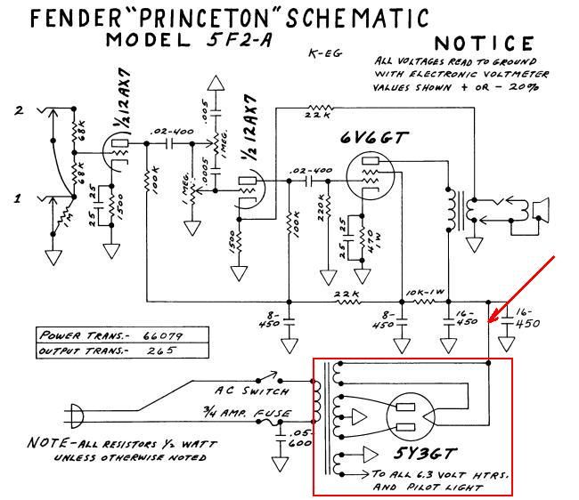

Hello everybody, I have a 5F2-A clone. I purchased a standby switch from Tubedepot.www.tubedepot.com/p-dpst-3way.html The layout shows 2 black wires for AC mains and two red for B+. I will assume the B+ on my Princeton PT are the two yellow wires to pins 2,8 on rec. Please see the link and tell me if I am right track with this so as to avoid a BBQ in the power section. I plan to run the blk wire from fuse and the other blk wire from stock switch to right lugs on DPST. I plan to remove ONE of the yellow PT wires from V3 pin 2 and run it up to other set of lugs on DPST ( top left lug) and then run another yellow from (bottom left lug) back down to pin 2 at V3. Is this correct according to link I have provided? Thanks for the help everyone!

Pins 2 & 8 on the rectifier tube is the filament or heater, depending upon your chosen terminology. While it is true that the B+ to the amp is taken from one of those two terminals (recommend pin 8 in case you ever decide to try out an indirectly heated rect tube...it doesn't matter on a 5Y3 or a 5U4) the usual practice is to interrupt the B+ itself. That means, the switch cuts the wire that is taken from the rect tube----not one of the two yellow transformer wires. This leaves the rectifier heater/fil lit up and ready to rock as soon as you flip the stby switch. Theoretically, one should try to avoid supplying full AC to the rect tube when the heater is cold....this is supposed to cause cathode stripping which is a life-shortening thing in tubes. But let's face it, this has been done since the dawn of tube time.
Short answer: Most people would not interrupt (using your switch) the heater for the rectifier...Most people would interrupt the B+ power takeoff which COMES FROM one of those tube pins. Most people would also like to see any bleeder resistor (if your amp is so equipped) remain IN CIRCUIT, meaning still connected to the filter caps when you flip the amp into standby so that the HV on the filter caps bleeds off a little faster. Makes for a little safer situation for servicing.

I am new to amp building and am still in newbie class. This is complicated. I have 2 red wires from PT going to rec pins : 4,6 . I have two yellow wires going to 2,8 . Pin 8 has B+ lead to first 16uF cap. Please refer to link. Please water this down for me. Which wires should I use and where to place switch? I followed the std Fender layout in initial build. Them layout per tubedepot DPST switch has black AC mains and (red B+) from the PT. please try to keep this simple for me.

OK, no problem. Conceptually, it is quite the weird thing for newbs to understand that high DC volts in a tube rectifier comes off a filament wire/pin. It's just so...unintuitive. But it does.
You were proposing to place the stby switch (electrically) by cutting one of the yellow filament wires for the 5Y3 rectifier.
My suggestion is not to touch any of the wires in the red box, and to place the stby switch where the red arrow points. Meaning THAT is the wire you cut.
THAT wire, the one I'm suggesting you cut, is physically soldered to one of the rectifier tube pins, either 2 or 8, but is NOT one of the yellow wires that comes out of the tranny.
It appears, from the schematic, that where I am proposing you cut your wire is "a dot in the air" that you probably recognize as an electrical connection, but I assure you, the actual place where that "dot" is, is upon either pin 2 or 8 of your rectifier tube. The OTHER filament pin, nothing is connected there but the single yellow wire from the tranny. Forget that one. You want to cut the non-yellow wire connected to the OTHER filament pin and place your stdby switch in the middle of that wire.
AND BY THE WAY, DO NOT TOUCH ANY OF THESE PARTS until power has been shut off to the amp for a good 5 minutes...even better, MEASURE the DC volts on either pin 2 or 8 of your rect tube relative to ground (chassis) and don't touch anything until that reading is in single digits.

Ok, so I place switch inline with wire from pin 8 to first filter cap? Would this method eliminate 5Y3 from the standby wiring? In other words the 5Y3 never gets to pre heat...but is blasted with high voltage when cold?thanks for the patience!!

I think I am getting a handle on this. When switch is in standby mode:black AC mains preheat ALL three tubes and when switched to ON the wire that goes to first filter connects applying power to all three tubes. Correct?

Yep, you got it. Light up the tubes, THEN apply B+ (if it makes you feel better)
It's still not an optimized design...because at the moment you turn from "stby" to "on" you get a big current pulse to charge up all the caps....and when you go to stby, there's nothing (other than the residual conduction of the tubes) to discharge the filter caps...because there's no bleeder resistor.
What we'd REALLY like to see happen is, (waving magic wand) 1: reduce inrush current the first time caps are charged 2: hasten discharge of caps (for service safety) when amp is turned off. Neither is achieved by a stby sw in this case.
But it's not worth worrying about! 1: usually achieved by a choke (which is there for other purposes, too) and 2: bleeder resistor. As I said, It's not worth obsessing over these things in these little amps.

I don't read all the asnwer but my opinion is a 5Y3 is slow start rectifier and don't need standby switch .
If you want one I suggest keep the first filter cap with the rectifier an put your switch's contact BETWEEN the first AND second filter cap.
Keeping one cap in the circuit will save the rectifier from a big current surge when put standby switch in play position. This cap will help the rectifier.
