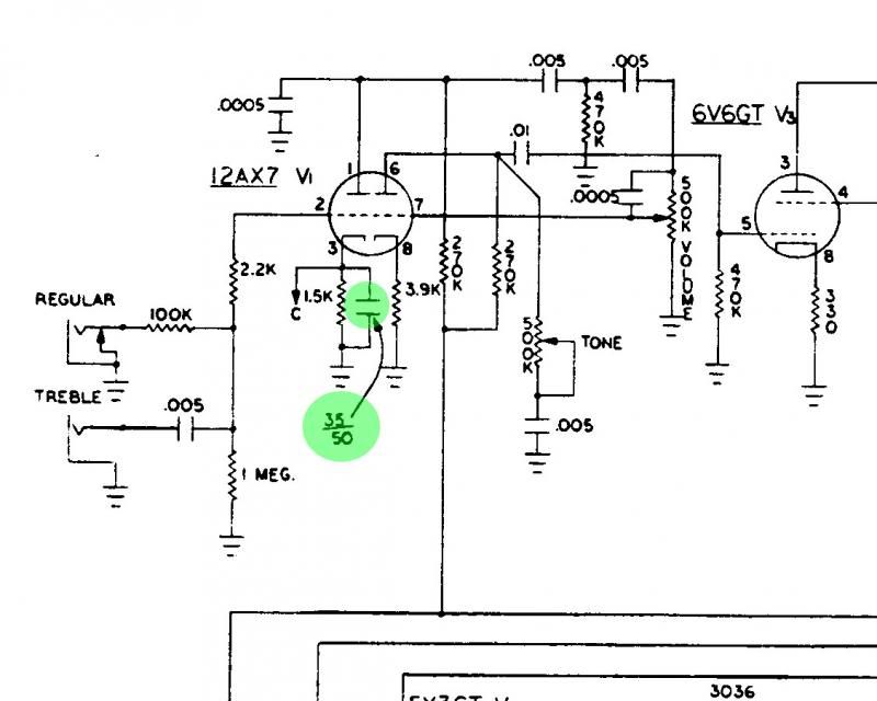

I also have a cap labeled like this 35/50 Is this a 35uf 50v cap. I think this is the cathode bypass cap on the first pre amp tube?

« Reply #9 on: January 06, 2014, 11:04:50 am »
If it only has 2 leads (not 3 coming) out of the cap then yes it should be 35uF@50v.
Although if it was a dual cap in a single can (3 leads) it would have a 3rd number on it.

Looks like just a standard 2 lead.

« Reply #12 on: January 06, 2014, 11:45:40 am »
Yep, you have it right.
It's your money, but getting the 50v rated part is just silly. You will never have a voltage close to that in that point of the circuit (even with the trem in place).
In reality, that cap will only need to be able to withstand a couple volts, but the smallest common voltage rating is 6.3vdc. Higher voltages (like 10-25v) will be more common and cheaper.
See, you're getting caught by changes over time in how parts are rated (10-20-25-50 vs. 10-22-33-47-68) and in commonly available voltage ratings (which are now largely driven by transistor/IC electronics, then by whatever other demand there is).
Get as reasonably close as you can (over or under) on uF rating, and try to get same or over on voltage rating (which you seem to be doing well). Ask on any part that's several-dollars, as some (like this bypass cap) don't need the schematic value (it was likely 35v originally because of availability back when the amp was brand-new).
