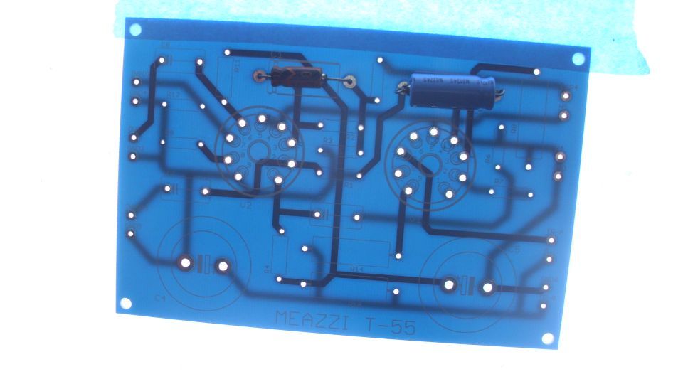

I am new to the forum and new at building amps. I work on guitars but modified an Epi VJ recently. I liked the results and would like to build my own 5W SE amp from scratch. I have an output transformer (ClassicTone) and am looking for an inexpensive but good Power Transformer.
 Also looking for suggestions on preamp resistors and such for biasing more toward a guitar amp. I am told the current setup picture is more for Hi Fi.
Tubes are 12xAX7 and EL84.
Gene

Get a schematic and compare it to a Champ, use Champ R and C values; EXCEPT use the EL84 cathode bias resistor. Keep the 100uFd caps; they are huge for guitar but that's OK.

Do you have a schematic of the amp as built on that board? If so, you could probably get some suggestions as to changing a few inexpensive resistors/caps that would make the thing more guitar-suitable.

No schematic, I have to follow the traces. I have plenty of 1w resistors and several different capacitor types and values. I have some Tropical Fish caps coming too.
 The EL84 is V1. Preamp is V2 12xaX7.
 Say R2 and R9 are changed to 1.5k ohms and R4 is also changed to 100k ohms. I can't figure out what to make R11 or R5.
From a smart man.
C8 is the anode coupling cap for V1 and at least 150v .1uF - .15uF.
C3 is the cathode bypass cap for EL84. 25v 150uF.
Also I have to learn how to wire this input output arrangement. A suggestion was:
Signal>input>V2a>output>input1>V2b>power section.

My suggestion: A meter with a "beep" function would be massively helpful, but in any case, I would strongly recommend you go through the exercise of tracing out the circuit. Look at a Champ schematic as kinda sorta your general layout of the symbols. Start with two circles and draw in the grids and plates, etc; Leave some room between the circles (tubes) and work in pencil so you can erase. The meter will help you with continuity test, in essence, to test your perception against the actual traces laid out on the board. The beep is great because you don't have to take your eyes off the board.
Not knowing anything about your general electronics skill level; this would be a truly superb opportunity to get familiar with 1: the circuit you wish to build, 2: how it differs from a Champ (but leave that to after you have completed the board-to-diagram exercise and have CONFIRMED you got it right) 3: how you might modify a few parts...or...only temporarily tack in some parts, eg; leave the leads long, don't press them all the way into the board and cut & solder the leads...you can always unsolder the too-long leads and change or choose to permanently install them 4: learn about how you have to look at PC boards on this fine little bite-size example.
That's a very cute little board and if you wish to learn about this stuff (as opposed to building a Heathkit thing where you really have no understanding of what's going on) this is a slick little oppportunity to do so. A fine learning experience, if I may say so. I like that board.

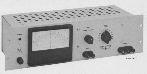

I myself am building an amp in the carcass of an old Hewlett Packard meter and it's almost done. But I am salvaging a little board remarkably similar to yours from the inside of the meter to build the circuitry around first two preamp tubes in an AB763 Deluxe Rev style amp. I will supply a more detailed expose once it is finished. In the meantime, here's a pix of the board I salvaged. In my case, I am stripping off all the traces and just bending component leads to make connections.

... I myself am building an amp in the carcass of an old Hewlett Packard meter ...
Uggghhh!!
I hope that 412A was in bad enough shape you couldn't tell if it was a meter or a ham sandwich... I have a special place in my heart for that particular meter, quite a few of them on-hand (maybe 5), and some of the innards are unobtainium. If the chopper in your 412A dies, the only place to get another is another 412A (or one of the few other HP models which had choppers).
Let me know if you had any useful leftovers from that meter; I might be able to use them as backup spares for mine.

No offense, but you should start with a well-thought-out kit. I don't know any vendors in particular, but I imagine someone on here can suggest one.
The Meazzi board looks complete, and their wording on the site suggests as much, but it really assumes a lot on the part of the builder to judge the suitability of the board to their application. And it looks like you'll have about zero support in building it.

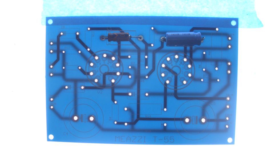

... A meter with a "beep" function would be massively helpful, but in any case, I would strongly recommend you go through the exercise of tracing out the circuit. ...
The problem is, there are a set of traces on the top and a different set of traces on the bottom. And after looking at each and how the signal transits certain parts, I'm convinced there is a 3rd trace layer within the board, as the top and bottom layer don't account for some (must-have) connections between some parts.
I think a well-documented kit with excellent build instructions would make this an enjoyable first outing.

There are definitely some traces hidden. It can also be soldered from the top or bottom.

It was a 413 AR null voltmeter, HBP. Rackmount. I'd be happy to send you the chopper & demodulator and the meter if you want them. How many of things can a person use?
The desktop ones, there are loads of them around under $50.
It's gonna be a cool amp, 1 ch Deluxe Reverb if I can get a small can in there without having a hum monster.
Okay, you are pardoned. The 413A is a beast for a particular (and not common for us) task.
Anyway, it seems the 413A uses some of the boards from the 412A, which is why it has that designation on the board in your pic.
Okay... hijack over!

Well, should I use this pcb or get a different one? If it is going to be tuff I can get another board for my first project and use this one later.
Re: First tube amp build. Tiny Meazzi T-55
« Reply #22 on: January 24, 2014, 10:30:13 am »
One alternative: On a very small board/project of this size, you could take a 1:1 photocopy of this board, cut it down, then tape it to a piece of bare PC board material. Drill out the resistor/capacitor holes with a very small bit, but a teeny bit bigger than the holes that are there. *Very* carefully drill out the holes for tubes....those have to be pretty accurately drilled. DON'T drill out holes for the baby terminal strips. If you want, get flea clips = push-in terminals for the external connections. (I never used them) You could also use perf-board, but you will still have to drill for the tube sockets. A baby drill press is the ideal item for this. The holes for the resistor leads might be a tad bigger, but you have to control the hole size for the tube sockets. Perf board makes the R's and C's easier, but might make the tube socket harder.
The board as is, even without knowing the circuit/schematic, is almost certainly pretty close to a Champ. Just install the parts into your board using the existing layout for the project you aren't going to build. The plate resistors and the coupling components will be in about the same places for either project. Push the leads through and bend them to essentially mimic the traces on the existing board. You will need to figure out a way to provide solderable terminals at the edges of your board to provide connection to the tone controls, p/s, input, etc; etc; Me? I just drill two holes close together and thread a wire thru up, then down to secure it, solder to a component lead.

I like the perf-board idea. Either way drilling holes for the tubes will be the tough part like you say. I have a Dremel that they have an attachment for a press I need anyways. Those flea clips look great too.
« Reply #24 on: January 24, 2014, 03:10:28 pm »
The perf board, when I used to be much more active building chip and solid state stuff, I would build stuff putting the parts on one side and bending the leads on the other side to form the connections and the stuff would last indefinitely. (and anyone else could, too) Good solder joints and strain relief for attached wires, this is a VERY rugged way to build stuff. You just have to get your brain into translating the connections from one side to the other, but it is basically a matter of "one item at a time"...double-check that you have the topside pin numbering correlated with the underside pin numbering.....leave a little more room between things than you think you might need. Don't bend leads tight-tight to the body of R's and C's. It's a great way to build ckts.
The issue I would have with perf board is that it is a lot more fragile than fiberglas circuit board material but I think that will prove to be a nothing when it comes to a tiny 2-tube project. Still, reco you try to mimic the layout you have on the blue board.

I found this schematic with my receipt. It does not look like the board I ordered but may help. It has a V2b.
I taped the board to a window for see through.
« Reply #35 on: January 27, 2014, 04:19:32 pm »
> does not look like the board I ordered... It has a V2b.
You ARE new, yes.
The 12AX7 is a twin-tube, really two triodes in on bottle.
For reference we often tag them "a" and "b".
So you have the right number of bottles and the right number of tube-units, and possibly the right types.
The schematic has ERRORS. The B+ supply and the NFB connection have been messed-up.
There's no values on that schematic.
The image in your first post shows Preamp Output and Power Amp Input, the schematic does not. (You may find that your PCBs have Out/In connections after C7 on the schematic.)
If your PCB really has two resistors under V2b, then that is very sweet, because the Champ (later AA version) also has that, and it is non-trivial to hack that into a single cathode resistor PCB.
I'll attach a scribbled-up version with Champ-like values in place. You need a full Champ plan to check my poor memory and fill-in omissions. You also need the Meazzi T55 plan/kit for the resistor values around the EL84 (in place of the 6V6 in a Champ-- do similar work but need different resistors).

  My question is will I need to make a rectifier for this setup to go from alternating current to deadly current?
« Reply #37 on: January 27, 2014, 09:05:43 pm »
Yes. If you look at the first pic you posted you'll see that the board requires +300V DC. There is no connecter for AC.
Man I thought that was a misprint being the schematic has mistakes. It has the output transformer shown so I thought next to it would be the AC in. Heather is another term I can't find anything on. Could the mean heater?
