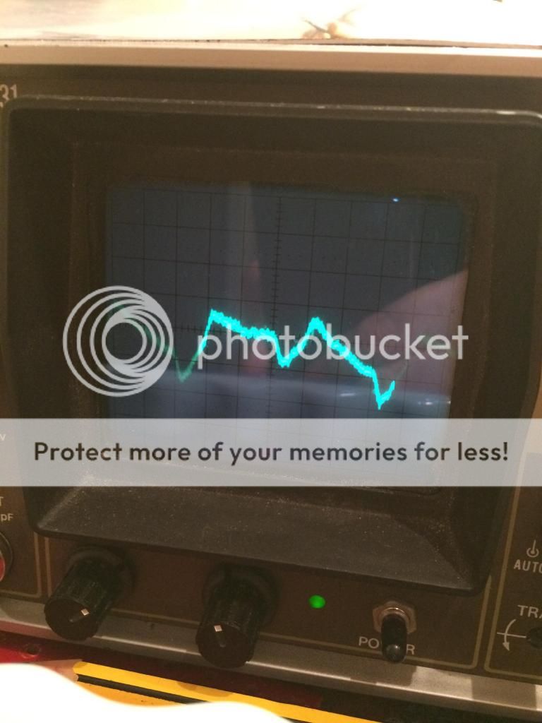

Ok, here's the hum on a scope, thoughts?

Re: What a dreadfull hum - Hoffman AB763
« Reply #14 on: June 07, 2014, 11:29:42 pm »
1) The hum was there before the cap job
2) Pulling V6 PI removes the hum completely
3) Pulling V4 lessens the hum slightly, but does not eliminate
4) No other valves effect the hum
Post some pictures of the amp board/wiring, especially V4 & V6. The hum is probably related to either the phase inverter tube or the wiring from V4 over to the phase inverter.
