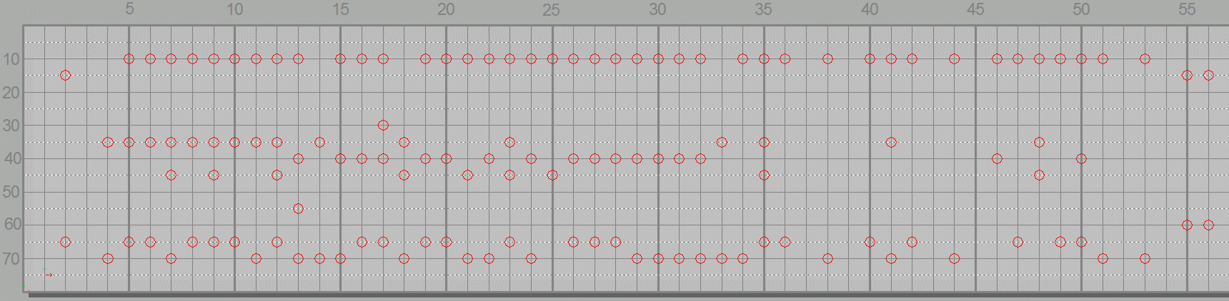

Hoffman is considering offering a pre-drilled board for the Vox AC-15 project that's currently being discussed in this forum. All holes will be done on his CNC machine so the boards will look very professional. The board will be approximately 14" long. He wants some user input concerning drilling so please take the poll.
Option 1. Drill holes for turrets only. This option is a no brainer. Just drop a turret into every hole on the board.
Option 2. Drill holes for turrets and wire pass-thru. Pros... This option allows for wires to be installed from the bottom side of the board for a cleaner look. Similar to the Marshall style. Cons... You will have to use a guide template to load the turrets. You may put a turret in the wrong hole so be careful.
Option 3. Drill holes for turrets, wire pass-thru, and standoffs. Pros... No drilling required, except to enlarge the holes for the 6 standoffs. Cons... May need to drill extra standoff holes if installing this board in a donor chassis.
If you are not familiar with this 'Marshall style' AC-15 project you can get more info here...

I'll throw out a few things about adding extra holes
My CNC uses a 3/32 carbide bit to drill the holes and so all the holes will be 3/32 just like turret lug holes
The wire holes being the same size as the lug holes may cause confusion and turret lugs mounted in the wrong holes
The red dots in the image above that Steve Posted would all look exactly like a turret lug hole
You would have to drill the mounting holes out larger and maybe the wire holes if you use a large diameter wire than the wires mentioned right below
These wires that I stock will go through a 3/32 hole, so there is no need to drill them out larger
20 gauge Teflon, 20 gauge pvc, 20 gauge cloth and the 18 gauge PVC stranded wire.
Mounting holes cannot always be determined ahead of time because donor chassis may have things on the other side right where you want a mounting screw or nut
Examples of that would be chokes and output transformers
Many times I have had to put a standoff mounting hole in another location because the screw head of nut would be right under an output tranny
And lastly, every extra hole adds more $$ to the price because it is machine shop time
As it stands now there are 133 turret lug holes
There would be 48 more holes for wires and 6 more holes for mounting holes
So that's 187 holes total
The 14 inch - 133 hole board would be around $18.16
The 14 - 187 hole board would be around $21.87
Just throwing out some info to help you decide
Here's a CAD drawing of the board with only turret lug holes
This board is now 14 inches long
Here's a CAD drawing with the wire holes - Black holes and the mounting holes - Blue holes
« Last Edit: June 11, 2014, 12:39:22 pm by EL34 »

It's really easier to deal with enlarging the pass-thru holes than it may seem at first glance. I make mine 1/8" and size the standoff holes for 8-32 screws.
Most of the pass-thru holes are on the edge of the board. (There are no turret holes on the long edge.) Then there are 4 holes on the power end of the board for screens and B+. That only leaves 4 holes in the center of the board and they are all in line. Really simple once you study the pattern.
Once the pass-thru holes are enlarged, the possibility of swaging a turret in the wrong place is eliminated because the turret would be a sloppy fit in a pass-thru hole.

All the 20 gauge solid core wire I stock, and that includes cloth, PVC and teflon, goes through a 3/32 hole no problem
And the 18 gauge stranded PVC wire I stock goes through a 3/32 hole no problem
So unless you are using some massive diameter wire, you are good to go
If you want the wire holes larger, just drill the small holes out
That would be easy to do since the holes are already there and you have a guide hole already in place
I just cut a couple boards today with all the holes, but
I cut the boards 1/4" too short and so the mounting holes at the right end are not on the board.
There's still other places at the right end of the board where two more mounting holes can go

Here's the hole diagram for the boards
The two boards I cut today end right where the two blue holes are at the right end of the diagram below

My suggestion would be, if you are thinking about supplying with the thru-holes, to supply at least 1 and maybe 2 copies of the "map" = the piece of paper showing the layout. (I'd be sorta surprised if you didn't do this anyway)
I have never turreted a bare board, so maybe this is an out to lunch suggestion.
Tape 1 "map" over the bare board so that the holes line up.
When you are ready to turret the board, take a sharp pencil or a pointy something and poke through the turret holes. Follow up w/a sharpie. Should leave a slight mark indicating where turrets go. Turret base covers up the mark(s) in the board, no? Or you swab them off w/alcohol if they bug you.
Alternatively, are not all the wire-thru holes are at the very edge? Take a piece of paper masking tape or blue painters tape and cover all those. Turret away on everything else.
If someone accidentally turrets a wire hole, they drill out the turret from the bottom, so it doesn't show, right? Nobody does this without some spare turrets, the expectation is that you are going to botch a couple. If they turret the whole line of wire holes....then that ain't so good, I guess.
For the extra $3, if someone wanted the "look" of the fed-thru wires, that's a no brainer.

I shortened the board as per Steve's suggestion, so now it is 14 inches long
