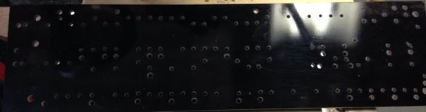

Busted out the board and got this done

« Reply #20 on: June 18, 2014, 06:59:01 am »
Weber parts came in and that's the last of waiting for supplies
Re: Lego's spin on Sluckey's spin of Hoffmans Revibe
« Reply #21 on: June 18, 2014, 07:00:06 am »
I do like black. Is the board 1/8" G10 fiberglass? Hope you have some pretty colors to load on it. Blue is my favorite.  :grin:
Take a look at this pic....   http://home.comcast.net/~seluckey/amps/revibe/revibe_03_big.jpg
Notice the screw head about the center of the board directly above that blue e-cap? That's a fifth standoff that was not on the drill guide. I added that after drilling the board for extra support. Probably overkill. Now is a good time to add that standoff hole if you think the board may flex too much.
« Last Edit: June 18, 2014, 07:02:12 am by sluckey »

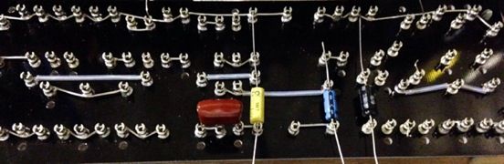

Here are some of the parts on board, they are just to show, not actual spot. I don't like the blue cap but I can live with it. I just have a couple more under board wires, go over top side again to check correctness and I'll start populating.

« Reply #23 on: June 23, 2014, 04:13:52 pm »
almost finished board, I've been in slow mode lately
« Last Edit: June 25, 2014, 04:26:45 pm by EL34 »
« Reply #24 on: June 23, 2014, 05:13:55 pm »
You don't need that cap and resistor. Look at my completed pics and get the updated pdf.

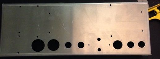

Started marking out chassis for all the holes

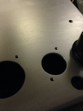

Got some holes done I did oversize first main cap a hair by accident,

« Reply #37 on: June 26, 2014, 04:48:06 pm »
Ok so I messed up on my arrangement when I was marking holes for tubes I had marked them on wrong side. So in this picture you'll see tubes on the opposite side of board :BangHead: so now my choice is flip board 180* or run tube wires under board then pot wires over top. Anyone have a suggestion? Will I have excess noise or will I be alright since it's not a high gain amp
« Last Edit: June 26, 2014, 04:56:14 pm by lego4040 »
« Reply #38 on: June 26, 2014, 06:05:14 pm »
OUCH!
Don't flip the board upside down. Even if you manage to make all connections correctly, you'll hate yourself when you have to troubleshoot, replace a component, or do some simple mod.
And don't criss cross wires like you are thinking either.
The cheap way (and this ain't my choice)... Strip the chassis and drill it properly. The board and the reverb tank will hide the tube holes. No, forget this idea. The more I think of this idea, the more my head hurts.
I would just get a new chassis (They are on sale). Measure twice, cut once. That's the best I got buddy. Sorry.

On his site now, will order. I can't believe I did, will leave it next project. I palm sanded it today and got a really nice brushed aluminum shine.
« Reply #43 on: June 26, 2014, 08:11:40 pm »
I wish I could come up with some workable idea to salvage that chassis but every idea I have is just butt ugly.
Offline lego4040
  • Posts: 917
« Reply #44 on: June 26, 2014, 09:19:11 pm »
Yeah, I appreciate the help. I'll just be more careful about it next time

Steve, What if I ran tube hookup wires under turret board very tight and neatly and pot wires over turret board neatly? I'll still order a new chassis for a back up. There really isnt a lot of wires on this build
« Reply #46 on: June 27, 2014, 10:13:45 am »
If you don't care how it looks give it a try. You may get lucky and not have any noise issues.
It's not something I'd do. I have a lot more time invested in designing the layout than I did in actually drilling a chassis. So it's a no brainer decision for me, but I do understand your position too.

I put the leads on the board and stared at the chassis not wanting to have to take apart. I'll order new one tonight and make all corrections when it gets in. Maybe I can salvage that for a future project  :wink: I still want my princeton reverb, 5E9A or Gibsons version of the Tremulox and this site has all the info I need

Steve, do you use bottom plates on your chassis? The chassis from watts sells those but they are seperate
« Reply #49 on: June 28, 2014, 10:41:25 am »
I don't have one on my revibe but I've just been too lazy to cut one. I highly recommend using one.
If your unit will get mounted in a cab you can skip the bottom plate and just use a foil shield or screen in the cab.
