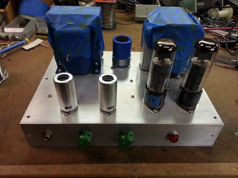

have a breadboard of this amp. it has promise.
parallel class A single ended EL34s with a cascaded pair of 5879 driving. B+ is ~ 435V. have a fairly stiff filter that scrubs off the buzz well. it's very quiet on the breadboard.
probably delivering around 18-19W: i have not measured yet.
more along the line of a early princeton with a lot of attitude. simple one knob tone stack and a volume control.
has a smooth distortion and can be very bright if played with a stratocaster on the tail pickup.
both transformers are edcor custom winding that were for another project abandoned long ago. OT is 25W core with 3500Ω to 4Ω it has a UL tap but it is not used here. PT is 660VCT @ 120mA with 6.3VCT @ 4A. the edcor part numbers are on the schematic.
driving a pair of eminence legend 1028 in an old marshall open back cabinet. sounds pretty cool.
EDIT: revised schematic & wiring/mech.

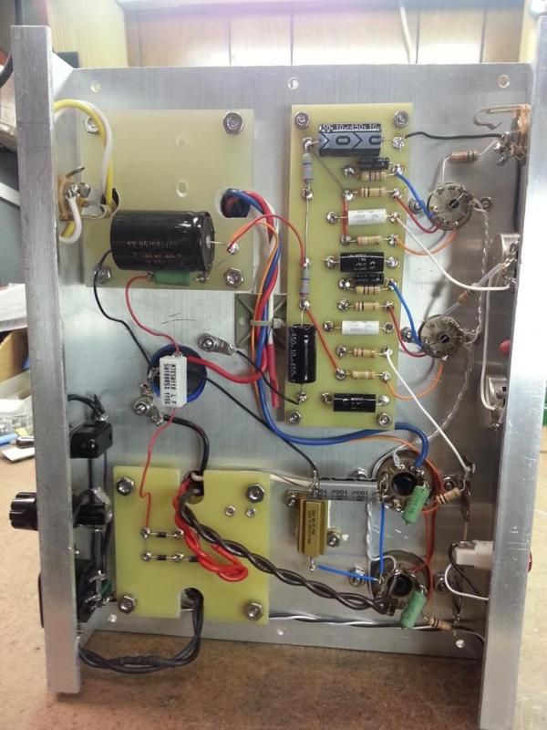

« Reply #8 on: August 27, 2014, 08:49:19 pm »
some progress. worst part of building tube amps is wiring the filaments... anyone else share that sentiment? hope to have it done this weekend.
« Last Edit: August 28, 2014, 11:23:32 am by DummyLoad »

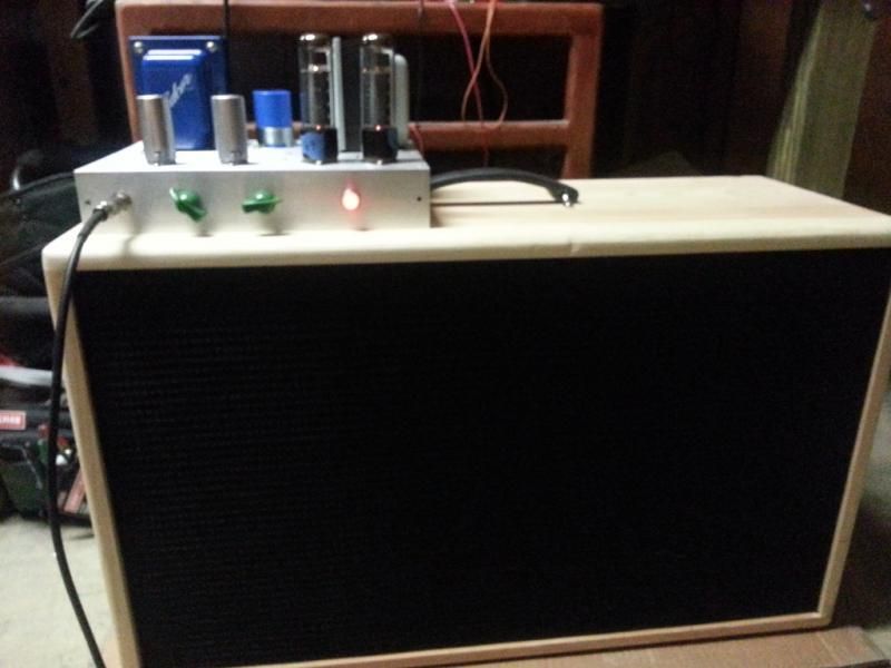

finished!
Re: zilker
« Reply #13 on: August 30, 2014, 10:18:14 am »
As always very nice layout and work Pete!
How do you like the way it sounds and the playing feel?
                Brad     :icon_biggrin:
  • Posts: 11605
Re: zilker
« Reply #14 on: August 30, 2014, 12:54:46 pm »
my2c, I use edcor on most all my SE builds n ya 6 weeks!  On the other hand, you can't "buy" it sooner, to me that says integrity.
Re: zilker
« Reply #15 on: August 30, 2014, 02:49:23 pm »
thank you brad. it plays nice. lots of harmonic content and the breakup is very smooth. if you crank it with hot humbuckers then it can get nasty. the tone is unique, i can't really nail it down so hopefully i'll have some sound clips to post. i'm driving a pair of celestion greenbacks in that cabinet under it. i like them a lot.
