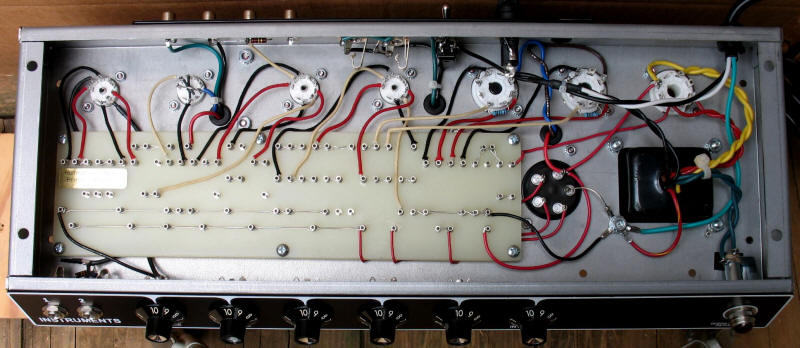

I am building a Hoffman Princeton Reverb board and installing it in a generic Fender style chassis with Face plates.
I will be stocking the princeton reverb chassis and the face plates shown below and so I wanted to make sure this build goes together as planned
Should be a fun project.

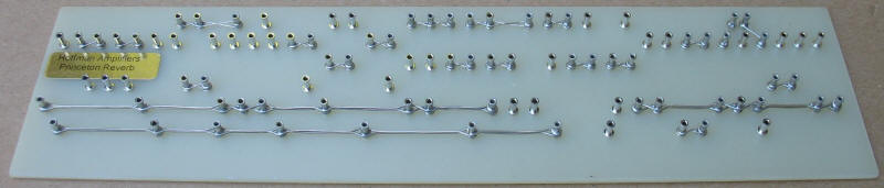

Today I swagged the lugs into the board
Laced the board
Soldered the laces in place.
That's as far as I can go until I mount the board in the chassis because I like to wire up my boards with no parts on the board.
The parts get added after all the wires have been installed to the tube sockets
I do the pot wires last

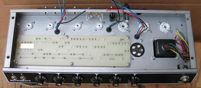

I may be able to get the board mounted in the chassis tomorrow and get some more pics taken
I'll post back when I have more updates

Plugging away at it today. I have all the bolt on stuff in place.
Time to start soldered up the tranny wires, heater wires, switch and fuse, filter cap wires
I am making detailed notes as I go regarding all the screws, nuts, grommets, etc I am using for the build
I will have a very accurate parts list when I am done
I will be stocking this chassis and the face plates and so I wanted to make sure this build goes together as planned
« Last Edit: August 15, 2014, 10:35:06 am by EL34 »

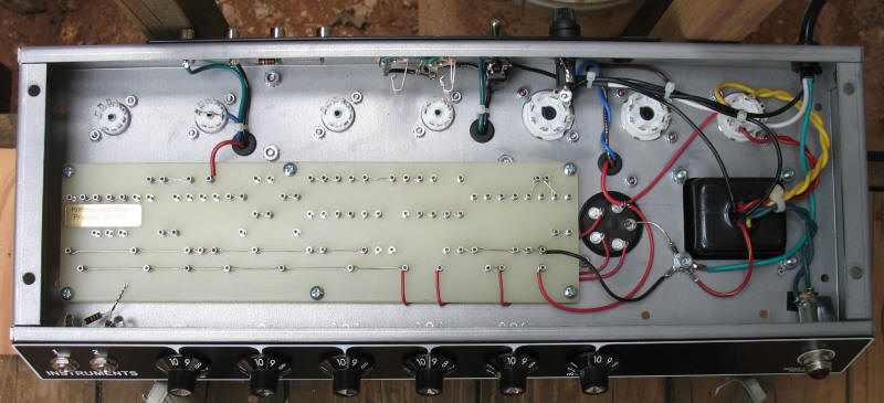

« Reply #8 on: August 15, 2014, 02:25:10 pm »
Getting there slowly
Got most of the infrastructure wiring done
more pics here
http://el34world.com/Hoffman/Princeton_Reverb_Board_Build.htm
« Last Edit: August 15, 2014, 05:10:44 pm by EL34 »

Got a bit more wiring done today
Lots of wire in this amp
Takes time to figure out good wire routing
Bigger pics are here
« Last Edit: August 16, 2014, 12:33:47 pm by EL34 »

« Reply #12 on: August 16, 2014, 04:07:58 pm »
That's it for today
Heater wires are always the least fun for me
All the wires have been installed except the pot wires, which I will do last after the parts are on the board
bigger pics here

Doing it this way, you don't mess up the parts leads when installing the wires.
It's not easy to install all those wires with a bunch of stuff in your way
If the parts were mounted on the board, there no way that you would not bend some of them
I probably dropped my wire cutters onto the board 10 times during the wire installs
Plus, some of the wires are down a few rows on the board and the best way to route them is under some of the parts
As you said, the wires are cut to the exact size with no waste
The parts leads will all be perfect and straight when installed last
I like my board installs to look as good as they sound  :icon_biggrin:

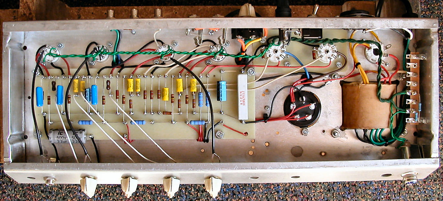

Got the parts installed on the board
Next comes the pot wires and then it will be time to fire it up
Bigger pics here
« Last Edit: August 17, 2014, 03:32:32 pm by EL34 »

It's done!
Finished the pot wires
Fired it up, set the bias to 30ma as a general test setting
Checked all the voltages, everything looked great
Plugged it into a Marshall 4x12 cab set at 8 ohms
Plugged in the guitar and gave it spin
It's a cool sounding amp
The reverb is great
After I change my 3 month old strings I'll do a video demo of it  :icon_biggrin:
More info and bigger images here

Are the two turrets in the power rail that don't have any components or wires attached to them just there to keep the buss wire spans relatively short?
  • Posts: 10627
Re: My Princeton Reverb build
« Reply #37 on: August 19, 2014, 06:02:43 am »
Hi Drew,
You guess it,
I found out that the one on the left end is not needed and so I removed it from the new layout
The one on the right side is there to help span a really long gap
