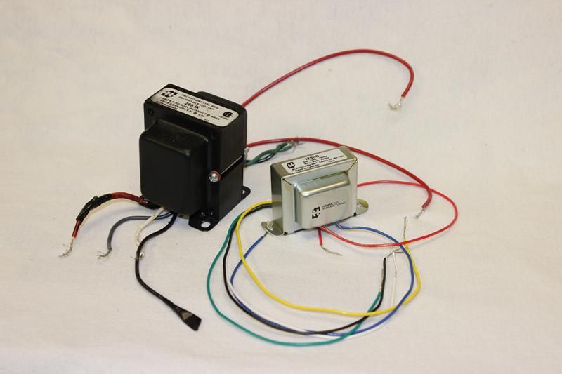

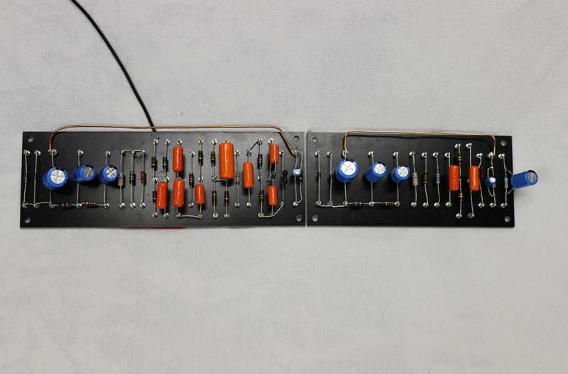

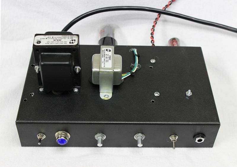

Here is the start of two 5 watt amps that I have started. One with Trem and one without Trem. The one without Trem is complete all but installation in a cabinet. It will be installed using a Celestion Ten 30. Im incredibly happy with this amp!
This was based off of the Gretsch 6150 that a buddy of mine had me take a look at some months back. I made some minor changes to the circuit on my breadboard since I was trying to get more gain and low end out of the amp.
Changes made were:
  • Series of two .005 coupling caps following first half of triode were replaced with a .01 as I was trying for a bit more low end
  • The plate resistor on first half of the triode was originally a 270k. It was replaced with a 100k.
  • Added a switch where the first half of triodes cathode was switching from a 45uf/1.5k and a 820 Ohm/no bypass cap
I ran the secondary of the OT outside on chassis as I wanted to keep these wires from being under my board since this is a small chassis.
The only thing I was hoping to get some input on is this. When fully cranked, the amp obviously sounds pretty gainy. However, I feel like the distortion is somewhat fuzzy. Kind of almost like a solid state practice amp. When I turn the volume knob down just a tad it takes away the full on gain tone and cleans up a lot. Just like a sweet tube distortion. Am I just maxing out the distortion of the tube where its squaring off the signal like in diode clipping? Im dont think this is a flaw by any means. I just dont necessarily prefer the tone but it can easily be dialed out.
Ill have more photos when progress is made as well as a video demo.
Thanks again.

Thanks everyone for your help. These builds turned out great. Built them for two very good friends. Amps sound great!
Offline hesamadman
  • Posts: 732
Re: My two 5 Watt builds (with trem and without trem)
« Reply #12 on: October 22, 2014, 04:58:30 pm »
Blue amp no tremolo. White amp has tremolo. Both loaded with a Celestion ten30
