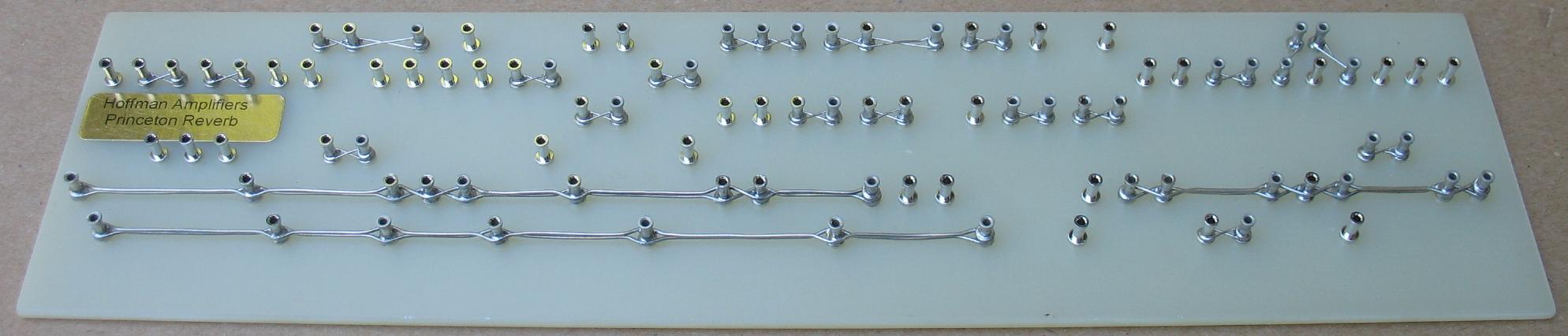

Two questions:
1)while this may be a soldering 101 question how on earth do you get those nice soldering blobs built up ON TOP of the turrets like that.  I would pay to see a close up 15 second video of you dong one of those. I always thought I was OK at soldering but now I want to learn to make em as clean lookin as that before I go at anything else.
2) what gauge buss wire is that?
I recently used bridge suspension rope for my buss wire! (18awg solid cloth as it was all I had and easy to take the cloth off. However it's a bit over the top.)  So I must add some to my next order.
Cheers,
Bakerlite
I should do a close up video of how I do those lugs.
Basically you feed in some solder and let it fill the hole
Pull the iron tip and solder away and let the inner fill get solid
Bring in the iron and solder to create a dome
I use 20 gauge wire for the pot buss.
24 gauge buss for the short lug jumpers on the boards
22 gauge for the power supply rails and long ground lug buss on the board
