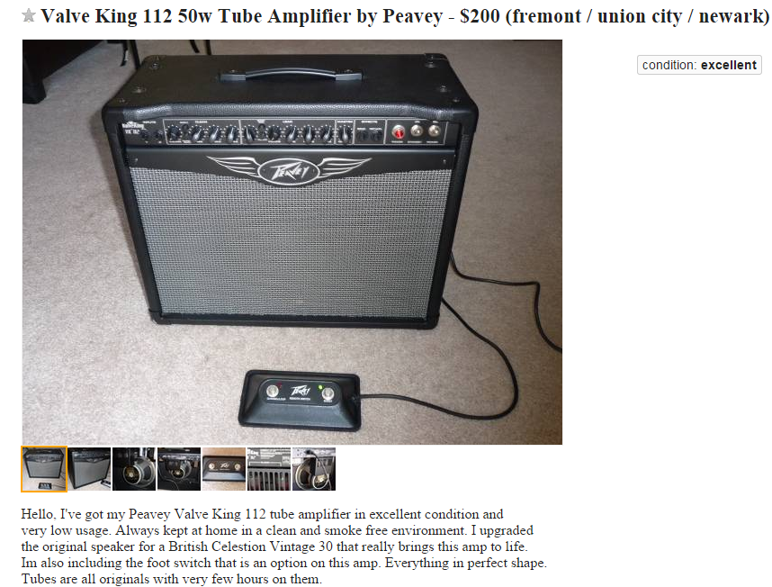

At the risk of discouraging you from a neat project that I know you want to build for your son....don't you think you could buy a decent condition used Peavey amp for about half of what that would cost you to build?
You think you can build this for $200? I see these for sale all the time in the low $200's.
With reverb, channel switching (this one has a better speaker which is the big weakness over the stock item) cathode bias so you don't have to bias it.
I have one of these, swapped an Altec speaker into it. It's 90%+ as good as my old 40-watt modded SF Princeton Reverb. They will sound better with better-than-Chinese (stock) tubes installed but there is nothing wrong with it as it is.

There is no doubt that I can't build it for anything near that price.  I suspect the transformers alone were close to that :).
I have really enjoyed researching these old amplifiers/schematics, learning, designing, planning, etc.  Spent a lot of the weekend scheming on the cabinet design with my son (he is turning into a decent daytime carpenter/nighttime musician(!)).  Will hopefully work on it with him, my father and brother over Thanksgiving.
If we end up with a working amplifier I think it will be worth it.

I appreciate that it might be a really fun project for all and I am glad you take my suggestion in proper light. It's just that the finished U-build-it project requires the simultaneous exercise of woodworking and metalworking and obviously electronics and that fairly big check for all those parts....and a handle and corners....and $20 worth of knobs..10% of the whole amplifier in just knobs!!..and guess what, if it doesn't quite suit his needs, he can probably sell it for about $200. Meanwhile, yeah, it's made in China but it might just be a lot more practical in terms of a rugged thing he can chuck into the trunk of his car and have lots more survivability than something you might build. I have mentioned these amps a few times and I apologize if I seem obsessed over them; it's just a ridiculously practical cheap thing that has worked very well for me, they are built very well and with a good speaker they sound quite good. The stock speaker is simply a travesty! But it makes a good bench speaker once you swap it out)
OK, I'll shut up now.

It's ok; I do understand and appreciate your thoughts, and suspect there is wisdom there,

Financial wise, 11teen is right. But I can tell you, hearing a working musician playing through something you custom built with a smile on his face, is priceless.
