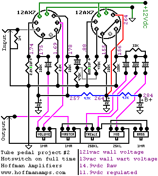

I was looking at Dougs trioid transformer schematic. He is using a step down tranny as a step up tranny and a 12VAC walwart. But in the schematic it looks like the two 9V taps are wired in parallel not in series.
 Is it ok that each 9V tap is seeing 12V?
  • Posts: 10673
Re: Dougs trioid transformers
« Reply #1 on: November 22, 2014, 04:33:30 am »
You have to think about the wiring backwards if this were used the normal way
The primary is on the left in the image
The primary is able to be wired for 240 or 120
So you feed 12 volts ac into the secondary and you are getting your B+ out of the primary
The image below is wired correctly for step up and my 12 volt AC wall warts

Thanks, I think I get what your saying. And your schematic is correct, no doubt. But what's in question is the transformer itself.
I get that you can take a 120V:9V tranny and put 120V in and get 9V out or reverse it and put 9V in and get 120V out.
But my question is: is it ok to use a 12V walwart with a 9V:120V stepup tranny? if I'm reading this schematic right your putting 12V into each 9V tap.
If the right side was in series then you'd be putting 12V across two 9V tap, each 9V tap would be getting 6V, that's 3V UNDER it's rating.
But since the taps on the right are wired in parallel each 9V tap is getting 12V, that's 3V OVER it's rating.
I imagine you could put 3V less than a tranny is rated for and still be ok, but is putting 3V MORE than the tranny is rated for OK?
also wouldn't you be getting much more than 240V out?
 9V:120V = 12V:160V,
 160V X 2 =320V,
 320VAC X 1.4(ss rect) = 448VDC

They are not 9 volt taps, it's just the secondary winding
So you feed whatever AC into the secondaty and out comes a higher AC from the primary
And the primary is in series so you get way higher than 120vac
My tube pedal projects shows I had a B+ of 284 VDC
http://el34world.com/projects/tube_box_4.htm

I use this power supply in a bunch of stuff.  I get about 280VDC (unloaded) once it hits the reservoir cap post rectification.  My supply is rated at 12VAC (14VAC) unloaded.  I prefer using a Lm317 to obtain 6.3VDC for parallel heaters.  Once everything is up and running depending on stages, the 12VDC series heater rail sags below 12.6VDC (11.58). I like to run it as close to heater spec for tube life.
The tranformer to my understanding, is a turns ratio so Voltage output is proportional to input voltage.
Hope this real scenario helps

The (typical) 20% regulation works forward or backward. So 20%*20% is 40% regulation and a very significant drop.
The Turns-Ratio usually allows for regulation. A "120:12" is probably wound for 120:14, with a few ohms resistance, so that under full load it hits its 12V spec. When you work backward, this step-up becomes a step-down.
True, a 120:12 - 12:120 rig should self-correct at no-load, but at full load it will sag bad. Because of resistance, and because you have un-done the winder's clever step-up.
