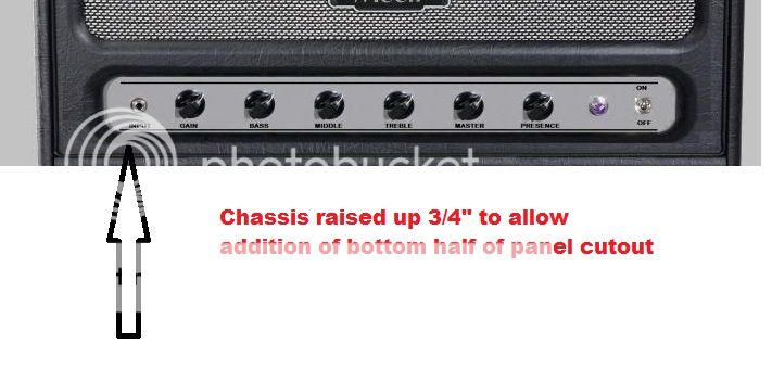

I'll be putting it in a heads-up combo similar to this old prototype cab:
with cosmetics that look something like this (different front panel of course)

I really like that cabinet design! Is that your own or did you swipe it from somewhere? What do you think about a rubber pad between the chassis and the "floor" of the amp section to give some isolation and extra protection to the tubes?

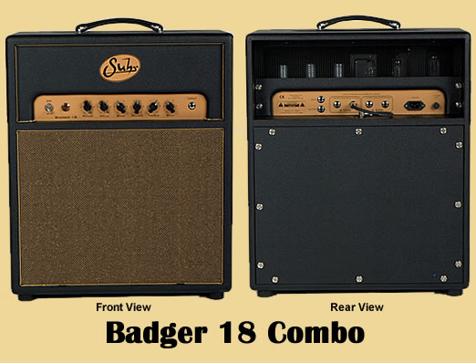

I've been making tubes-up combos for over 20 years. I made about 20 of these brown combos (and 3 or 4 black tolex versions), with a variety of guts, but mostly modified 5E3 deluxe or 18watt circuits:
I thought maybe I was the first to do it, but since the internet came around I've found a few from the past, like the Harry Joyce Custom 30:
, and the more recent Suhr Badger combo:
Both of those look like a Marshall head glued to a 1x12 cab, so I wanted to add a twist, which is to make the bottom of the front panel cutout "wrap around". To do this, you have to raise the chassis 3/4" higher, by adding a little platform right under the amp (I didn't do this yet on the prototype pic I posted):
