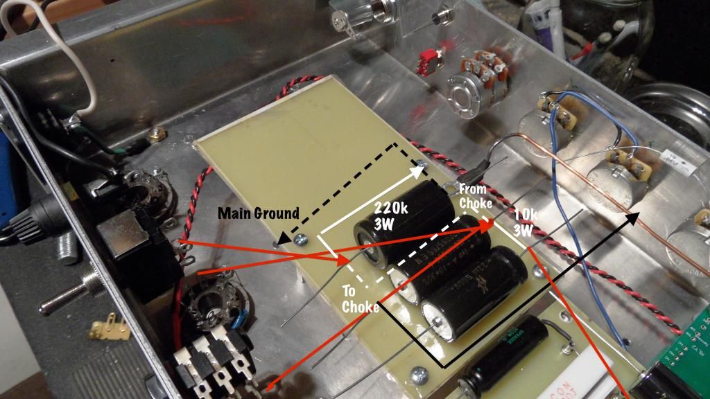

Hey all,
Got a new dose of parts in so I'm working on my filter cap layout. Will you all look at these pics if you get a chance to make sure it looks ok? Initially I was going to put them all on their own PS board and run wires but I like the way they fit on the main board. Plus this keeps the run to each stage as short as possible so I think I will add turrets where I need them and do it like this. Thanks for all your help.
Aaron
http://i422.photobucket.com/albums/pp301/drivenbyastronauts/Amp%20Pictures/CAPS%202_zpsgmexqr7d.jpeg
http://i422.photobucket.com/albums/pp301/drivenbyastronauts/Amp%20Pictures/CAPS%201_zpsw8eycbxk.jpeg
« Last Edit: February 21, 2015, 01:20:30 am by daveyajd »
  • Posts: 10327
Re: Tweed Overdrive Special (continued)
« Reply #51 on: February 21, 2015, 06:32:46 am »
That looks fine to me to have the filter caps on the main turret board.  I think you are going to have a very nice sounding build.
with respect, Tubenit

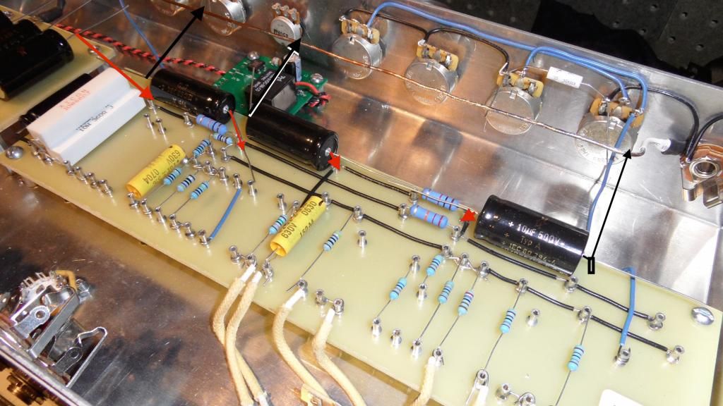

Like this;
Purple/black in 1st pic, preamp plate to coupling caps.
Purple/yellow in 2nd pic, PI to power tube grid stops.
Offline daveyajd

Thank you. Got a little more done today. Here are some new pics. Feedback about possible issues you see is always welcome.
Thanks,
Aaron
  • Posts: 10327
« Reply #70 on: February 28, 2015, 03:11:44 pm »
I think you are doing a great job and that it will be a very fine sounding amp!
