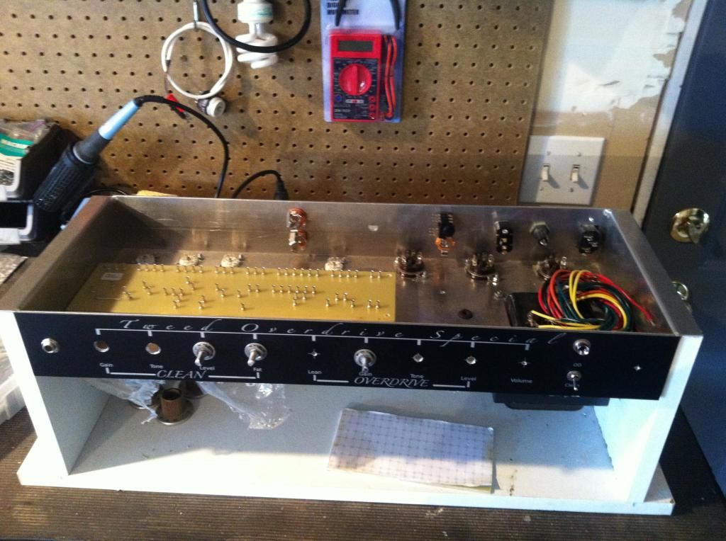

Hello all,
It has been a couple of years and many miles of life since I have been here. But damn it's good to be back! My original project and all of the info I was gathering at that time can be found here.
http://el34world.com/Forum/index.php?topic=13510.msg126422#msg126422
I am back on the TOS build and hoping to establish some communication with those of you who have the answers. Just placed an order with Doug and the service is still OUTSTANDING! Thank you. Here are some pics.

Re: Tweed Overdrive Special (continued)
« Reply #1 on: January 26, 2015, 01:45:20 am »
NICE :thumbsup:
  • Posts: 10323
« Reply #2 on: January 26, 2015, 05:31:41 am »
Impressive beginning!  Take it slowly and do great work particularly on the soldering.  We'll help you when and if that is needed.
I think you are going to end up with a great sounding amp!

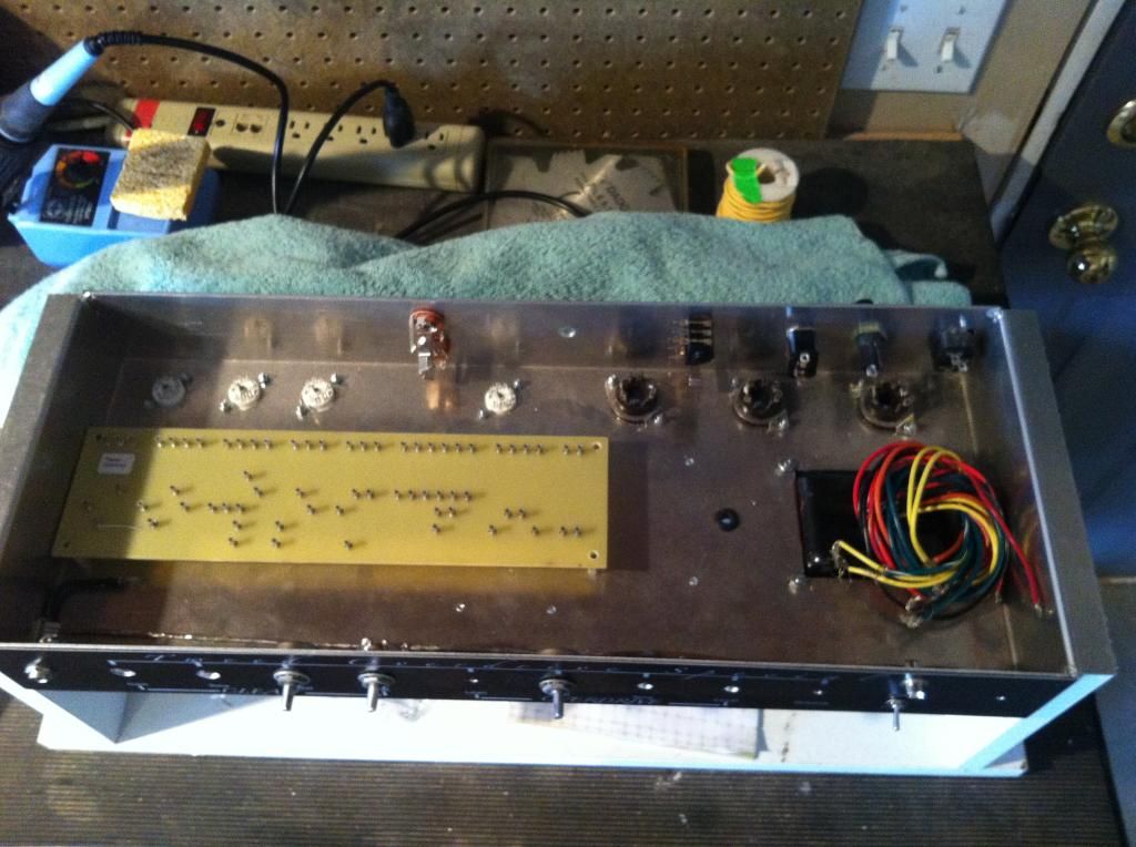

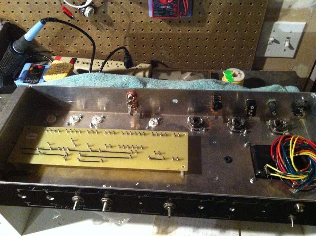

Here are a few new pics. Heater wiring is run, jumper wires on the 5879 and PI.
Aaron
