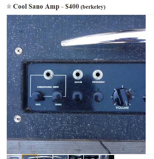

Love the look of that old home wrecker. I'm really into 'loud' and 'clean' so this is a true diamond in the rough.  thanks for documenting the restoration Jack. In case any of the forum brothers are interested. Here is a link to a Sano with quite a few similar features that is for sale on sneezbay right now.
http://www.ebay.com/itm/201401643609?_trksid=p2060353.m1438.l2649&ssPageName=STRK%3AMEBIDX%3AIT
 :icon_biggrin:
« Last Edit: August 14, 2015, 03:51:43 pm by smackoj »
