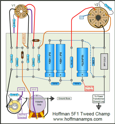

I've done a lot of reading, and have the GA-5 schematic.  But I also looked into the "The Schedule 40 GA-5 amp" project and like what I see there, but I have a few questions:
1) switching the 6v6 to el84, if I have read correctly, is not just a "use this power tube instead of that one", correct?  And won't that drastically change the tone from the warmth of the GA-5 to a more "British" sound?
2) is it even possible to mod this schematic to produce just a little more power (5w -> 8w)?  I see the GA-6 schematic adds a second 6v6 in parallel with a beefier output transformer, but it also adds things like tone control.  which, again if I'm following, somewhat destroys that tone the GA-5 makes.  having the tone pot even present will flatten the signal.

  • Posts: 7939
Re: GA-5 head
« Reply #5 on: April 24, 2015, 10:19:15 am »
The GA5 and 5F1 looks to be the same amp with variation on components value (and an added 20uF bypass capacitor on V1)
You can easily find on the net a layout of the 5F1 and use GA5 values to obtain your amp
A good choice is Doug's layout that follows the original 5F1 schematic (someone else add filtering to the PS)
http://el34world.com/Hoffman/files/Hoffman_5F1.pdf
this for an amp that has the same power of the original
if you want a bit more, you can build a versions of the 5F1 with a 6L6 power tube instead of 6V6
here you can find documentation about building a 5F2 (that is very similar to 5F1) with a 6L6 power tube (Voltages and OT spec)
http://www.thallenbeck.com/blog/posts/d-i-y-5f2-champprinceton-clone/
An alternative will be to parallel two 6V6 tubes and to connect or disconnect from ground the cathode of one
as to have the standard power or doubled power amp

Do you have any electronic knowledge/experience? Soldering skills?
The GA-5 is a great first time project. I suggest to build it exactly IAW the original schematic. If you need more power, put a mic in front of it or build a bigger version for your second amp.  :icon_biggrin:
As K said, the GA-5 is very nearly identical to the 5F1 except for component values. I would use Doug's 5F1 layout or just buy a board from him if you don't want to mess with that part of the process. Load it with GA-5 component values.
A lot of people here have built a 5F1 (or GA-5) and will be happy to answer questions or give you hand. We all love to see pics too. Good luck.

this is the schematic I'm going off of, straight from the source (so to speak)
http://www.gibson.com/Files/schematics/GA-5.pdf
  • Posts: 5397
Re: GA-5 head
« Reply #15 on: April 24, 2015, 01:44:07 pm »
Looks like a 5E1, except all the tubes have fallen down. Looks nothing like a 5C1.
Re: GA-5 head
« Reply #16 on: April 24, 2015, 02:08:31 pm »
The schematic you just posted is like Sluckey and K said, very much like a Fender 5F1.
