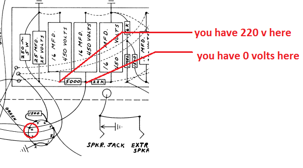

Wired the Hoffman 5e3 board up and I swear i've double checked everything 10x but i am not getting any voltage to pins 4 on either power tubes. I have 220vdc through the lightbulb limiter to the 1st filter cap and to both pins 3 of the power tubes(6v6) and 0 going to the second fc. any suggestions? fwiw i used classic tone 18016 pt, and 18002 ot. Maybe I'm missing something simple but my layout was nice and clean until I started tryin to troubleshoot. Any help or suggestions are appreciated. This is my first build
Re: 5e3 build. No voltage pins 4
« Reply #1 on: May 26, 2015, 04:09:13 pm »
Sounds like your second filter cap isn't connected to B+ supply. If that cap is supposed to supply pins 4 with voltage, that explains that. :)
Your bulb limiter is not glowing brightly, is it?

Is your 5K "intranode" power resistor open, in other words, does it read 5K end-to-end? That's almost gotta be the issue. And then of course the wiring to and from same.
Do you have any volts on your preamp tubes? (If the 5K was open, no "lower B+" nodes would be getting any power)

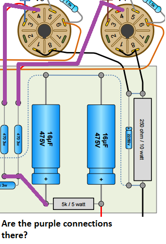

With power off, measure resistance from each pin 4 to ground. What do you get? Does that 5K/5W resistor get hot?

Recheck. If you have +220 v and +0 volts as indicated, yet the 5K resistor is good...that's hard to believe. One way this could happen is if the e-cap connected to the junction of the 22K and 5K is a dead short. (Brand new part?) That would mean 220/5000 = .044 amps through the 5K, .044 * .044 * 5K = 9.68 watts. That 5K resistor would be searing HOT. You would probably smell it, it could take skin off your finger. The other way is if the solder joint at the east end of the 5K is completely nonexistent.
Now that is relative to the FENDER parts board. The Hoffman board has a change:
Doug's board takes that node, the junction of the 5K and the 22K, and runs that node through separate 470 ohm "screen" resistors for each 6V6. A good idea. That/those connections aren't being made in your case. IMO that's all this is.
Fender:

Are you saying you have 470ohm on pin 4 to ground? If so, there is a short to ground at the junction of the 470R resistors, where there is supposed to be screen voltage.

Are you saying that, laid out as the dwg above with the purple lines, you have 220 volts on one side of the big 5K and NOTHING on the other side? Forget any connecting wires, strictly on one side and the other side of that one resistor.
not possible!
not possible!
Sure it is. Sounds like he has a short to ground on that end of the 5K resistor. That's why I wanted the resistance check from pin 4 to ground. Also why I wanted to know if that resistor was hot. I believe there is a short and that also accounts for the B+ only being 220V.
If you don't have a wiring error on the left side of that 5K resistor then it's likely that the second filter cap is shorted or installed backwards. Disconnect or just replace the second filter cap.  Get better.
One clear hi rez pic of that part of the board would likely solve this problem PDQ.

He just measured 470Ω resistance from each screen grid to ground. That surely indicates a short to ground on that end of that resistor.
