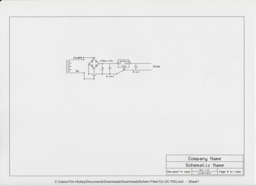

eleventeen has nailed it, If your string of LEDS are already set up to be connected to a 12v supply a simple PSU is easily made or most electronics store would have a simple off the shelf modules.
