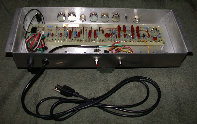

It was a simple task getting those extra turret's out, hopefully the rest of my errors will be that easy to fix.
The temptation to load up the board was too much to resist, it ended up looking a little industrial/rugged but should work ok. Time to get some holes in the chassis so I can start mounting things up.
This board is almost as long as the chassis, I can see now how sluckey made better use of his board area so that it could be shorter and leave quite a bit more room. I should still be ok though, one more tube socket but no cap cans to squeeze in.
« Last Edit: July 11, 2015, 10:20:52 am by TwoAlpha »
Re: ReVibe - with three tube Harmonic Tremolo
« Reply #6 on: July 11, 2015, 10:58:03 am »
Board looks good.

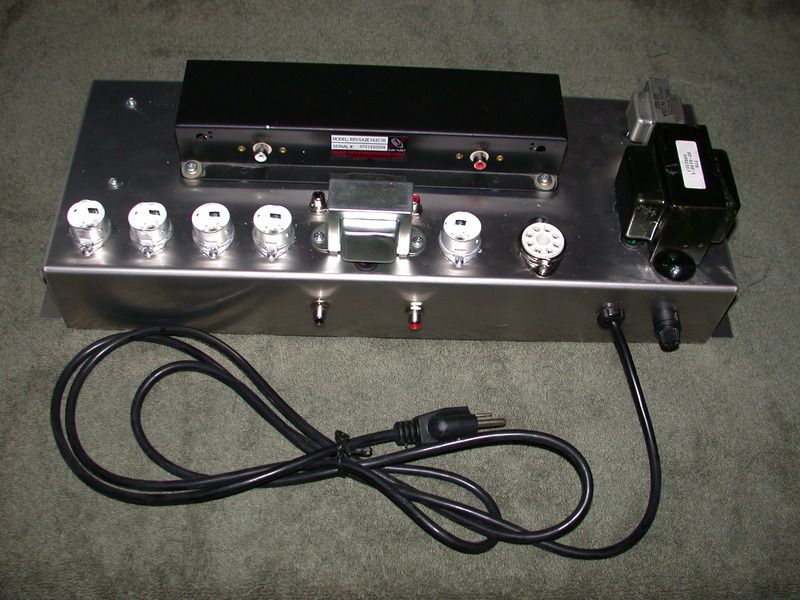

A bit more progress, managed to get all but one of the holes cut into the chassis. The last one will be done once I get my hands on a Fender pilot lamp assembly.

Time to get some wiring done.

Is that a 'short' reverb spring tank?
If so, the shorter tank will limit the reverb depth, fullness/lushness.
Offline TwoAlpha
  • Posts: 10
« Reply #11 on: July 15, 2015, 09:11:34 pm »
Yes, it's a Ruby Tubes tank out of a Traynor TRM-30 that I just happened to have laying around. We'll see how long it survives.
