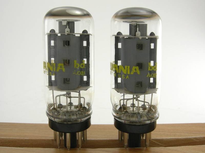

here is a 5F1 Champ   what is the power tube   anyone know   ?

6V6, I would guess. Absolutely, they were made with "coin" bases for some time. I mean, RCA definitely and GE (I think) made 6V6 tubes with coin bases. I think they were less popular because only the "top hold-down" type of tube retainer worked...the Fender claw and Birtcher over-center type tube retainers would not work because they clamped on to the octal base which was no longer there with that type tube.
Plus...the coin type base kind of came out in the 70's, I think, when a lot of stuff of all categories kind of became junky. I believe these style tubes are sort of associated with that era and people tend not to like them. I have no opinion as to whether they are better or worse than the "normal" style, I have only encountered one example, in a Champ I got in a trade and put in storage for 25 years. It worked fine, but that's indicative of nothing.

Wow    I didn't know they made 6V6 coin base. I also read they aren't the greatest tubes. Willabe I found a pic of a pair of them.
I know i'd seen some Russian tubes with coin base ( I thought) ...   but all these years I think I've only seen or had one . So these
coin bases where for "cost savings" ?

I think mresistor's picture is of coin-base 7591's. The plates look like 7591's, while the plate in the original post is definitely a 6V6.
I've got 2 or 3 coin-base 6V6's hanging around. Most I've seen seem to be G.E. or maybe Sylvania, though I agree with Eleventeen they seem to have been from late-60's to 70's (and maybe a little later).

OK  how about these  ...    they are marked 6V6 on the top

HBP made the good observation that 6V6 plates are generally solid with no holes (sort of like a 55 gal drum) and no fins where two halves are crimped together. 7591's have holes in the plates and those side fins.
Got a picture of the markings on the top?
I'm confident they are U.S. 6V6's, but look like late blackplates. By that I mean 50's-style blackplate tubes had a coarse surface, and later some manufacturers had smooth/glossy blackplate tubes while most tubes made were grayplate. The Sylvania logos look like 70's-80's era, but the tube designation marking would help pin down whether Sylvania (or some other maker) actually produced that set of tubes.

Yep, that's a Sylvania marking all the way. So the yellow label is accurate; it's a late coin-base blackplate Sylvania 6V6GTA.
