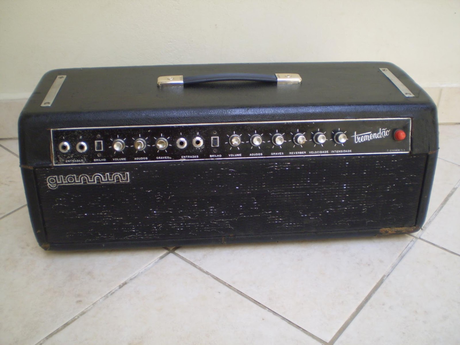

Oh yeah someone mentioned space, that was one of my concerns, I used to have those big heads and big speaker cabs(Giannini Tremendão), too much stuff and weight to carry, so I've reduced the dimensions somewhat in this build.
Here is a good pic of the same model of that old amp, from 60s or 70s. http://1.bp.blogspot.com/-e4-ZCErnPJI/T0r0_uG3k5I/AAAAAAAAA5Y/aOYrcnmR_H0/s1600/P5060044_1690x1267.jpg
Had one of those too: http://img.olx.com.br/images/97/979519089594557.jpg
