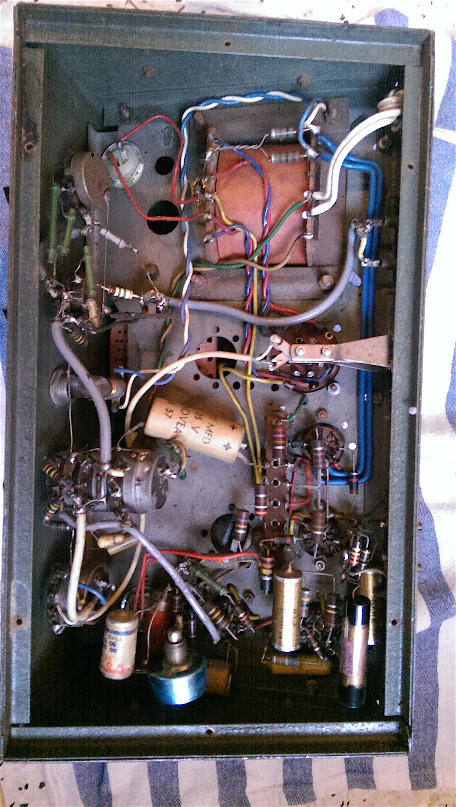

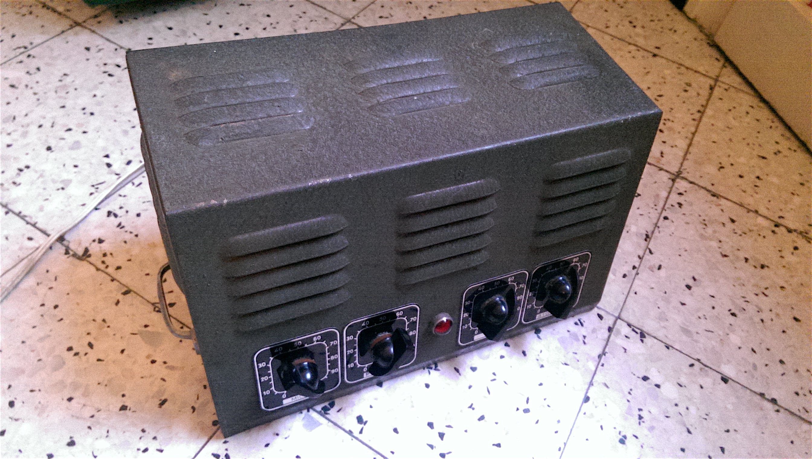

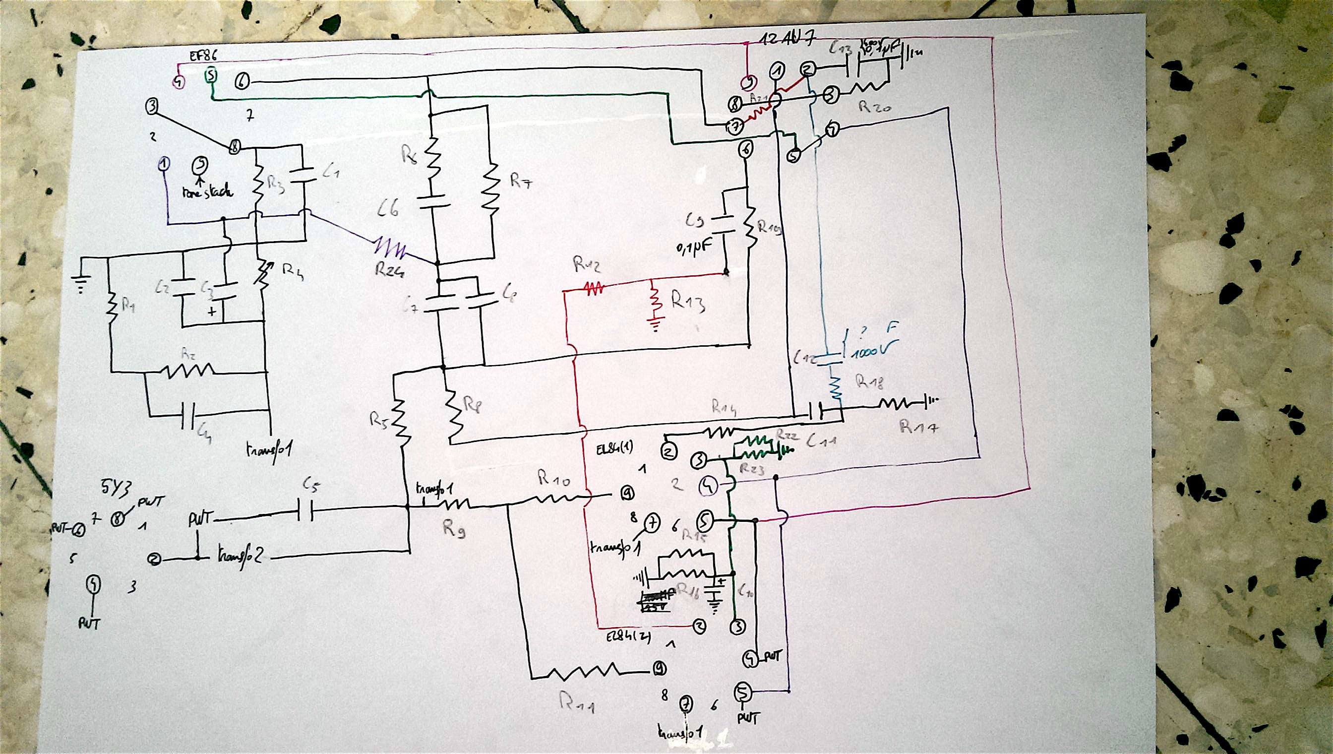

Offline Bender
  • Posts: 11
Re: Pre volume between EF86 and 12AU7
« Reply #9 on: December 23, 2015, 08:43:06 am »
Wow that's a lot of interesting responses, thanks guys!
I had an attempt to map the circuitry, it was a tough job (sorry for the poor quality of my photo). I'm trying to understand how I could transform it to be an AC15 based amp.
I am not used to fully design amps. Can someone highlights the bounds of the channel 1 on the AC15 scheme ? And I'm not sure to well understand the way to fit the mosfet onto the AC 15 scheme.
I added pictures of the beast, that is a sweet chassis to be a head amp, very robust.

  • Posts: 7934
« Reply #10 on: December 23, 2015, 09:17:52 am »
On your draw there is an arrow, indicating pin #9 of the ef86 tube, labeled Tone Stack ...... revise your draw and report please
pin #9 is G1, the input, in some old "HiFi" circuit you can find a tone control at the input, but not so often, so ... revise to be sure
R3 and (V)R4 are connected to ground at the junction ?
« Last Edit: December 23, 2015, 09:36:54 am by kagliostro »
Offline Bender
  • Posts: 11
« Reply #11 on: December 23, 2015, 09:35:37 am »
Hello Franco,
I drew this arrow to symbolise the coming signal, in the original circuit all the tone controls (volume, bass and treble) are curiously just after the audio input and before the EF86 ... Unless you want me to draw the original tone stack ?
NB.: R3 et R4 are not grounded at the junction
« Last Edit: December 23, 2015, 09:55:48 am by Bender »
« Reply #14 on: December 23, 2015, 09:49:19 pm »
It is almost certainly a lot like the Mullard5-20 posted in Reply #5.
Work from that, figure out what is different.
However if you want a GUITAR amp, you are surely going to want something very different. The hi-fi amp takes a 1V signal and treats it very accurately. A guitar amp must take a 0.020V signal and beat it up.
Pentode and 12AU7 is probably not enough to do it all. Pentode and 12AX7 is more likely to do what you want. The power supply and EL84 connections can mostly be the same, but much of the small-tube circuitry needs a major do-over.

  • Posts: 7934
« Reply #17 on: December 24, 2015, 02:54:47 pm »
I would like to see other photos of the amp without the cover

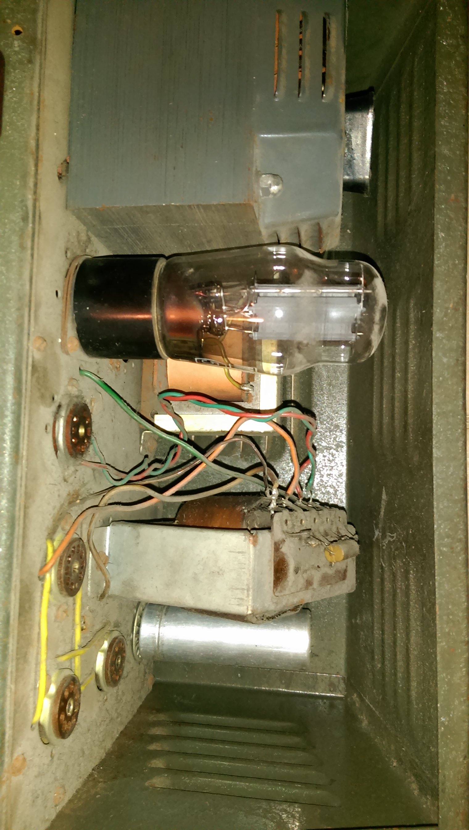

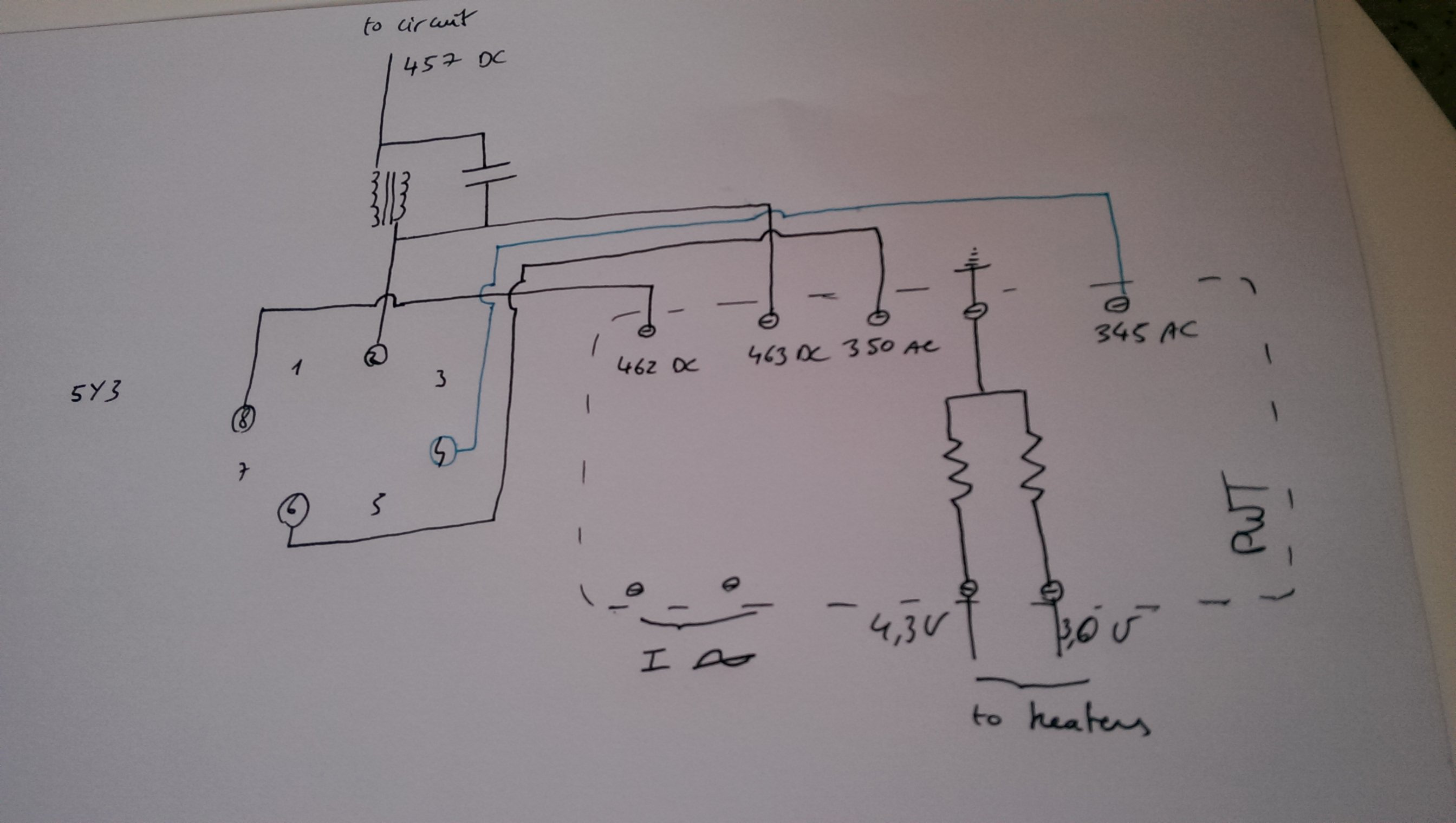

Offline Bender
  • Posts: 11
« Reply #18 on: December 25, 2015, 02:18:15 pm »
Hi folks, hope you had a great Christmas day.
Thanks y'all again for your replies.
I agree for a full re-building, moreover all the contacts are dirty and the components are antique, keeping them would be risky. At that time, I would like to have your support about the power section. Please find the scheme I made ; note that the tensions were taken with just the 5Y3 plugged.
I assume that it is not straightly suitable for the new circuit, isn't it ? Maybe few RC sections are required to fit it ?
Another question : what does the capacitor across the choke secondary and the power transformer ?
@kagliostro about a picture without cover : this is not possible without stripping all the front panel, what would you like to see accurately ? Please find another picture of the top.

  • Posts: 13211
« Reply #23 on: December 25, 2015, 11:18:54 pm »
Are you certain there is a cap connected across the choke as you've drawn? What value is it?
If it was a small value (on the order of 0.1uF) then the cap and choke would be a parallel-resonant circuit to strongly-reject a single frequency (and a band  on either side of that center-frequency). This might be centered on/near 100 or 120Hz to reduce the mains ripple in the rectifier output.
When this was done in the old days, it usually wasn't the only filtering present, but just a first-step before additional filter caps followed.

Offline Bender
  • Posts: 11
« Reply #26 on: February 28, 2016, 02:32:29 am »
Hi y'all,
It has been a moment since I posted. As a student, I can work on this project only during my vacations.
At this stage, my problem is to know if the original PWT is suitable for Sluckey's AC-15 circuit : http://el34world.com/Forum/index.php?action=dlattach;topic=19583.0;attach=55535
Please see the voltages I measured with the 5Y3 plugged : http://www.zupimages.net/viewer.php?id=15/52/7hkx.jpg
My problem is the following : is the PWT suitable ? Is there a way to fit the voltages ?
Sluckey thinks it is not. I ask if someone has an idea to keep me from buying a new $100 PWT.
Thanks, have a good day,
RG
  • Posts: 5377
« Reply #27 on: February 28, 2016, 06:23:16 am »
After re-reading this entire thread I'm gonna reverse my position about using your PT. Those voltages you listed are very high, but that's with no load (only the rectifier). Those voltages will drop when you plug in all the other tubes. And since your original amp uses EL84s the voltage will probably drop to a safe range.
So, I think your PT is suitable for an AC-15, or any other EL84 based amp. The OT is suitable also.

Yes, but I think your wiring diagram incorrectly shows how the choke is connected, not so much the choke but the cap across it.

Give a look to the photo of the circuit to verify
Probably the negative side of the 36uF electrolytic capacitor was connected to ground
I don't think an electrolytic capacitor was used for a Tuned Filter
Offline Bender
  • Posts: 11
« Reply #32 on: February 29, 2016, 05:42:33 am »
Just have checked, the diagram is correct, the capacitor is at the right place. I took down the capa in order to read the hidden characteristics : 2x50 uF, 350/400 V.
  • Posts: 5377
« Reply #33 on: February 29, 2016, 07:01:58 am »
Both leads of the choke will be connected to that cap can. But there are TWO caps in that can. What you are missing id that the body of that can is connected to chassis ground. That's the common connection for both caps inside the can.

Thanks for you help guys ! I was perplex while reading those "2x50 uF".
So, what's the plan for this conversion ?
My opinion is :
-to keep the power section as set up in the original circuit as show on my PWT diagram as far as the choke
-to keep heaters connections
(I have another double cap, I don't know if it will be useful...)
-build the AC-10 or 15 circuit from the choke secondary
Question : if I want to build a termolo circuit as on AC-10, is the power transfo able to stand another tube ?
Thanks,
