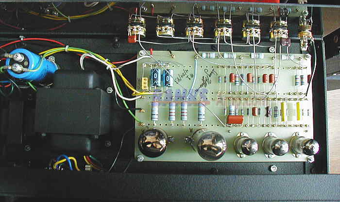

Unfortunately, the AC4 is a PCB.  I'd like to make it into a point-to-point turret board amp to experiment more easily.  As I said in the first post, one of the problems with the amp is simply cheap Chinese parts, such as the OT.

Attached are some gut shots of the AC4-C1 PCB.  The first picture is the stock amp with no changes.  The second picture I got from the web where someone upgraded the output transformer and made a few other mods.  This should help to prepare a turret board.
Re: Mini-AC30 based on Vox AC4
« Reply #18 on: February 05, 2016, 12:25:36 pm »
You'll probably want to mount the tube sockets on the turret board. Kinda like this...

In terms of turret board design, would it be possible to mod the Hoffman AC30 turret layout for a single ended EL84?  That way you could have a normal and top boost channel.
« Reply #21 on: February 06, 2016, 06:54:37 pm »
Since you don't have any strict size limits on a chassis you can design the board and then pick a chassis that it will fit with a proper overall layout. I personally like to have a target size in mind for a chassis then design the board to fit. These are all 'loose' dimensions initially.
I highly recommend making up your mind about what circuit schematic you want. Then design the board layout to accommodate that schematic. You can certainly mix a normal and a top boost channel together to drive a single ended power amp. But get this worked out before thinking about a board layout. It's possible that Hoffman's AC-30 board just might easily adapt.

This is my version of a mini AC30. It has the LTP phase inverter and a ECC99 push/pull power amp. All parts values were taken from the early version AC30 with integrated top boost. This is the perfect amp for all living-room-the edge-wannabes... ;-)
The sound is much closer to an AC30, because it is NOT based on the AC4 - the phase inverter and power amp are very important for the sound.
