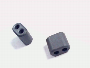

Just to try, install (in addition to the shielded cable, resistors and capacitor) a ferrite bead innmediately before the grid stoppers resistors
(Something like in Mesa amps that are without the grid stopper and uses the ferrite bead)

Hmmm, I didn't realize they made ferrite beads small enough for this.  I'll give this a try if I can find some.
You can find ferrite beads also in small format
http://www.budgetronics.eu/index.php?action=article&aid=19066&lang=EN
