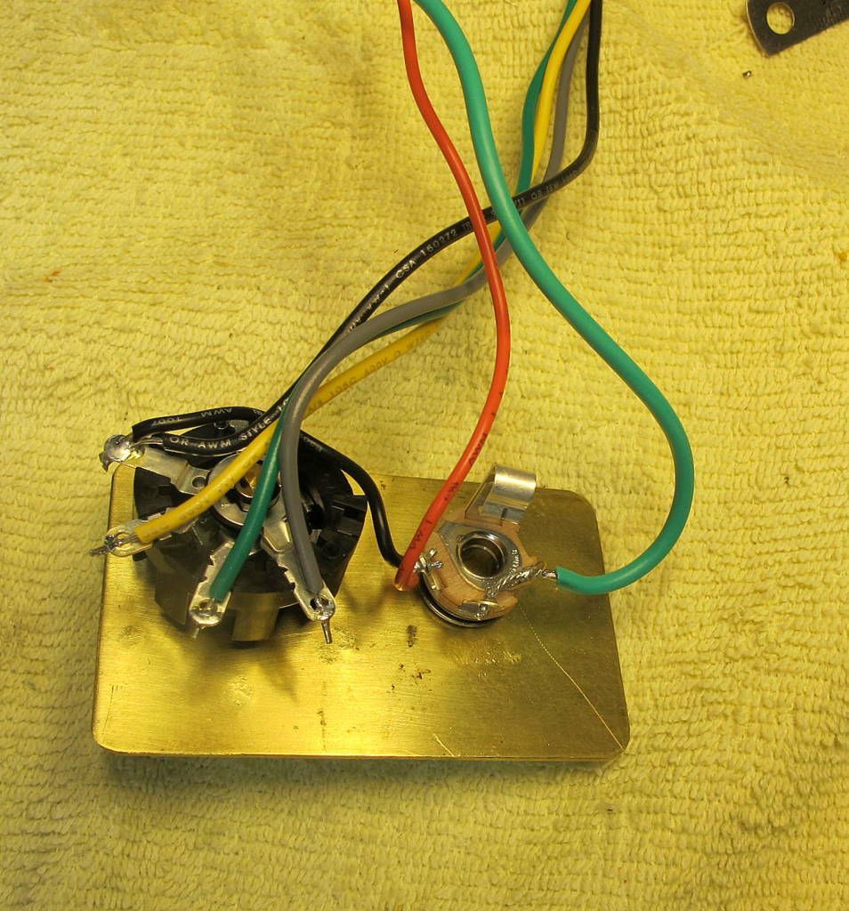

well, it's official - no sound.
no buzz, hum, hiss, squeal or gurgle.
bummer.
I've chopsticked it  - all looks correct.
here is my speaker switch wiring - this looks ok doesn't it ?
the black from the OT is "common" - I put that on the common switch pole, and jumped it over to the jack tip (with the NFB red).
yellow green and gray are the 4,8,16 ohm taps.
the jack green is grounded on the chassis.
my speaker cab has a non-switched jack, i.e. just a tip and and sleeve post.  That's not a problem is it ?
thanks for any tips..  Bummed.
Offline Paul1453
  • Posts: 1085
Re: 5F1 Build thread - by a first timer.
« Reply #53 on: March 10, 2016, 05:41:08 pm »
You grounded the tip?  Why?
You have a switched ground jack, the ground should be connected there not the tip.   :icon_biggrin:
OK, maybe I miss read your post.  But I would expect that black wire to connect to the green on the jack.
Double check your switch wiring.  Can you post the OT's switch wiring diagram?
Those other wires should be soldered better once you verify their connections.   :icon_biggrin:
You're close, don't worry you will get her done soon.
And it will sound great to your ears!   :icon_biggrin:

DON'T turn on that amp again, you have wired the OT as a direct short.  :w2:
Wait for someone to show you how to wire it correctly.
What OT do you have? We need to see the OT's diagram showing the wires and there colors.

« Reply #55 on: March 10, 2016, 06:53:57 pm »
I have the Classic Tone 40-18031 output transformer.
The schematic is this:
NOTE:  the red wire to my switch (photo in previous post) is NOT repeat NOT the primary red from the OT.
That red wire above comes from middle lug of my NFB pot - feedback circuit.
The red OT primary goes into chassis to pin8 of my rectifier.
The blue OT primary goes into chassis to pin 3 of my 6v6.
The brown primary is capped with shrink tube and goes nowhere.
The black wire exiting the top of the photo in previous post is the OT secondary "common".
The switch is a 1-pole 3 position switch
http://www.mouser.com/ProductDetail/NKK-Switches/HS13Y/?qs=sGAEpiMZZMvNbjZ2WlReYmUduk%252by82OaZkUdP2yPJTY%3d
You can see the wiper currently contacting the grey lug.
It rotates to the green & yellow and back again.
The lug with the black wires is the common - the wiper doesnt go to it.
With this info, have I still direct shorted the OT?
I did pass the dim bulb test, I believe.
Thanks!!!!
/mik

OK, i believe I see the problem now.
The black "common" from the OT should go directly to the jack ground.  And NOT to the switch.
Yes?
« Last Edit: March 10, 2016, 07:07:08 pm by Meteorman »
  • Posts: 10619
« Reply #57 on: March 10, 2016, 07:11:13 pm »
Yes?
Yes.
But where does that red wire and green wire come from/go to on the speaker jack?

« Reply #58 on: March 10, 2016, 07:12:38 pm »
Yes, I think if you swap the red and black wires on the switch, that may fix it.   :icon_biggrin:
Maybe not.  Maybe the red wire should go where the black wire is and the black wired should connect to the green wire on your jack.
The black jumper from the switch to the tip stays.   :dontknow:

Yes.
The red wire is my negative feedback wire.
It goes to the jack tip, as per Hoffman diagram.
The fat green wire is a wire I added and is grounded on the chassis.
I did this because the jack itself will not be mounted to chassis (and thus not grounded the normal way).
The jack will be mounted on a separate plate (the brass one you see) on my wooden head cab.
As soon as this Big 10 tourney game is over, I'll go move the OT black secondary to the jack ground.
It will join the fat green ground wire there.
And see what happens. Thanks so much fellas.
This is why they say don't do mods as a noob!
Ok, that's fine.
(Edit; that's wrong, see reply #66. Willabe)
That's fine too.
Remember to leave the black jumper from rotary switch to speaker jack.
« Last Edit: March 10, 2016, 08:25:23 pm by Willabe »

If the nfb is hooked to 4-ohm tap (yellow) on switch, wouldn't that result in no NFB when switched to the 8-ohm or 16-ohm taps? (Now see your edit above....)
So I swapped the OT black to jack ground.
We now have moderate hum.
Unfortunately, I also now have piercing, immediate-headache-causing high-pitched squeal.
Guitar strings did not register at all thru speaker.
I'm guessing this might be a lead dress issue?  or the NFB issue? but I'm all ears....
When I slowly turned up NFB pot during squeal, it got louder than started to break up bad - I didnt do much of that.
« Last Edit: March 10, 2016, 08:39:58 pm by Meteorman »

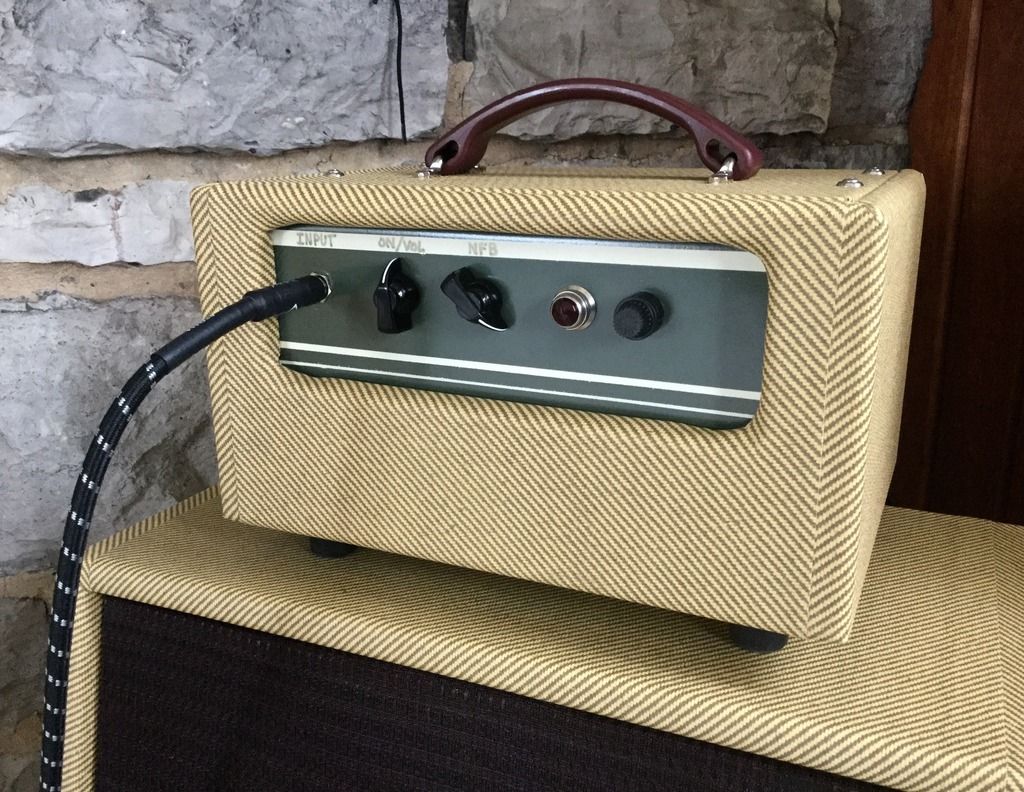

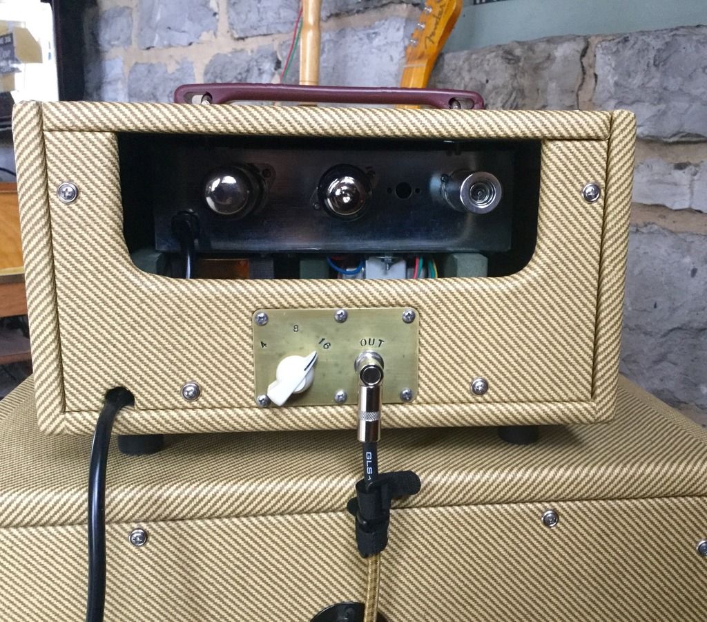

Finished up the head unit, except for a nameplate I'm workin on.
The speaker cab is a 1x12 with a Hellatone 25.
Thanks again for all the help!
