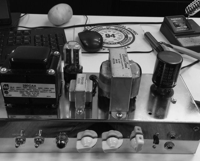

Before/after
  • Posts: 5281
Re: Birthday amp gone goofy
« Reply #3 on: April 20, 2016, 04:34:17 pm »
Offline lego4040
  • Posts: 917
« Reply #4 on: April 20, 2016, 05:01:36 pm »
pictures didnt load up, sorry
  • Posts: 5281
« Reply #5 on: April 20, 2016, 06:18:20 pm »
Can't tell anything from your pics. Read reply #1 again.

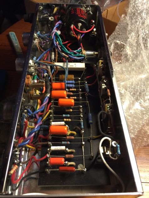

I was able to get the amp onto bench and open her up, I am looking at the PDF for Stout build online, have there been changed made? I don't remember that feedback resistor. This past year has been a nightmare both at work and home so I haven't been 100% there. I walked of my job last year after 11 years and went back to my original operations plant with some to work with good old friends. This past ten months have been awesome until yesterday's Enginners meeting, three of unofficially gave notice, my boss who's a great friend and fellow guitar player walked off the job and called it a day after this meeting and had to be physically held back during this heated argument with Mgmnt right before the engineers meeting. Sorry for the ramble but they literally threw the entire operations plant under the bus. II'll fire up amp tomorrow Steve
  • Posts: 5281
« Reply #8 on: April 21, 2016, 02:07:52 pm »
Looks like it. You may need to look at the older drawings. Didn't you keep a copy of the docs that you built your amp with? That would be a good idea. Hope you got the docs for your AC-15 also. Nothing lasts forever.   :icon_biggrin:

I got the Stout out and on the bench and I found one definite noise maker. I forgot to re-solder the Pilots 100 ohms back to ground  :BangHead: . I also have a question, I cant remember why I wired up the bridge rectifier this way but I didn't ground it cause I have the center tap? I have the two AC's going in and The B+  DC coming outgoing to standby. Yes the Power Tranny has a center tap for high voltage out and I think that's why I did it, Should I ground the bridge rec tab anyway and use both? or am I good. I read here on the info page that with the bridge rectifier grounded you don't need to have a center tap.

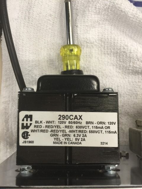

Instead of using V5(5Y3) tube rectifier I installed a bridge rectifier, I am reusing a chassis I had and I was short on space. I know Marshalls made both Solid state rectifier and tube rectifier amps. Thats why you only see four
  • Posts: 5281
« Reply #13 on: April 24, 2016, 09:04:23 pm »
Has this amp ever worked?
You cannot simply replace a 5Y3 with a bridge rectifier without making some other major changes, like different PT. Tell us exactly what you have done. Which PT. Schematic would be very helpful.

The PT is the Hammond 290CAX and the schematic is the original Hoffman stout build that was up[IMG[URL=http://s77.photobucket.com/user/legomaniac4040/media/Mobile%20Uploads/3F3D57BE-2DC1-40ED-BCE2-BF274E868A90_zpsvistvtkc.jpg.html]http://]http://i77.photobucket.com/albums/j72/legomaniac4040/Mobile%20Uploads/3FA55EEF-6E56-4B1D-9471-2900959B10F1_zpsiyqq7icy.jpg[/IMG][/URL]

Examine all the extra work you did after the amp was working. Compare to the layout and schematic. If you still don't find the mistake(s) then measure voltages on all tube pins. Post the voltages here. High rez pics may help also.
Offline lego4040
  • Posts: 917
« Reply #18 on: April 24, 2016, 09:55:11 pm »
the one problem I found immediately was I didn't re-solder the Pilot lamp 100 ohm resistor's.

... I cant remember why I wired up the bridge rectifier this way but I didn't ground it cause I have the center tap? I have the two AC's going in and The B+  DC coming outgoing to standby. Yes the Power Tranny has a center tap for high voltage out and I think that's why I did it, Should I ground the bridge rec tab anyway and use both? or am I good. ...
No, do not ground the bridge rectifier negative (-) lead.
You probably asked about the limited space at some past time, at which point folks noted that if you only use the "~" (a.c.) and "+" (positive output) pins of a bridge, it is exactly the same as having a regular solid-state full-wave rectifier instead of using the 5Y3.
Your PT is sized voltage-wise for a full-wave rectifier, which you now have. If you were to unground the PT high voltage center-tap and ground the bridge's "-" lead, you would get double the voltage output, probably killing all your filter caps. If you use the bridge's "-" lead without un-grounded the PT center-tap, you would short half of your PT high voltage winding, popping fuses at a minimum.
So you have that wired correctly as-is.

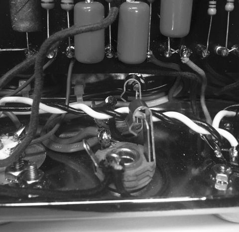

I don't see anything connected to the switch terminal on your jacks. If so, it it perfectly safe to use those jacks for multiple impedance taps.
Today I watched a new Uncle Doug video posted and I think I found my problem. I changed my output jacks to a new set I had and yep they were the shorting kind that Uncle Doug had mentioned in his video not to use on your OT, ITwill fry your OT.
Can you provide a link to that video?
Offline lego4040
  • Posts: 917
« Reply #23 on: May 02, 2016, 08:13:53 am »
Here's the link
At around 12 minutes is the part about grounded jacks

If using a multi-tap transformer and have a jack for each tap instead of a switch, then a shorting jack should not be used.  You would not want to ground any of the windings I would think.  Therefore it would be cheaper and better use of non-shorting jacks.
I prefer to use Stereo Switchcraft jacks for inputs and use the shorter as an additional sleeve connection.  Seems to make for a more positive connection and a solid feel.
Offline lego4040
  • Posts: 917
« Reply #29 on: May 02, 2016, 01:26:22 pm »
That is where my mistake was Steve, I have since made the correction and the readings I posted a reply back is what I found on my OT. I'll be firing up the amp tomorrow to test agin

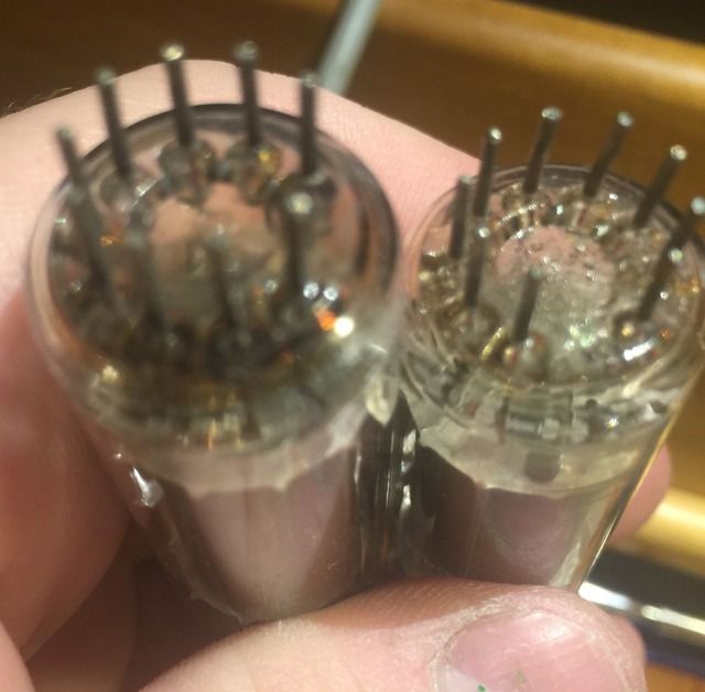

Bad news on the 6BQ5's I think, what I thought I heard is now visual proof
What do you think you see?
The best way to check a tube is to substitute a known good tube. If you don't have spares, I know you have two of those in that AC-15.
Offline lego4040
  • Posts: 917
« Reply #34 on: May 04, 2016, 05:11:36 pm »
 :sad2:  Those were out of the AC-15, the bottom of tube around the pins are all dark brown, I dont remember them being there before. Both tubes test 1.5ohms on the heaters. Gotta go witness a Fire Damper now with electricians,BrB.
Offline lego4040
  • Posts: 917
« Reply #35 on: May 04, 2016, 07:09:49 pm »
Well the tubes doesn't show any thing shorted out, only the internal connection between P1-P2 and off course the heaters which have a ohm resistance of 1.6 each tube. Ill slap them back in, test connections and fire it up again tomorrow.

Alright I'm stumped. I fired amp up, looked good at first until I took readings on V2 pin2 & 3. Firstly pin1 gave me a motor boat sound, p2 gave me 110 Vdc and p3 over 100vdc. My B+ went up to 359 too. I gotta go back to beginning and pull it all apart
Offline lego4040
  • Posts: 917
« Reply #49 on: May 16, 2016, 09:00:21 am »
I said was going back to square one and I did. I followed the link above and went over board/layout with a highlighter, all checks out good. I lifted one side of the leads so I can check under the boards for any shorts, all good. I got Reid off the bridge rectifier and put the 5Y3 GT tube in, I still need to wire it in. Then I need to place the can cap where it is shown in the picture.
