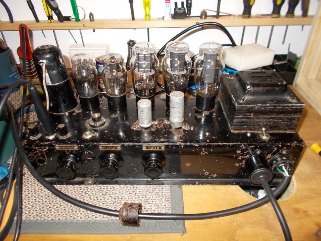

Hi guys, Trying to nut out some stuff that is a bit over my head.
I have posted this http://el34world.com/Forum/index.php?topic=19150.0
The original circuit was unknown and the new circuit is as close as I think it was, as some of the component look to be original with solder joints also looking original.
The power amp/phase inverter is working well as far as I can see, as the rectified voltage is close the RCA schematic provided.
Not knowing too much about the valves used I looked at the data sheet on the 6A6 and 6D6(preamp only)to get a ball park voltage to supply them.
I tried different value dropping resistors between nodes and didn't see much difference in the actual plate voltages on the 6D6.
The 6D6 has a max plate voltage of 250v and the supply voltage is 243v, but the plate are only seeing around 40v, with the anode resistor at 250k.
With these values the valve seems to work fine and sound good. :dontknow:
What is the relationship between B+ and plate voltage and the effect on the valve.
I am wanting to power an external preamp off this B+.
The preamp has 3x 6SJ7GTs.
The max plate voltage is 300v.
The typical voltage is 250v.
I'm thinking of tapping the B+supply off node "F" as I do not want to load the field coil too much.
This voltage will be around 470v and with a dropping resistor/cap to get the required voltes to the plates.
So what I am asking is......
6D6/6A6 :- If the max B+ supplied is 280v and can't be raised without reducing the up stream dropping resistors and risk decoupling.
And with the valves working well at these voltages has got me stuffed that they actually work.
6SJ7GT :- I'm sure if I could read "load lines" it would tell me the sweet spot the valve sits with the plate resistor value that is in the original circuit.
Otherwise I'll shoot for the "typical" voltage of 250v as per the datasheet.
Working off sheet 4

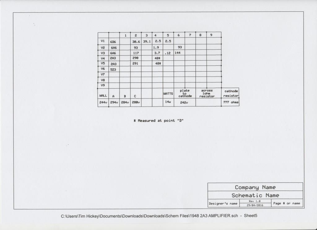

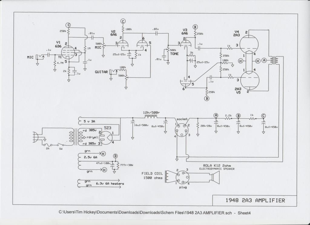

This is what we are looking at.
With the amp as is, I am blown away by the overall sound with both channels sounding great for guitar.

Thanks! But you didn't have to print/scan; Jschem can save the sch file as an image for your to upload.
The 0.12v on pin 5 of V3 doesn't look good... Are one of those coupling caps coming out of V3 leaky?
Anyway, 48v of bias on the 2A3's, so that's a starting point for calculation. From a 6A6 data sheet, I'm estimating rp as ~23kΩ at the operating point of V3. With a Mu of 35, amplification is about 35*250kΩ/(250kΩ+23kΩ) = ~32. Signal into V3 pin 3 should be about 48v/32 = 1.5v for max output.
At V2, rp looks closer to 30kΩ, so amplification is 35*100kΩ/(100kΩ+30kΩ) = ~27. Input to V2 pin 5 should be 1.5v/27 = ~56mV for maximum output.
The 100kΩ connected to the Guitar channel volume pot means full-up is only 5/6th of the input voltage, so input sensitivity for full power when the volume is full-up is ~67mV. So not bad, will probably stay clean except with hot pickups and volume cranked up.
For the Mic channel, the 56mV for max output still applies at pin 3 of V2. Given the input pentode will give a lot of boost, if the audio-taper volume pot is at half, that's an output of 1/10th the input signal, or sensitivity of 56mV/0.1 = 560mV.
The gain of the 6D6 is probably reasonably close to the 125 calculated earlier, so 560mV/125 = 4.5mV for full output. Screaming loud and into distortion at almost any setting (your guitar does have a volume control of its own, right?).
So what is the 3x 6SJ7 preamp supposed to be driving? It looks like your 2A3 amp doesn't need any help as it stands...

If you're going for a paraphase inverter, there is a resistor missing on the voltage divider going to the grid of the 2nd inverting stage. Try inserting 6k8 between the 250k (grid leak for the output tube side on the 1st investing stage) and the junction of the 100k/other 250k. Take the grid for the 2nd inverting stage from the new junction of the 250k/6k6. Take a look at the PIs in the early fender tweed amp schematics.
  • Posts: 2935
Re: B+ and plate voltage relationship
« Reply #5 on: May 01, 2016, 04:17:25 am »
Hey tubeswell, I did look at the fender schems for some ideas on the phase inverter and one of the local boys put me onto this.....
I thought if it's good enough for RCA then I like it. It also gave me a PSU design.

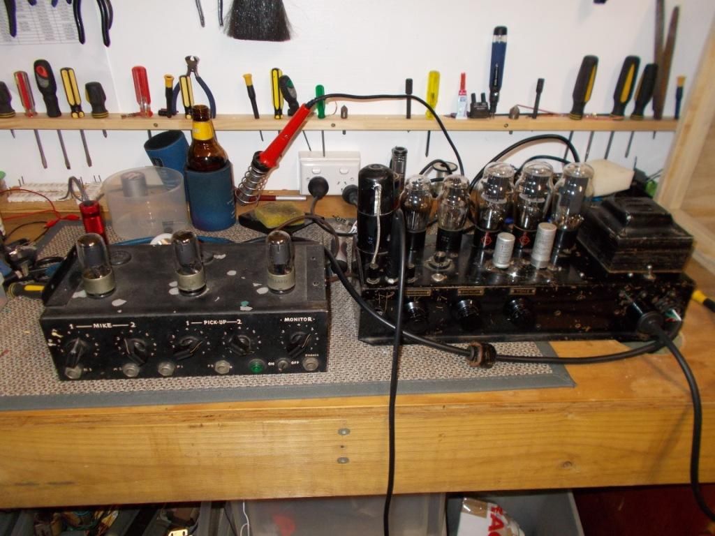

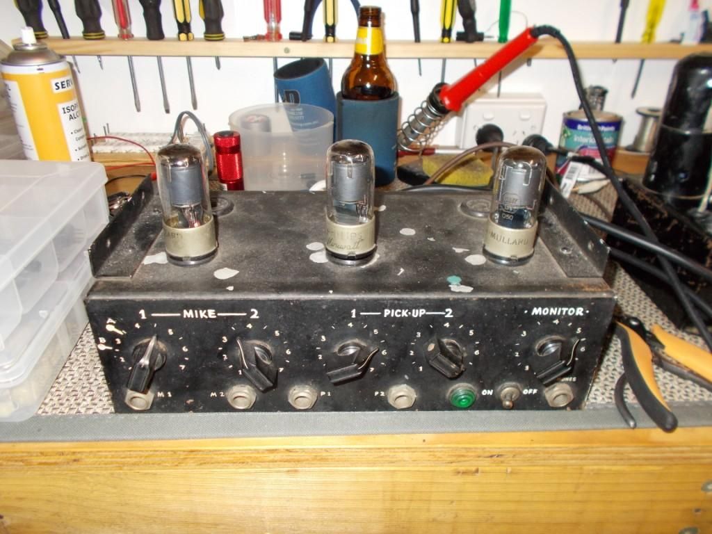

HBP, I have this...

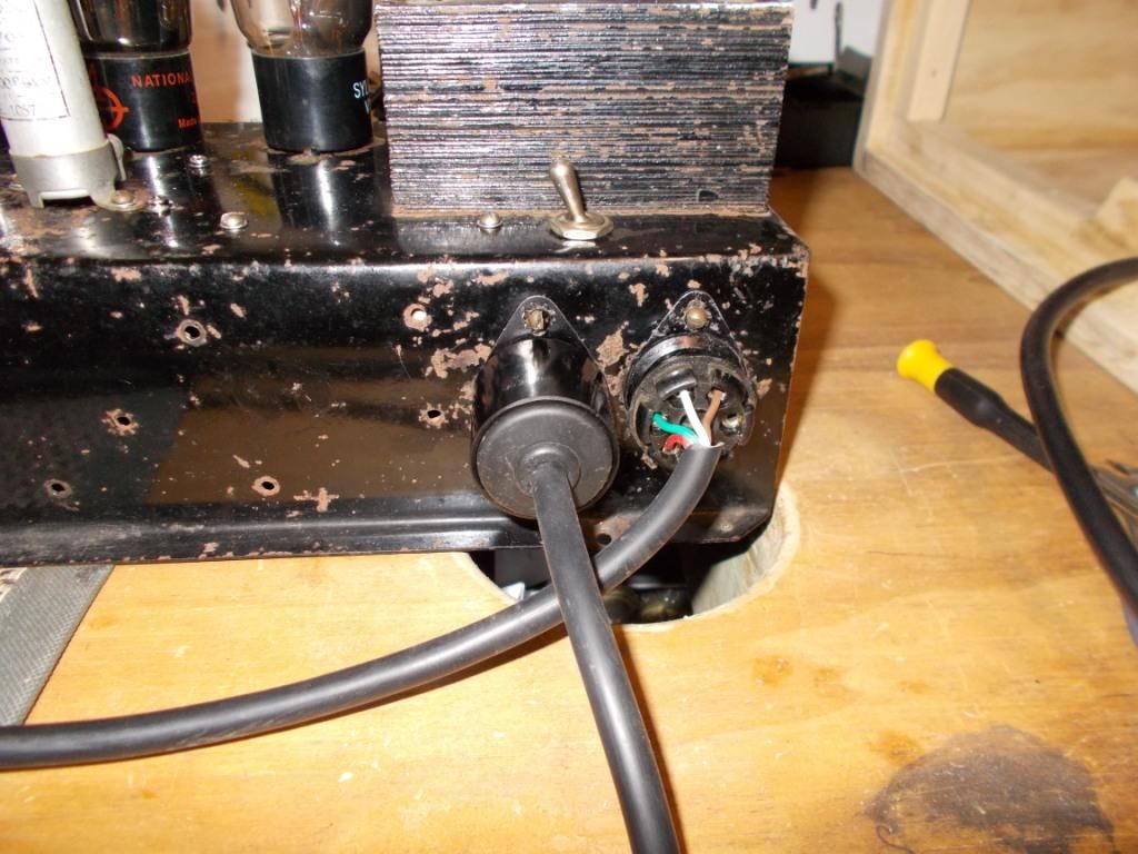

It's a preamp only, so its needs power and heaters.
It's the B+ I'm looking to tap off this....
It has a spare socket here........
One on the right.
So tapping the B+ after the choke and adding a dropping resistor to the required plate voltage for the 6SJ7gt's
I'm thinking I should be able to plug the preamp into the "guitar input" and use it's volume control as a master volume.
Yep, it's a variation of the self-balancing paraphase, using R12, R13, and R14. I'd also have to assume RCA has the correct values, and it appears Tim copied RCA's values accurately.
If correct/equal balance is sought, you could inject a test signal into the 1st triode's grid, and use a dual-channel o'scope to measure a.c. volts from 2A3 grid to 2A3 grid. One scope channel should be inverted, and the display set to sum the channels. R14 would be made variable, and adjusted until the scope indicated the smallest resulting signal (i.e., the 2 signals are most-alike, but may not null perfectly due to distortion).
Tubeswell, I can alter the circuit to this
You can, but that's the earlier, non-self-balancing paraphase circuit.
For a Fender example, look at the 5D5 Pro. Fender appeared to occupy a middle ground between the earlier circuit and the RCA version, as they used a 220kΩ and 50kΩ as a divider from the 1st triode's output, but a 270kΩ from the output of the 2nd triode back to the divider point.
Measurement/experimentation is probably just as fruitful as calculation for this circuit, especially since unbalance will probably contribute to output tube distortion.
HBP, I have this... It's a preamp only, so its needs power and heaters.
... So tapping the B+ after the choke and adding a dropping resistor to the required plate voltage for the 6SJ7gt's
Did my assessment earlier of the mic channel match your impressions of the amp?
If yes, then a gain of 125 is all you need to make the Guitar channel rock hard. I'm going to guess up front you can manage that with a single 6SJ7, so what will you do with the other 2?
Which made me wonder if that preamp chassis could be modified to be a complete amp by itself. Would probably take some tube swaps, adding provision for a power supply & output transformer, etc.
Or did you need 2-3 more independent input channels for the main amp's Guitar channel?

Thanks HBP,All your calculation has got me in awe.
The amp as is has great tone, even though the tone circuit has no real effect, changed the .01 tone cap to .005 with no effect and amp is fairly clean to full volume.
Again the amp sounds great and I guess that the valves are in a HAPPY place, I'll run the CRO over it latter.
The preamp in this case my be just an oversized pedal, with the use of one valve.
My intention is to use the preamp as a stand alone recording unit.
So a separate PSU unit that this preamp can plug into.
The PSU unit will also have a 48v phantom supply for a ribbon mic.
