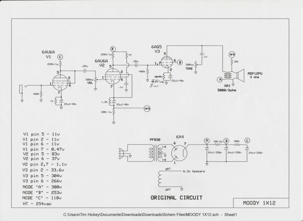

I searched the internet and couldn't find a basic guitar amp for my 2 most plentiful tubes.
So I patched a couple of circuits together and it is working on my breadboard.
I have some high frequency oscillation above 50% volume when I use higher voltage +280Vdc.
If I keep the voltage down at +180 there is no oscillation even at full volume.
This is working, and doesn't sound too bad.
Any suggestions for improvement?
I've got a bunch of 6DJ8s.  Would sticking 1 of those in the middle greatly improve the sound?
I'm trying to save my vintage 12AX7s for bigger better amps.

If you want to put on a 6DJ8 on the circuit .....
I'll try to use one triode as CF preceded by the 6AU6 and followed by a ToneStack (FMV) or may be a James
then the remaining triode as gain stage (arranged with an adjustable NFB) and the 6AQ5 Power Tube
6AU6 > 1/2 6DJ8 as CF > Tone Control > 1/2 6DJ8 as gain stage + adjustable NFB > 6AQ5
Something like this (or a DC coupled CF instead of an AC coupled CF)
The classic g-amp is triode-vol-triode-powertube.
Pent-vol is already prone to overload. It's a sound. Not an all-purpose sound.
Pent-vol-tri-tri-powtube would be way too easy to overload.
If you have far too many 6AU6, strap them as low-gain triodes. Or parallel 5 or 6 as a "power tube".

Oh, PRR remembered me I forgot to say one thing
In my option I was considering to use a low Plate resistor value for the 6AU6 as to tame the gain
or to feed it with a low voltage
............ keep all small signal pentodes at low voltages.

Re: 6AU6 6AQ5 guitar amp
« Reply #8 on: June 01, 2016, 04:13:11 pm »
Tubenit & Geezer give a try to the 6AK5 and told it is a good tube in guitar amp
the 5879 was better so they used the 5879 but here I've found a lot of 6AK5 on the cheap and only few 5879 (that were much more expensive)
so I think I wont to try it sooner or after
6AU6 is surely a good tube in guitar amp
and our friend TIMBO was engaged with this 1950 Moody amp
http://el34world.com/Forum/index.php?topic=19487.msg202001#msg202001

Wow!  Thank you very much, K!
I would have never thought I could get away with 2 6AU6s driving my 6AQ5!
So the 1st one the voltage is kept quite low.
The 2nd one hits it harder, but is tempered by NFB?
No tone control, but I like simple amps with not too many things to fiddle with.
Time to modify the BB setup to hear this one.  :icon_biggrin:

Yeah, the bootstrapped pentode is HI-gain. (Also about equivalent to the same pentode/triode as two cascaded grounded-cathode stages.)
For low gain in a pentode, put the screen WAY up (even to 300V) and increase the cathode resistor to get current within reason (so a reasonable plate resistor sits around half-way up B+). Very low G2 voltage (~~40V) lead to high gain.
In a bitsa amp (bits of this and bits of that) where power economy is not a big deal, work the pentode at very high current. Like 15K RP and 10mA current. Gain drops roughly as square-root of current. A 10mA design gives ~~1/3rd the voltage gain of a 1mA design. (And hardly needs a buffer behind it!)
