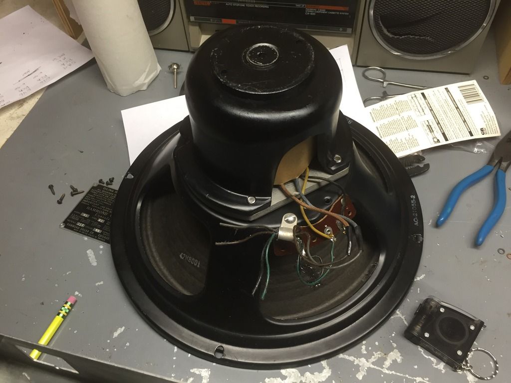

The schematic shows you have a field core speaker as part of your PS.
This is not part of the normal 6V6 Plexi PS.
If you have the FC speaker and it works well,
you could probably modify the Plexi PS to keep it.
I modified my 6V6 Plexi PS and used +325VDC for my B+,
This PS is even less than that.
Doug's plan has over 400V for B+ I think.
If you want to get all the power you can out of the 2 6V6s,
then they normally jack up the voltage well above 400V.
I like to run my vintage tubes a little more conservatively.   :icon_biggrin:

Yes, I do have the field coil speaker and I assume it works... I had to repair a few tears with some hot glue.
As for my vintage 6V6's, I'm not looking to get the most out of them. Just looking for good tone that isn't TOO hard on them.
At this point, I am thinking that I'll keep this schematic and just run with what I've got.
By looking at my schematic with the bubbles and lines on it, am I thinking right, that the ones indicated connect together?

I've been busy this week!
If you recall, the amp design is going to look something like this (I modified it a teeny bit):
So, here's the almost done front panel, rescued from the original organ (need to cut out the portion where the chassis will be):
And since the chassis had lots of holes in it and I needed it to look pretty, so I cut out some pieces of sheet metal from other unused parts of the amp and JB Welded them into place and then sanded it real smooth. The marks you see on the front of the chassis is where I'll be drilling holes for pots and switches, etc.:
Chassis front (upside down):
Disregard the messy work bench and dig the 1983 boom box which still works, by the way,  but only as a radio. Blasts out Classic Rock only!
Back:
Altogether, I'm very happy with how the project is coming along. I'm re-purposing many of the original organ stuff and also re-purposing a lot of other stuff I have collecting dust in my garage.
