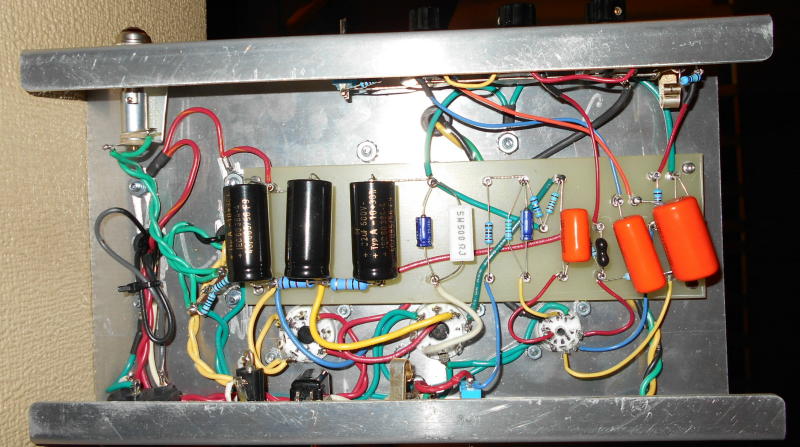

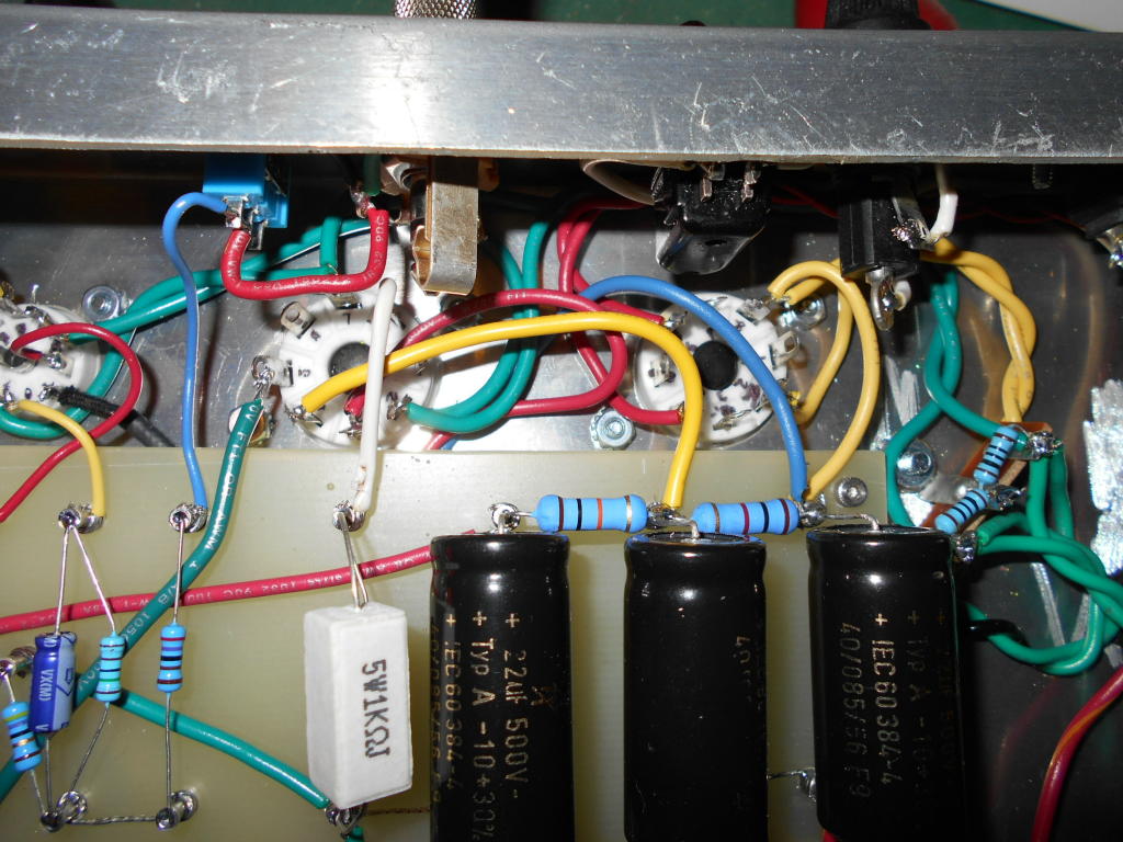

can you post a picture of the PS end (6V6 and 5Y3 and circuit board) ?
Probably wouldn't hurt to put a 470 ohm 1 watt resistor on the screen grid to get the screen voltage lower than the plate.
« Last Edit: June 25, 2016, 01:52:40 pm by mresistor »
Offline rlh5599
  • Posts: 61
Re: New BF Champ-type build Q's
« Reply #5 on: June 25, 2016, 03:46:42 pm »
So, just so I have my terminology correct, a 470 ohm resistor on pin 4 (grid) of the 6V6, correct??
and here's a pic:

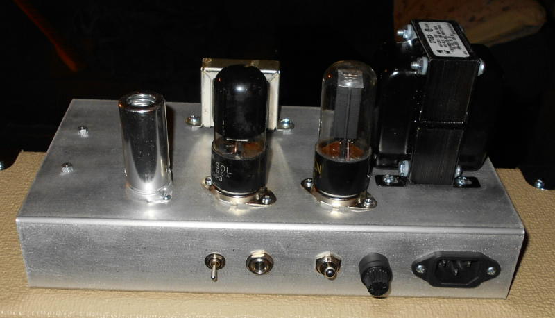

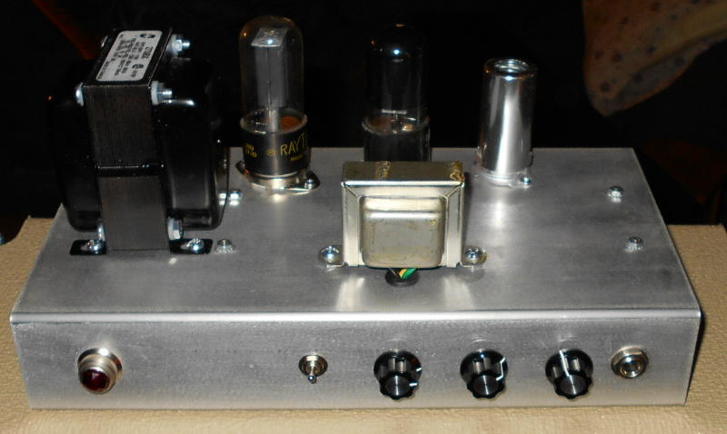

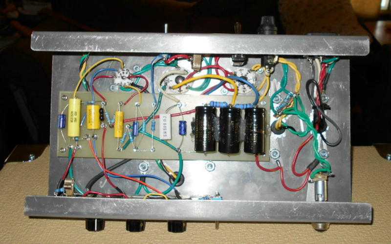

Gratuitous pics..
