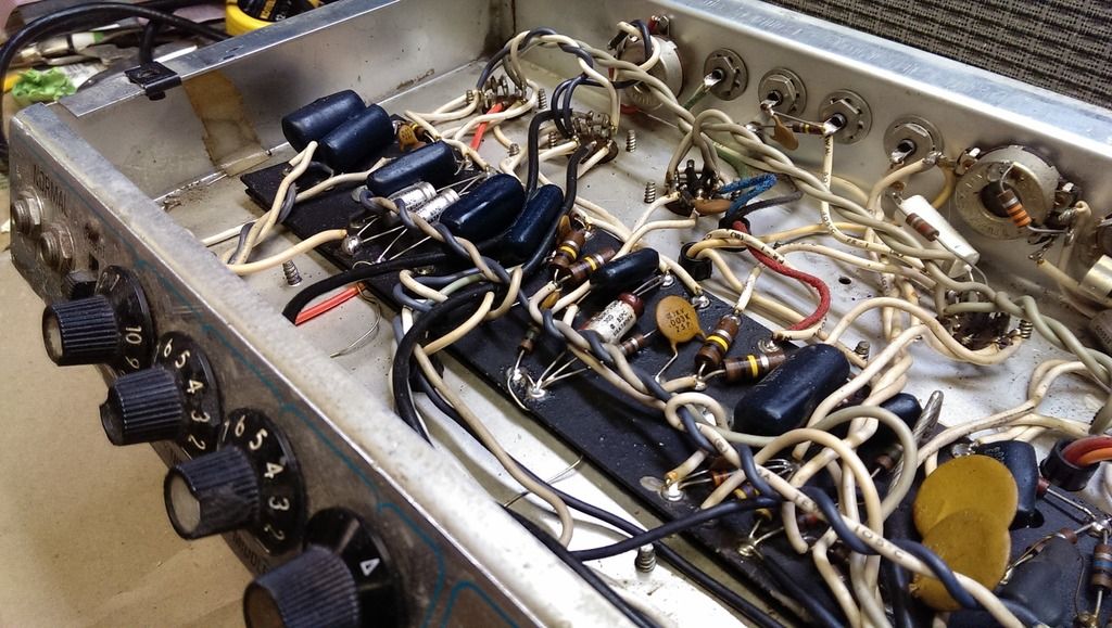

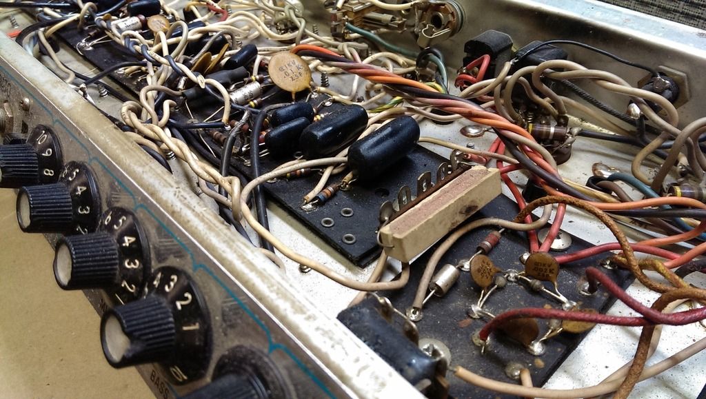

ok I opened her up last night and got a ton of pics. I also noticed at least one chassis ground which is busted loose - that will be my first fix. This amp lived a hard life before I got it, as you can see from the "wang" the faceplate has. This seems like an opportunity for something to ground out. I can say that the amp played very nicely when I tested it out before I bought it. I build a new cabinet for it (treating it very delicately) and worked on correcting some of the damage to the chassis at the same time (also delicately) - and now it has the gnarly bass sound / hum. Thanks!
Photos:

while poking around in there I noticed a bundle of wires electrical taped together? (pic #5) I don't see a switch on the MV pot either? Did someone already disable the pull-gain?
  • Posts: 5394
Re: Fender MV Twin Help.
« Reply #10 on: July 28, 2016, 01:56:03 pm »
Looks that way.

Before I started swapping pots I decided to look at some easy and obvious stuff first. I unwrapped the electrical tape bundle and saw that they were attempting to isolate all of the wires but they all looked to be touching/shorting to each other. So I was incidentally getting some of the unwanted gain boost. I heat-shrink insulated all of the wires.
Then i started inspecting the tubes and found this. Must have been banged in transport (reverb tank was loose in the original cabinet.)
I luckily had an ECC83 sitting in a box from a previous project, snapped it in and we're back in business!
Thanks again for all the help.
