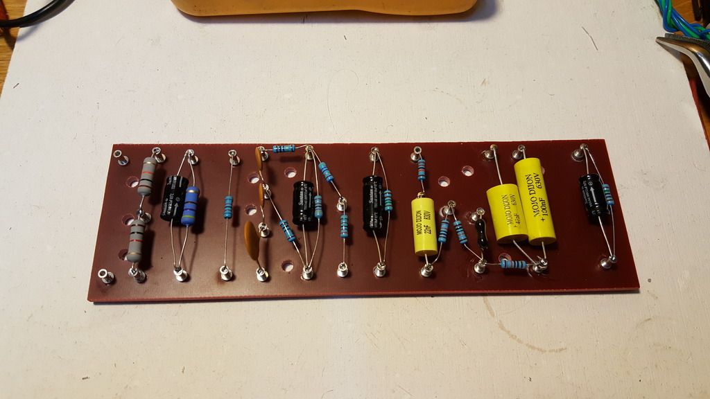

Alright so I whipped up a little layout with the 1 tube reverb shoe-horned into the VC layout I've been looking at using.  The green lines are going to be behind the board and I changed a few values of the reverb circuit based off Tubenit's modifications suggestion image from the original post.
I know the picture is manure, but I put the reverb component in brackets and its following VMS's idea there of taking the signal before the tone stack and then going back in after the volume pot.  I downloaded ExpressSCH and EL34's tube library of components.. so I'm going to try and redo it with that to make it look better.
-Brett
P.S. - I didn't show the wiring on the left side of the board because it's unchanged from the standard VC layout :)

What is that 100K resistor next to the 500pf Cap.?
That's the resistor you parallel across the circuit "in" and "out" as per the schematic.

The VMS scheme doesn't use that 100K resistor.  The tone stack takes the place of it.  It would have high DC on it the way it is drawn.

Ah I see, you are correct. Thank you sir!  I will ammend my drawing, that's why I used pencil for this one!

I would recommend that you hook the driver to the second (340V) node on the power supply and the recovery to the third (320V) node.  If you hook it up like this, the 340V node will drop about 3V and the 320V node will drop about 13V.  If you hook the driver and the recovery to the 320V node, it will drop it about 33V.
If you have a smaller resistor like 1K to use for the driver cathode resistor, it would be better.  The 1.5K biases the driver too cold so that the cut-off clip limits how much you can drive the tank with clean signal.
« Last Edit: September 05, 2016, 01:25:15 pm by 2deaf »

Ah, yes the tweaks shown by Tubenit have changing that to 1k stating more gain when used with a 22-25uF cap.  The original has a 10uF and 1.5K ..  Makes sense.  I'm learning a lot about how this stuff works by screwing around with this.  That was the plan.  Thanks again for the help!

I didn't recommend a 1K cathode resistor for more gain.  The difference in gain between 1K and 1.5K is minimal.  The difference in clean headroom is significant.  You can put something like one and a half times more clean ma's into the tank by changing the 1.5K resistor to 1K.  This is because it takes more negative input signal to put the tube into cut-off clipping with the warmer bias created by the 1K resistor.  Since the gain doesn't change much and you can use a larger signal with 1K,  you can drive the tank with a larger clean signal.
If you keep going and use an 820 ohm resistor, you can use an even larger negative input signal but grid clipping of the positive input signal becomes a limiting factor.  Actually the grid clipping starts to limit even with the 1.5K resistor when you get to higher frequencies, but these are outside our range of interest.  Grid clipping with an 820 ohm resistor is a problem with the frequencies in our range of interest.
When I talk about clean signal, I mean non-clipped.  Oblong, rounded, unsymmetrical, or non-centered signals sound fine to me when driving reverb.  Clipped signals are unacceptable to me for reverb drive.

Alright, so here's the board drilled out, turrets placed, components placed:
and then I ran some of Doug's fine vintage Fender wire around, Still waiting on my Transformers from Triode!  They shipped Yesterday, 3 weeks after I paid for them.  I guess that's how it goes!
This is really my first proper "Turret board" as the one I made for my P1 was super ghetto and I just kind of built it out of crap I had on hand.
I got some nylon standoffs from ACE and I'm going to use three 10-32 bolts and the nylon risers to keep the board off the deck!
I just need my transformers now..  I guess I could twist up my heater wires while I wait!
-Brett
PS --   Do I have those Mojo's hooked up correctly?  The end that doesn't have the + on it goes to the pot and then to ground based off the schematic (both).. the 0.022 doesn't have a polarity marking.  So I'm not sure there.
« Last Edit: February 02, 2017, 04:37:44 pm by BetterOffShred »
