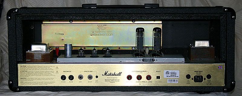

The makeover has begun.
I may adjust the center plate to get the tubes closer to the edge. Cutting the plate and soldering it flat to the chassis, this way I will not have to play with 2- level standoffs. Will see...
I did a few quick layout mockups.
This JTM50 is going to be my reference.
Looking at the DSL50 schematic I see another class X cap. Do I really need one in my JTM50 build ? Does it have to do with the dual primary transformer ?

Two level standoffs are easier then metal work . . .
Re: Cannibalizing a DSL 50 to make a JTM 50
« Reply #23 on: November 28, 2016, 03:18:57 am »
You are not bound to solder something to the chassis to have a flat surface, cut an adequate aluminium sheet (2mm thick) and fix it on the top of the chassis using rivets, it is very simple and sturdy

« Reply #24 on: November 28, 2016, 12:36:29 pm »
This is a great & simple idea, thanks. I was focusing on the center plate and how it was handy that the holes were already drilled, plus one of my uncle is pretty good at arc welding. And I always borrowed tools from him. Anyhow, I figured a step drill would be amortized so I ordered one.
In the meantime I ordered taller standoffs. :laugh: Though I think the board would be too close from the pots.

It's alive !!  :worthy1:
I put the preamp tubes then the power ones.
I played it for 90 minutes. No sparkles, no smoke.  :icon_biggrin:
B+ is down to 480V DC; I set the bias to 37.3 for V4 & 36.2 mA for V5.
I measured 340V DC at pin 6 of V2. Is it risky ? That's the only voltage that is extreme.
PPIMV seems to work fine.
I do have a concern with the Bright volume. ( I have no experience with 4 holer ) When I'm plugged into the normal channel, the bright volume adds a fair amount of noise.
Tomorrow I'll swap / change the preamp tubes.
