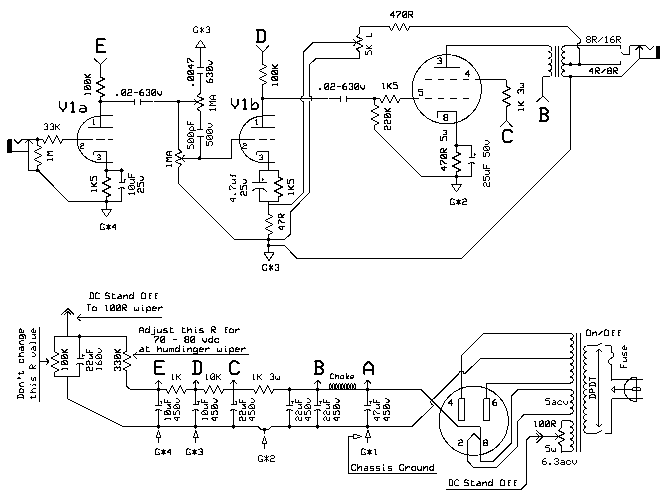

I'm ready to wire this amp up, eyelet/turret board is made and installed in a tweed Princeton 5F2A clone chassis I bought from Doug. I have Doug's Princeton Reverb/Vibro Champ PT and Fender 6L6 choke for an extra B+ (cap/choke) filter node before B+ power tube plate/OT.
But I have a question or 2 about what value NFB R to use.
The OT I'm using is an Allen Amps (Heyboer) TO11S, SE 10w with dual primary/secondaries of 8K/8Ω/16Ω and 4K/4Ω/8Ω. The 8K is for a 6V6 and the 4K is for 6L6GB/GC, EL34. I put in a SPDT switch next to the speaker jack to flip between them.
I want to be able to use a K bypass cap on V1B so I'm using the NFB loop from a Vibro Champ, AA764.
HBP posted the math for changing the NFB series R value when you change speaker taps.
I get this;
4Ω tap; √(5w x 4Ω)= 4.47v   8Ω tap; √(5w x 8Ω)= 6.32v   6.32v/4.47v= 1.41v   2,700 x 1.41= 3,807
Is that correct if I go with the 8Ω tap for the NFB series R? Nearest stock R value 3K6?
Second question, will I need a different NFB series R value when I switch the OT primary from 8K to 4K? Or will the ratio stay the same?  (Dual primary/secondaries;  8K/8Ω/16Ω and 4K/4Ω/8Ω.)

You know, at this level I would *really* think about the NFB interaction with the specific *speaker* system. Not any abstract math. (Which I can do, but I think misses a point.)
Plainly the amp will "run" with any value from infinity to a few hundred Ohms. Wide open may be rude and undamped. 200 Ohms very tame and highly damped (by guitar-amp standard).
Use Leo's value. He was not dumb. However he knew what he was selling ("less than a DeLuxe") and what cabinet and speaker he had in mind/stock ("cheap and OK") and tuned the NFB for that and the musicians he worked with. When you have *your* speaker (venue, genre) selected, fiddle the resistor value to taste.
Or just put in a pot. Adjust to suit. Suit the speaker, the venue, the genre. Really more useful than an on/off switch.
If "off" is your Solo mode, do the switch also. Don't worry about the 47 ohms, it has essentially no effect under a 12AX7 cathode.

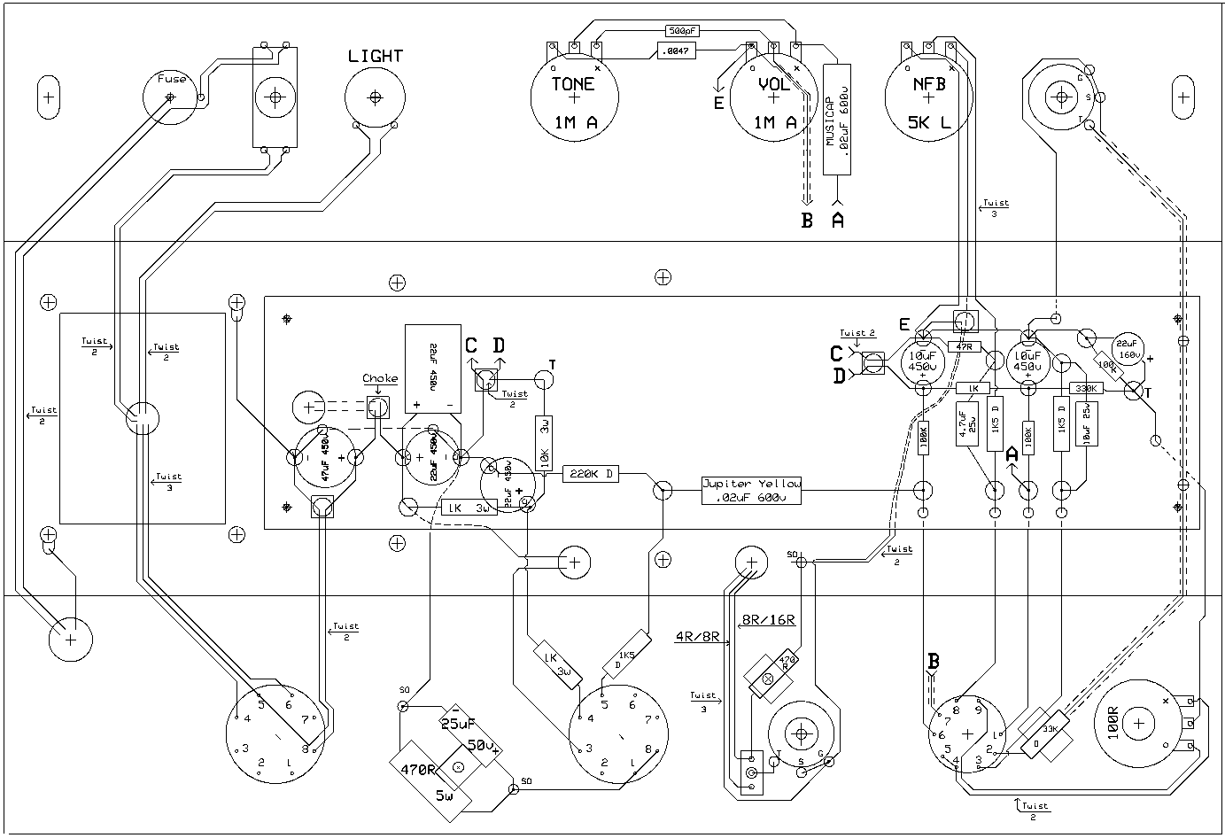

Here's my layout, I'm not sure it will work with the NFB pot by the input jack.  :dontknow:
Not many choices with this little chassis.
« Last Edit: November 19, 2016, 09:34:12 pm by Willabe »

do the primary/secondary ratios stay the same for choosing a single NFB series R when switching from the 8K primary tap to the 4K primary tap for a 6L6GB/GC?
I'm thinking no because the acv at the secondary would be higher using a 6L6GB/GC on the 4k to 8Ω.
you can follow Marshall's lead, his amps had 4/8/16 switches and he always used one tap for the nfb circuit, regardless of speaker tap selection.  Sometimes the 4ohm tap, often times the 8ohm tap.
because you are switching between 4/8, the 4K load doesn't change.
Re: New build NFB R value with dual sec. OT? Princeton 5F2A
« Reply #5 on: November 18, 2016, 12:50:23 pm »
Yes, this I understand. It's because the NFB loop always see's the 1 secondary tap it's wired to and that tap always has the same acv present no matter which secondary tap you hook up a speaker to.
But if I don't change the speaker load but do change the primary load and power tube type then what? This is where I'm confused.
With a 6V6, 8K load, on the 8Ω tap there would be a different acv present then with a 6L6GB/GC, 4K load, 8Ω tap, right?

Here's final drawings.

Maybe try reducing B+ filter values.  Yours are higher than stock; much higher in the 1st 2 filter stages.  Sometimes there's magic in 8uF, especially in the last filter stage (1st preamp stage).

But do the primary/secondary ratios stay the same for choosing a single NFB series R when switching from the 8K primary tap to the 4K primary tap for a 6L6GB/GC?
They stay the same (when using the same tube for the same output power); at least, the voltage at the single tap the NFB is connected to stays the same.
But it looks like you're talking about swapping tube types, more output power.  So voltage at the single secondary tap will increase.  More NFB.  PRR's variable NFB idea has a lot of merit here.  In fact, seems you might not much care for NFB with this amp at all...
