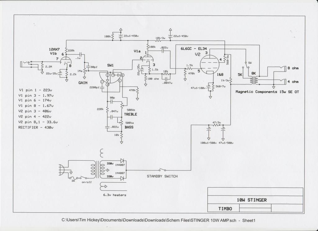

Hi guys, Would running a single 6L6 at approx. 450v too much for a single ended amp.
Using a SS rectifier.
http://www.mojotone.com/transformers/Fender/Power/MT-FENDER-MOJO760EX.pdf
OT
http://www.classictone.net/40-18031.pdf

Should be good. GE rates their 6L6GC for 500 at the plate, 450 at the screen. So does JJ with theirs.

« Reply #2 on: December 05, 2016, 02:35:30 pm »
OT
It should work no problem.
25w / 450v = ~56mA
400v / 56mA = ~7.1kΩ (8k oughta be fine)
Might as well cathode bias, and the voltage across the tube will be reduced by the amount of bias voltage dropped across the cathode resistor.  Ideally, you'd like to have a lower screen supply voltage so the bias voltage can be smaller, and therefore the 6L6 will be easier to drive.

Ciao TIMBO
can you explain the purpose of the 470K resistor ? Is there as to act as a grid leak resistor for V1a ?
  • Posts: 13201
Re: High Voltage 6L6 SE
« Reply #5 on: December 06, 2016, 11:34:06 am »
It's a grid leak/reference for the output tube, and an a.c. load for V1A.
You've got to tie the output tube grid to a voltage reference for it to have stable bias.  In this case, the voltage reference is 0v ground through the 470kΩ.  Grid current is extremely small, so no d.c. is developed across the 470kΩ and both ends are at 0vdc.

Ciao HotBluePlates
I was talking about the 470K resistor that is between V1b and V1a when the TS is excluded using the DPDT switch
I'm not sure 100% but seems you are talking about the 470K resistor that is between V1a and the Power Tube

That 470K is the grid leak for V1A.

« Reply #8 on: December 06, 2016, 02:18:22 pm »
I see...
When that section switches to have the 470kΩ to ground, the other section switches in a series 2200pF cap.  So V1a can't use the Volume pot as its grid reference (there's a blocking cap in the way).

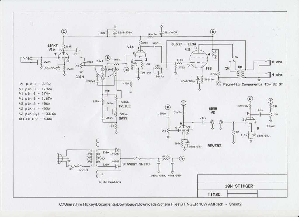

Ciao TIMBO
If I'm not wrong, seems that on the original schematics there isn't the 5K / 8K OT option that is present on your schematic ....
what do you expect from that commutation ?
Ooppss, I think I've understand, is there to swap between 6L6 & EL34 tubes

I might try something different to the usual one tube reverb (12AX7 and coupling transformer)
Found this
http://el34world.com/Forum/index.php?action=dlattach;topic=17010.0;attach=42975;image
Just happened to have parts.
  • Posts: 2928

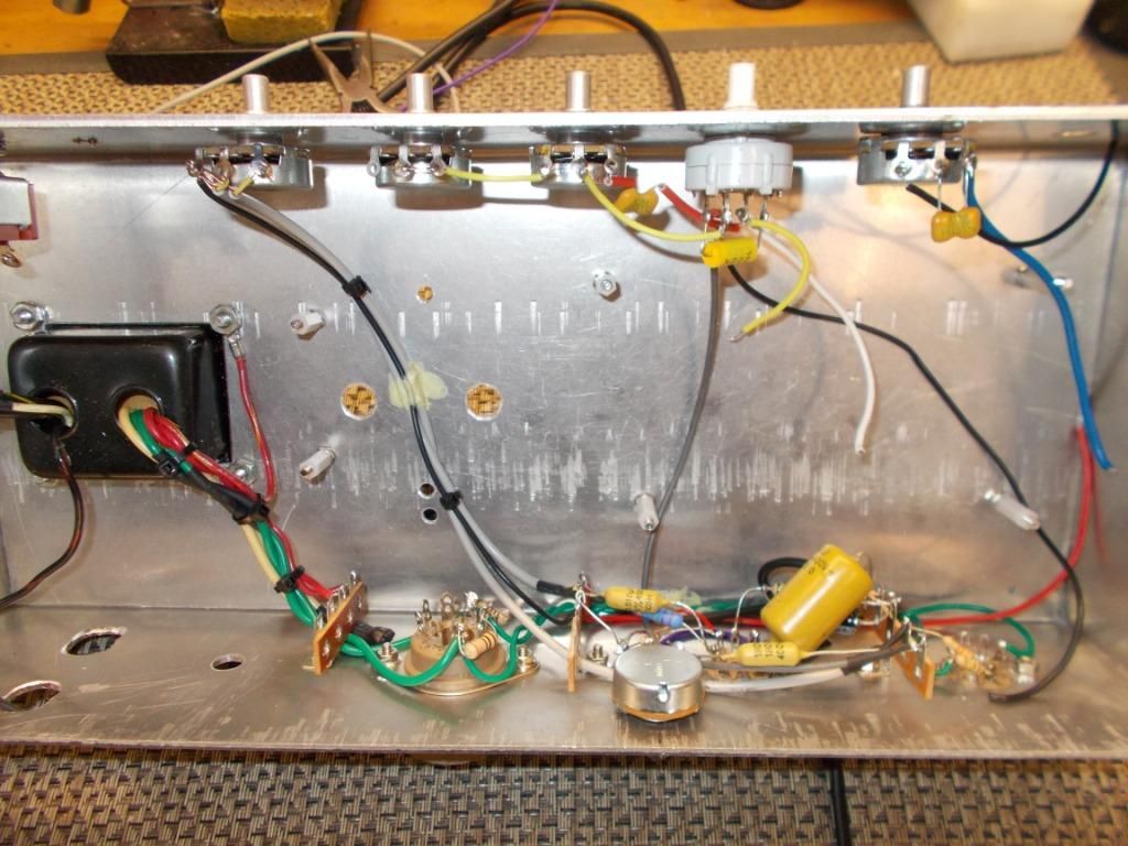

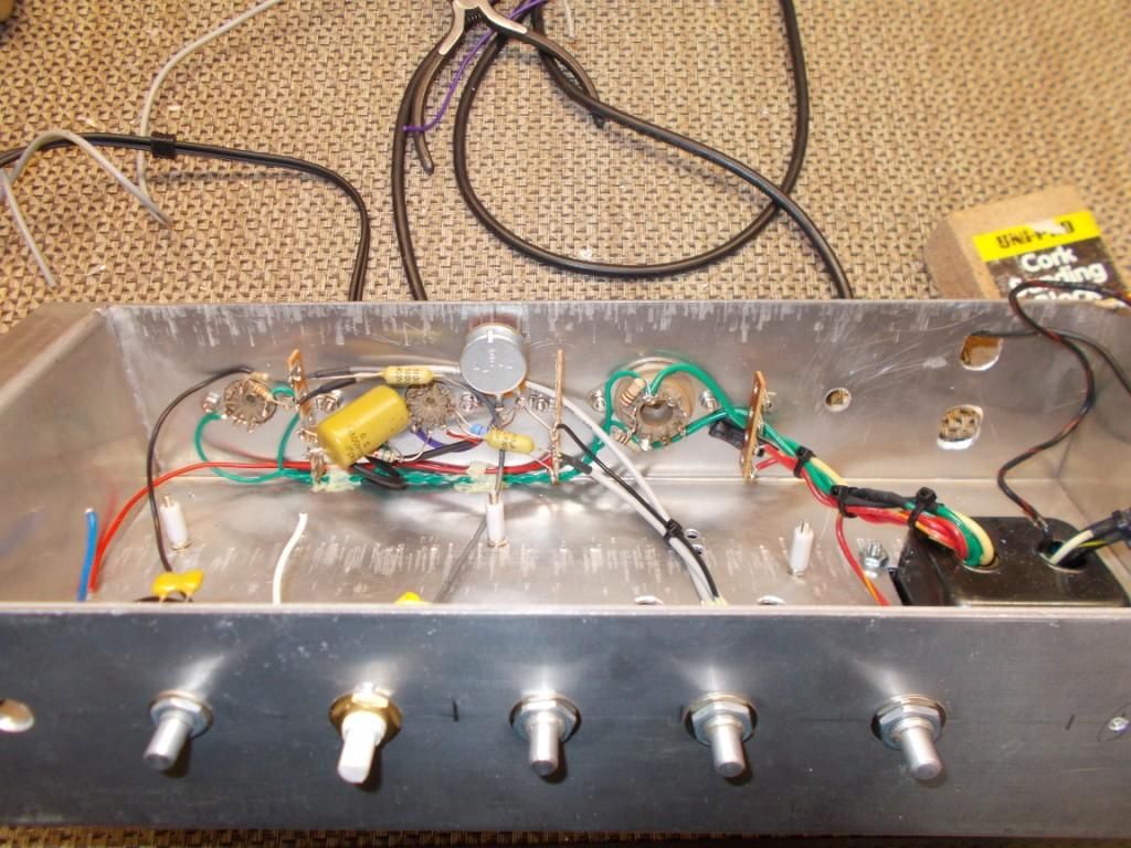

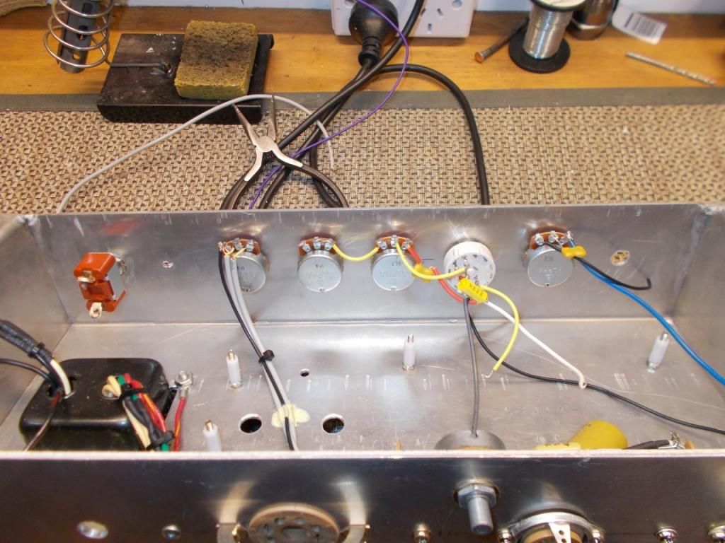

Hi guys, Some progress.

« Reply #14 on: December 10, 2016, 03:25:13 pm »
Nice!, did you do a copper etched pcb with turrets?
  • Posts: 2928
« Reply #15 on: December 10, 2016, 03:41:06 pm »
Hey shooter, This was the original project that I made this board for.
http://el34world.com/Forum/index.php?topic=10554.msg96816#msg96816
My method of board construction was limited to the materials I could get.
It seemed at the time a good idea. :dontknow:

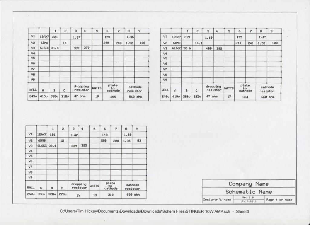

Hi guys, need a bit of direction.  :help:
As I expected the voltages are higher than what the original Stinger would be.
This is making it difficult to bias the 6l6.
With the plate load of 8k I have increased the cathode resistor to 660r (560 and 100 resistors in series) and this brought the power output down to about 19w, with the original 560r output was 25w.
I increased the 47r resistor between the first two filter caps to 1k, I'm now down to about 16w.
Do I continue to increase the cathode resistor or increase the 1k resistor ???
« Reply #23 on: December 11, 2016, 01:49:26 pm »
> output was 25w.
Measured how?
You certainly did not have 25W of clean sine power output with one 6L6.
For 8K load, take cathode resistor in the 600-800 Ohm range. Then fiddle B+ dropper to, as Shooter says, find "a compromise between voltage, current, and resistance" and hit your safe plate dissipation.
When done, voltage *across* the tube, divided by plate current (~= cathode current on 6L6) should work out very near 8K, the load. +/-20% is all the same, +/-40% is not wrong.
« Reply #24 on: December 12, 2016, 01:39:30 am »
Thanks PRR, I thinking that the 6L6GC I had, measured 25w may have been a bit dicky.
Put in another RCA 6L6GC and these are the results.......
Top left, circuit as per original schematic
Top right, cathode resistor increased
Bottom left dropping resistor between first two filter caps increased.
I used the weber bias calculator to calculate the output wattage.
http://www.tedweber.com/webervst/tubes1/calcbias.htm
Offline frus

  • Posts: 13201
« Reply #26 on: December 12, 2016, 09:38:18 am »
PRR was only getting at the fact you were calculating idle dissipation not audio power output.
This is also why I asked about which version of the 6L6 you would be using.  Assuming a suitable load, idling at/near 100% for the later types lets you use a smaller cathode resistor and (more importantly) a smaller bias voltage which implies the output tube is easier to drive to full output.
  • Posts: 2928
« Reply #27 on: December 12, 2016, 01:19:30 pm »
Thanks guys, with PRR's calculation all the variations fall within the 8K +/-20%
