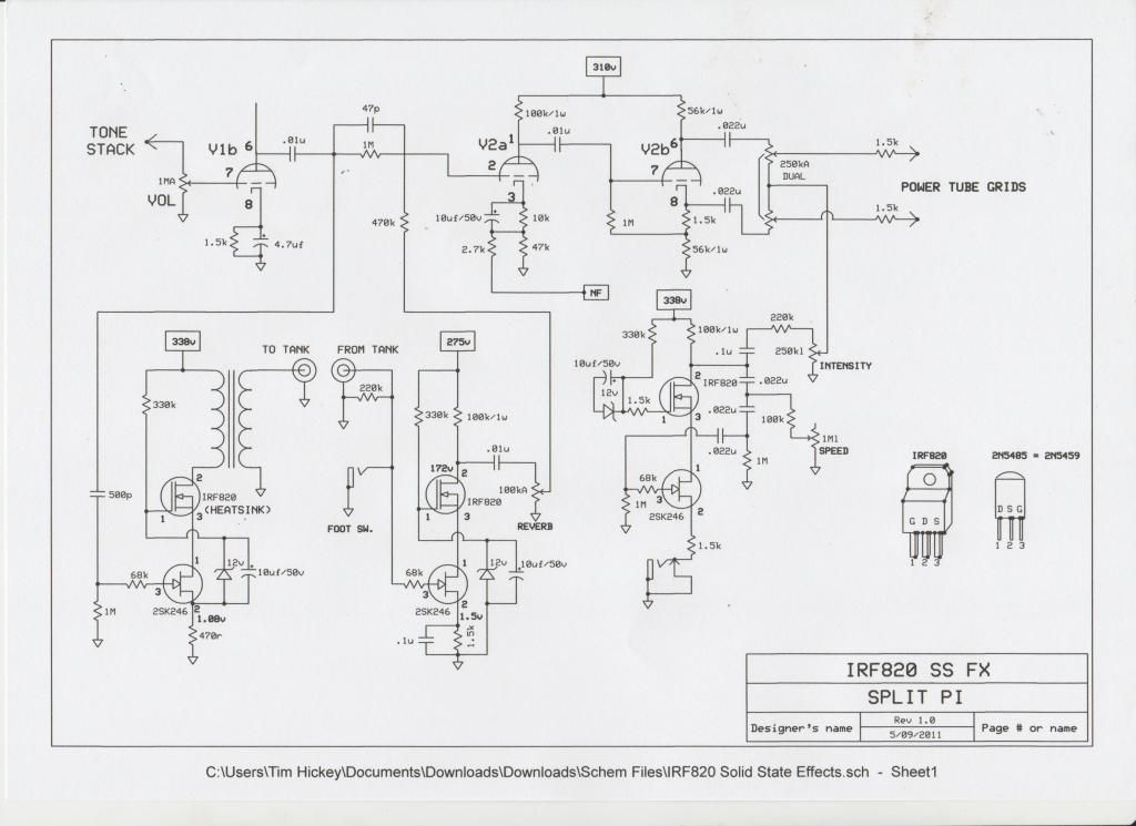

The more I look into this amp, the more issues I have uncovered. Sluckey was correct in that the cap for the 79 tube should not go to ground. The shielded cap wire was soldered directly to the cap at some time in the past therefore, the wire inside is grounded to the shielding.  Have also discovered another 2 wires which have been removed or cut. Also as PRR observed, a new multi-section cap was added also sometime in the past. With all of the wires that are removed it is very difficult to try to draw a schematic. Have scoured the internet for a schematic with no luck. The closest I came was this article: https://www.vintageguitar.com/20982/national-dobro-6107a/ which shows the inside of what looks like an un-modded Dobro amp. If you look closely at the shielded cap wire, you can see that the cap is not grounded. Anyway, I will get with the owner to see how much he wants to put into this and if he feels it is worth restoring. Thanks for everyone's observations and tips and will provide any updates.
Offline dpm309
  • Posts: 539
    • Matthews Amps
Re: National Dobro Amplifier
« Reply #16 on: January 01, 2017, 12:31:43 pm »
Right after I posted, I did one more search and lo and behold I found the schematic.  Now I have something to work with. As you can see, the PT has 4 secondaries, 2 of them for the filaments - 2.5 and 6.3VAC.

There is also a missing transformer that connects tube 56 and the pair of 2A3s. See picture below that I got off of one of the National Dobro websites and compare with picture NatDob3 up above. The schematic does not give any values or type. It looks like it is acting as a PI.  What can I use in it's place?
« Last Edit: January 01, 2017, 02:01:44 pm by dpm309 »
« Reply #18 on: January 01, 2017, 04:54:34 pm »
There's a lot of irons here.
I assume the OT is on the speaker? Field Coil there of course.
The big chassis-hole lump must be the PT? (Lots of leads.)
Chassis lump next to it logically the main choke? (2 leads).
That leaves your internal transformer as the "missing" interstage. It would have 5 leads.
Yet you have a picture of another amp with another internal iron, and you do seem to have screws to mount such a part.
I think your latest schematic is "reasonable", but not for-sure-just-like yours. This is really a Hi-Class radio output end. Designs evolved quickly in the 1930s. Parts-kits were made up by distributors and offered to radio factories. If a new kit costed-out a buck cheaper than the way they were doing it, it might get adopted and never documented. (Because servicemen of the day grew to know all the variants and didn't need perfect docs, or expect them from minor manufacturers.)
Key question: '79 likes to be a "two". Two inputs or two outputs. Do you have two inputs? Then '79 makes some sense as an input stage. If you do not have two inputs, maybe '79 makes sense as a 2-output driver. I see two jacks so maybe '79 is the "two input channels" (but one volume knob). And the '56 is born to drive a transformer to power tube grids.

Yes, you are correct on all of the other iron. This amp has 2 inputs with one going to pin 3 and the other to the cap grid on the 79.  The missing transformer hardware is still shown in one of the above pictures. The mounting holes are 3" apart. I have found a few interstage transformers on line but need to determine what value I need.
« Reply #20 on: January 01, 2017, 05:50:55 pm »
I've lost count. Is your OT on the speaker? Or that thing on the 2A3s?

PRR, the OT is mounted on the chassis and connects to pin 2 on both of the 2A3s. There are 4 wires going to the speaker, 2 from the OT (Lighter colored ones) and the other 2 (red and black) coming from the multi-section cap can so I am guessing that they are connected to the field coil attached to the back of the speaker. The 5 cut wires, 2 from pin 3 on the 2A3s, one from pin 2 on the 56, one to the cap can, and one to ground appear to be from the missing transformer.

The 5 cut wires
Like PRR speculated, it's probably your inter-stage trany, PI
I've used a couple from here;
http://www.triodeelectronics.com/unintrui.html
If it is the missing tranny, you'll have to "spec out" current through the tranny cause they are limited on how much they can take.
« Reply #24 on: January 02, 2017, 12:07:51 pm »
The OT "belongs" on the speaker, since it shares wires with the B+ and field coil. Maybe they had doubts about the speaker's OT mounts in nightly drop-abuse (much worse than a parlor radio which never moves).
So you think the layout should be this?

Yes, that looks correct. All 5 wires that were cut about one inch from where they connect and are pointing towards that direction. I don't know why this was removed. The owner thought the amp worked and only needed a fuse, cord and new pot. Must have gotten a raw deal. Next step is to source out a replacement transformer. Have not been able to find one with 5-wire configuration. Hammond series 126 has only 4 and series 124 has at least 6.

Did you look at the two links I posted??? Both have 5 wires. Both are 10K primary, 90K CT secondary. Both are available from AES. One is expensive. The other is cheap.

Thanks Sluckey.  I must have overlooked your previous post. Will definitely go with the P-T156 from AE. Need to order a couple of other parts and a tube so I will hopefully get this finished soon. Will post my progress in a couple of weeks.
« Reply #28 on: January 02, 2017, 02:48:50 pm »
Triode Electronics UIS-1 has 11 leads but they tell you several ways to connect it for different options. You have Single-Ended with DC, and probably want Step-Up.
125B has just 5 legs.
Stancor A53-C clone P-T156 sure seems to be 5 legs, great price, and probably ample.
I would go by mounting centers, for ease, but also to get about the same core size. Then price.
