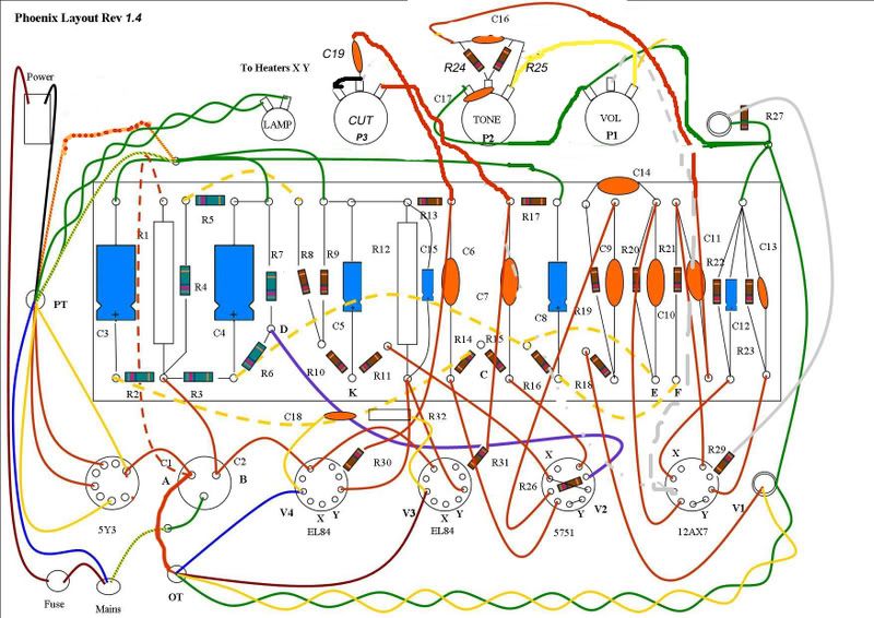

So i scrapped my matchless ao-43 clone and have decided to go with a Dr Z Carmen Ghia/Hammond ao-35 clone.  I am using the Phoenix schematic and layout diagram but have a question about a few values.  Mainly the 500/10 watt and the 130/10 watt cement resistors.  Are those 500k and 300k respectively?  Also, does my spreadsheet match up with what y'all are seeing?

They look like 500 ohms, and 150 ohms in the schematic. Definitely not 500k or 300k, which would be way too high.
Re: Carmen Ghia clone value questions
« Reply #2 on: February 24, 2017, 06:18:31 pm »
They have to pass a lot of current, with low voltage drop. Yes, 500 and 130 make sense.
But "standard values" have changed over the years. 500 and 130 may be hard to find.
470 is close-enough to 500, and may be easier to find.
The 130 cathode bias is somewhat critical. Either 125 or 150 will work. Or two 270 Ohm 2 Watt in parallel. (10W was over-size.)

I don't know what is changed and why, but here there is a 1.4 version

I'm not sure, but I think the 1.4 version is relative to this schematic (there is a CUT control)

I know this is an old thread, but I built one of these clones a year ago, and I've never seen the schematic with the cut control. What does it do?

there the cut control is present to ....... tame high frequency (or a Treble control if you want)

I've been trying to get this thing running for the better part of three days now. I've traced over the board and schematic, checked all ground connections and for cold solders/shorts; all multiple times. In the process I did manage to find a few forgotten connections which have since been fixed. I used a lightbulb limiter and variac for extra precaution with a dummy load or 8 ohm speaker always on the output. I also have a scope on standby. A few things that I can't manage to figure out.
1. With only the 5Y3 and preamp tubes plugged in the cathode Voltage on V1a/b is sitting at 150V and the Plate Voltage is sitting at 300V (Variac @ 50%). According to the notes in the Botany Bay Schematic the values should be 1.40ish V & 160ish V respectively
2. Absolutely no signal makes it through to the plate of V1a thus, the rest of the amp
3. With all tubes in a loud 60hz buzz creeps up as the tubes warm - this oddly disappears when the power tubes are switched from their sockets. ie same tubes but switched
4. With a limited probe with the scope the tone knob seemed to amplify a sine wave (maybe 60hz) when turned up. (dummy load was connected during this test)
5.Power tube Cathodes sit at 800mV (Variac 50%) -it should be 10.4V according to schematic.

About your grounds... All the grounds must connect to chassis. However, the preamp grounds will connect to chassis somewhere near the input jack. And the OT/power grounds must connect to chassis near the power transformer. You should read zero resistance between the preamp grounds and the OT/power grounds. This resistance is being read through the chassis itself.
Your voltage readings will only be valid if the amp is connected directly to the wall convenience outlet. You can use your variac if you set it to 120VAC output, but... DO NOT USE THE LIGHT BULB LIMITER (LBL) WHEN MEASURING VOLTAGES! If the LBL did not glow very brightly when you had all tubes in the amp, then it's job is done. Put it under the workbench.
This sounds like V1 cathodes are not connected to ground. This would be the case if you have the OT/power grounds isolated from chassis. You must have zero ohms resistance between the bottom side of V1 cathode resistors (re. schematic) and the PT center tap. If not, find out why.
Either set the variac for 120VAC output or plug the amp directly into the wall. When set to 50%, the variac  voltage may be so low that the tube heaters ane barely (if at all) heating.
Once again... PLUG THE AMP DIRECTLY INTO THE WALL TO MEASURE VOLTAGES! Otherwise, your voltages will never match your schematic.

Just wanted to say it was 100% that Signal and Power ground were not connected. I now have a working amp, albeit a little bit of loud hum when above 1 o’clock but still  very satisfying to complete this build; thank you for getting me passed the finish line.
