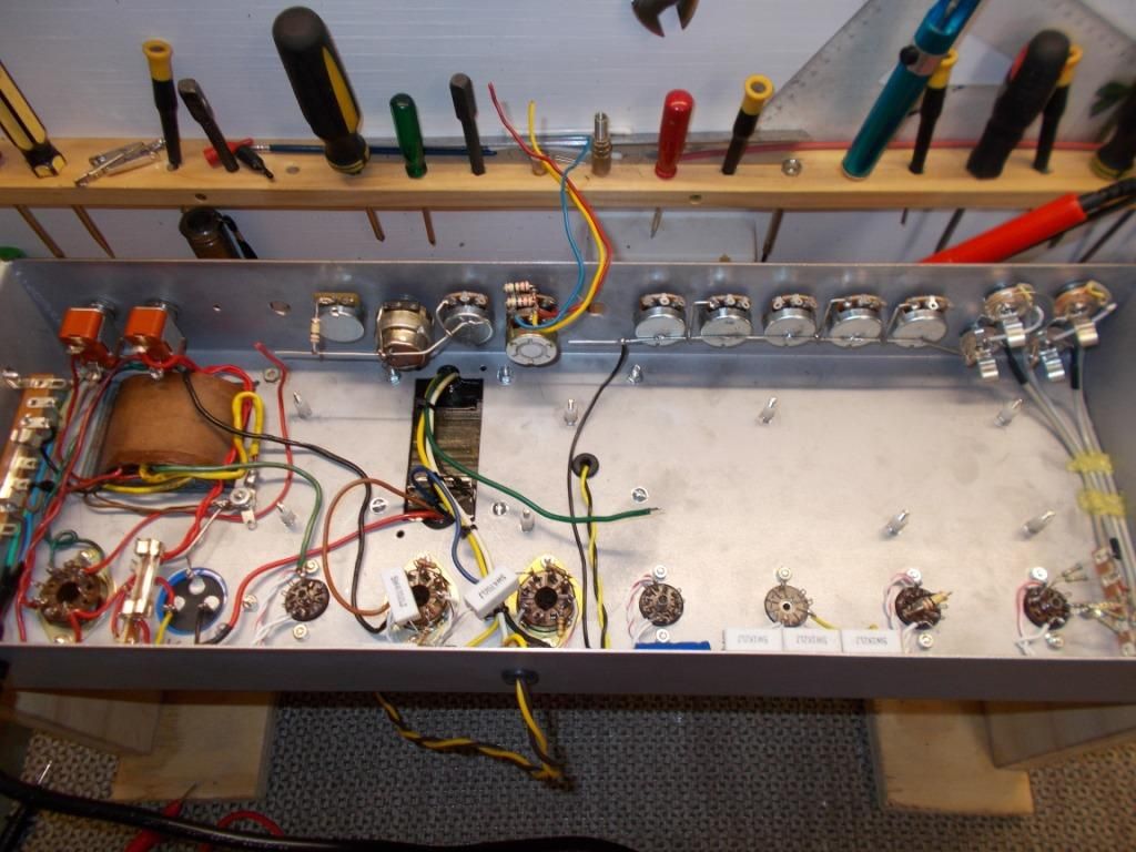

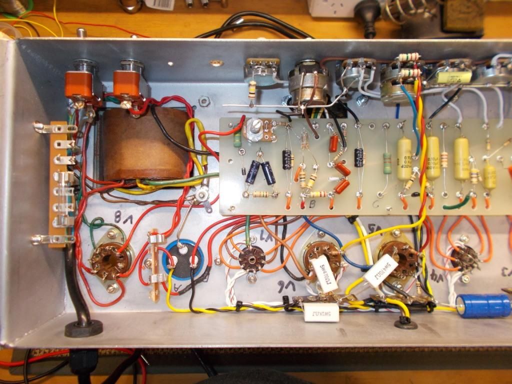

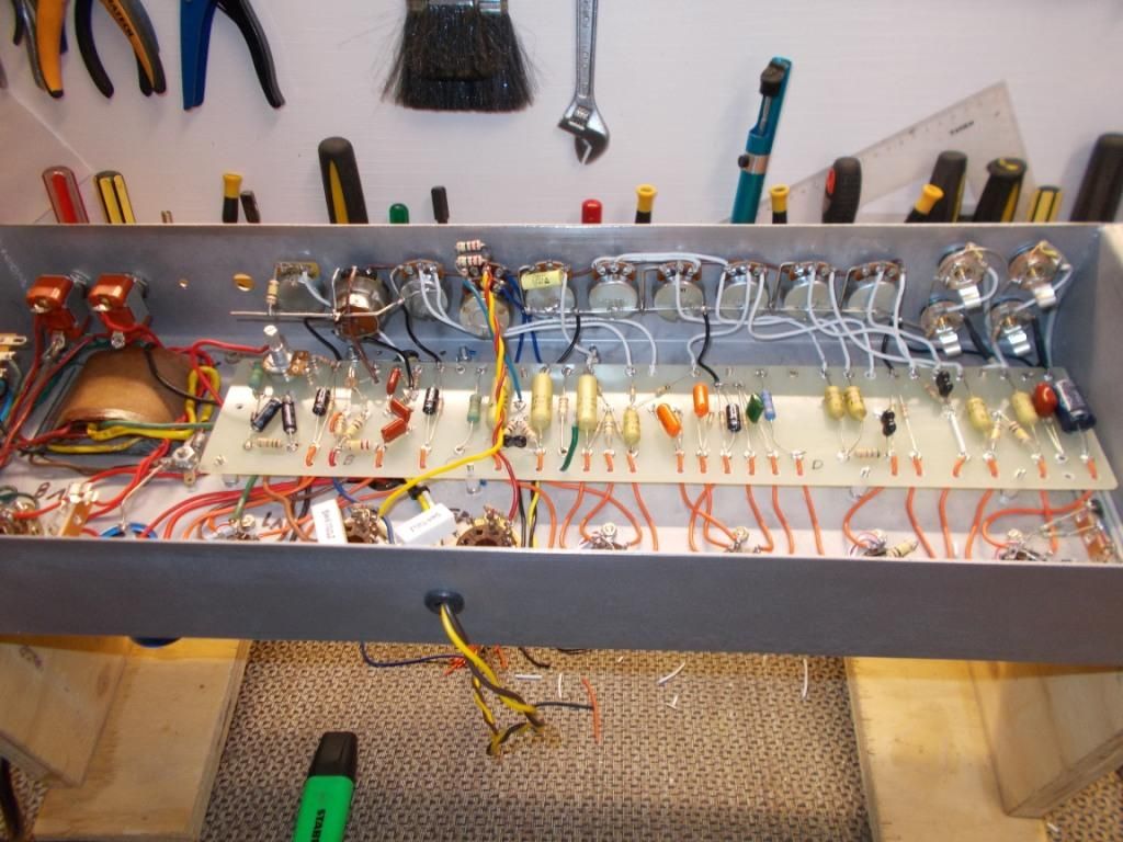

Hi guys, some progress pics..........

« Reply #8 on: April 30, 2017, 04:54:22 pm »
A couple more components to be added and hopefully some sounds later.
