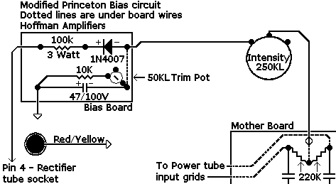

Next question:
I've seen a bunch of different stuff on how to add a bias pot into this circuit... enough to confuse me as to what I should really do.
Looking at the article here on EL34, I see this specific bias circuit being discussed, and it makes sense me what is going on in that article w/ the last setup:
My question is that the trim pot I have doesn't have a 'back' leg, it has three legs off of the front:
With this pot, I'm unsure what does what, so I'm not sure where each thing should be connected... the single side lug to the end of the cap, and the left side of the two leg side to the resistor?

Re: Build a Princeton into a Blues Jr Chassis?
« Reply #28 on: November 29, 2018, 09:26:34 am »
The inside of your pot looks something like this:
Image result for trimpot datasheet
The outer lugs are across the total resistance. The center lug is the wiper which changes resistance as you turn the "knob". Hook up a meter and see what you get if in doubt.
« Last Edit: November 29, 2018, 09:46:46 am by Sonny ReVerb »

The 'back leg' is your center leg (wiper). They just take it out the other side. I would say outer lug connected to the 10k and center lug connected to the cap.

So... what I had originally done was this:
And I'm thinking it's functionally equivalent to the Hoffman version above, and I'm wondering if there would be any benefit in changing my version to match the Hoffman version?

Well, to be safe I wired it as per the Hoffman diagram... but something seems off, as I'm getting 65mV on pin 8 (1 ohm, 1 watt to ground), and adjusting the bias pot does nothing except introduce a TON of noise unless I have it fully off - the bias value doesn't change when adjusted.
I've got 336v on pin3, so I figure I want 29 or 30mV on 5, yeah?
I've got the back side (single lug side of the pot) going to the connection of the bus wire and 10k resistor.  I've got the left lug going to the end of the 47/100 capacitor:
Am I missing something?
  • Posts: 5394
« Reply #33 on: November 30, 2018, 05:07:52 pm »
No you didn't. Compare your actual wiring to Hoffman's diagram and you will see some big errors.
Offline BobL
  • Posts: 247
« Reply #34 on: November 30, 2018, 05:28:08 pm »
Yep. That took me a minute.  This was the result of trying to change it back from the previous way I had it and not noticing the location switch on the resistor/cap. A bit embarassed over here...
Will the differing value of my cap be an issue?  I've seen several designs that have this as a 100uF and not 47uf, and my actual electronics knowledge is poor enough that I'm not entirely sure what affect this would have - from what I understand, the value I need to worry about changing w/ the pot to adjust the bias is the value of the resistor, yeah?
  • Posts: 11604
« Reply #35 on: November 30, 2018, 05:42:31 pm »
since you're unsure, I'd recommend pulling the PA tubes til you have the pot adjustable.  You can monitor it at the grid pin, guessing there should be a range of 10 - 20vdc Negative.  the cap size won't be an issue, unless it's wired backward  :icon_biggrin:
